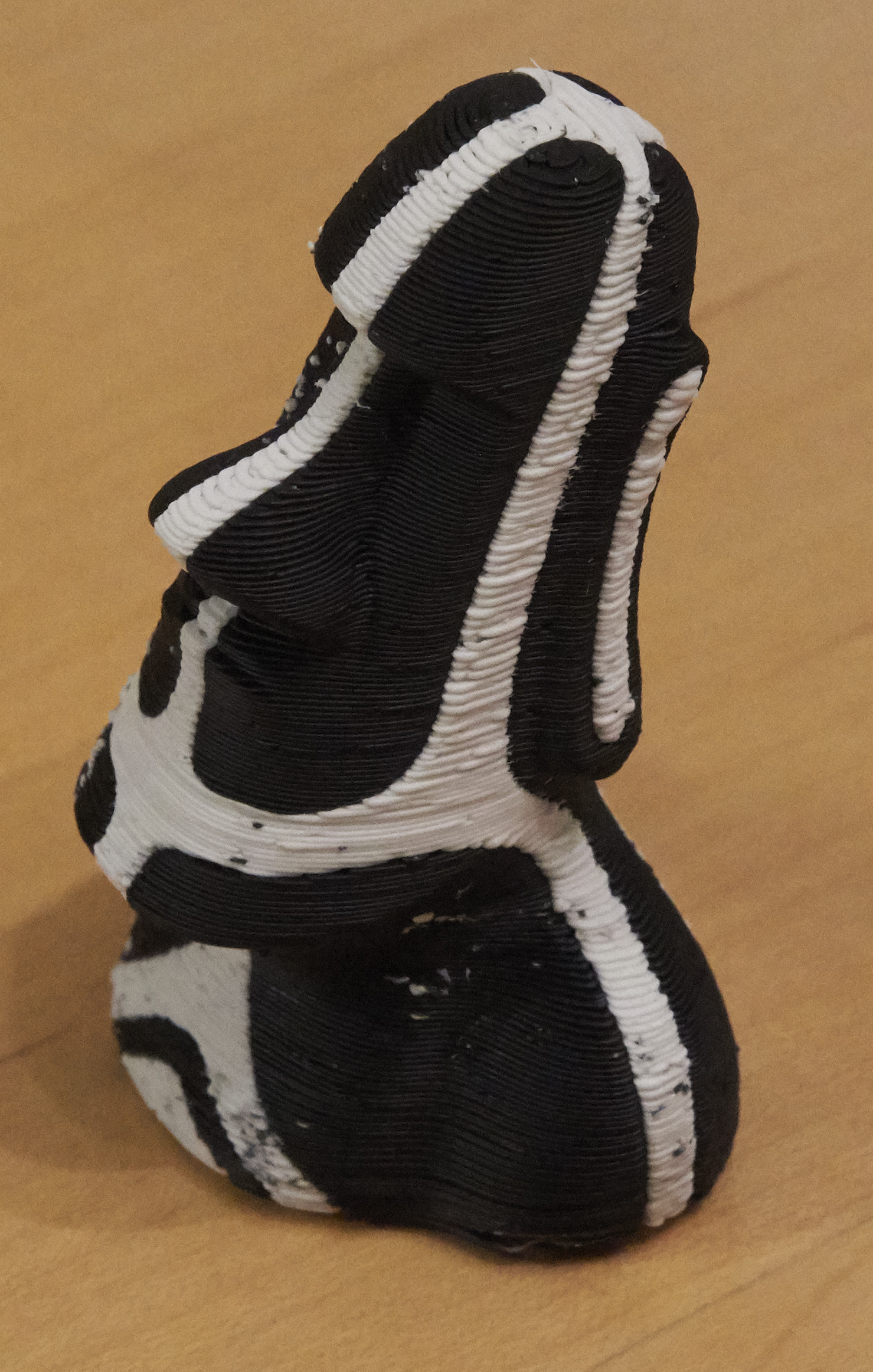

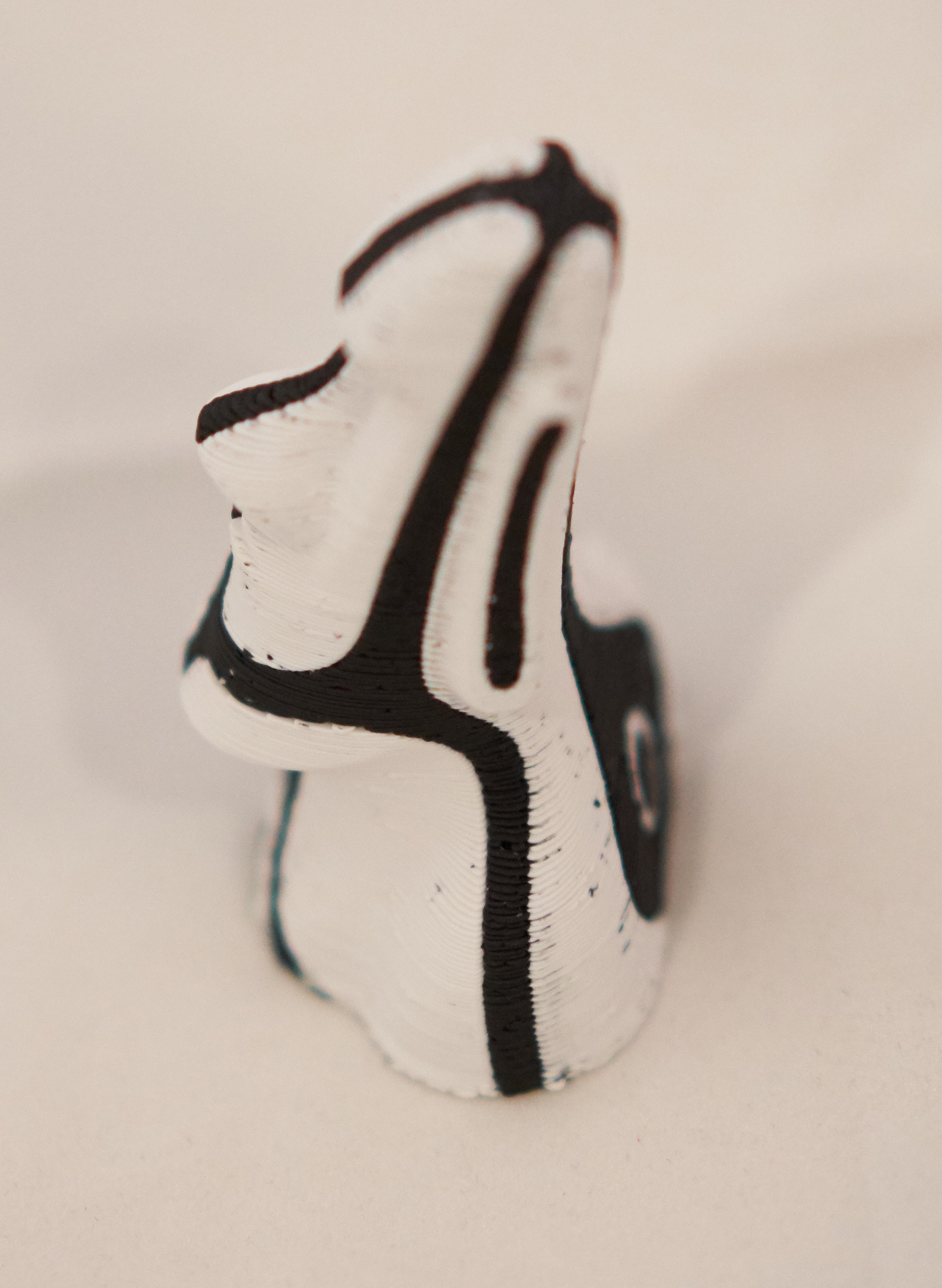

**Post date:** [December 31, 2017, 7:28am UTC](https://forum.lulzbot.com/t/dual-extruder-v3-looks-promising/5437/13 "2017-12-31T07:28:51Z")
Got my x-carriage issue sorted out. Here’s the dual extrusion Moai.
 ![KCC00098.jpg](https://us1.discourse-cdn.com/flex020/uploads/lulzbot/original/2X/2/268dc2aac1b5e718575548f0977482a177adf561.jpeg)
 ![KCC00100.jpg](https://us1.discourse-cdn.com/flex020/uploads/lulzbot/original/2X/b/bf3d228ec6071774287c4980ea9df599577d4a39.jpeg)
Put the black in T0 (left) and white in T1 (right). Adjusted the retraction to 1.1mm, seems to help the T0 nozzle ooze on the left side… but also used a ooze shield this time. So hard to say which helped more.
Overall pretty good. Black and white contrast a lot… but the black filament seems to extrude better.

**Post date:** [January 4, 2018, 2:37am UTC](https://forum.lulzbot.com/t/dual-extruder-v3-looks-promising/5437/14 "2018-01-04T02:37:47Z")
Print looks pretty good. Is this with the latest FW from Cura .63? Any glitches that needed a workaround?
Im curious if this unit works with 1.75mm filament as well as the other tool heads do. Might limit oozing problems?
**Post date:** [January 4, 2018, 5:39am UTC](https://forum.lulzbot.com/t/dual-extruder-v3-looks-promising/5437/15 "2018-01-04T05:39:02Z")
Yeah, the prints are coming out nicely.
I’m actually using 1.1.5.44 or .54 whichever is the default when flashing through Cura. No issues… I slice with S3D and print with Octoprint, and its a TAZ 5 so no wipe or autolevel.
I haven’t tried with 1.75mm.
