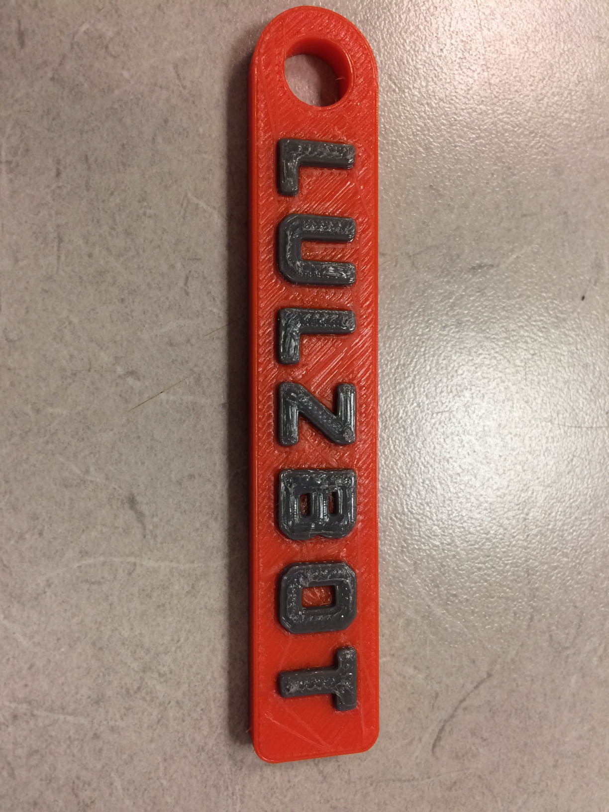

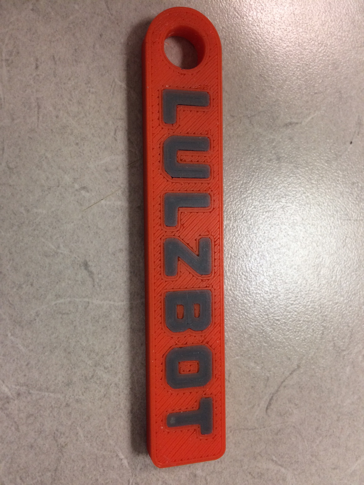

Just letting people know I posted a design for a dual extruder based on the flexion extruders. I intend to use it for all combinations of flexible and inflexible materials.
Its working really well. The very first print is attached after setting the e-steps and calibration cubes
I used orange Ninjaflex and E3D Edge as they were the only 1.75mm materials I had on hand.

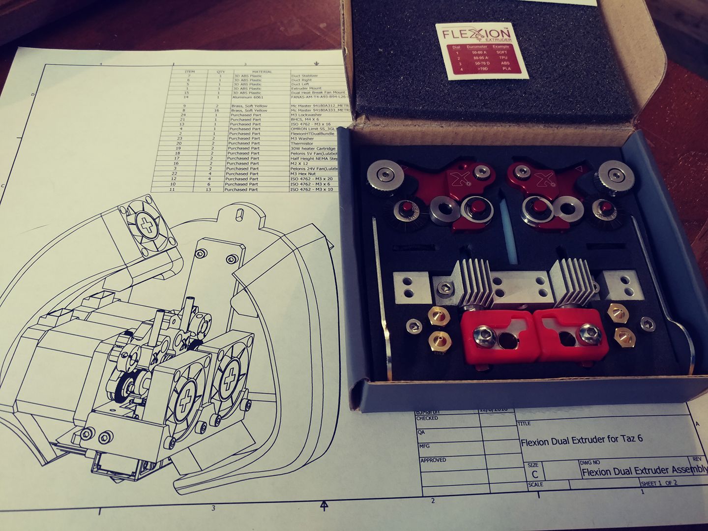

I ordered the Dual HT.

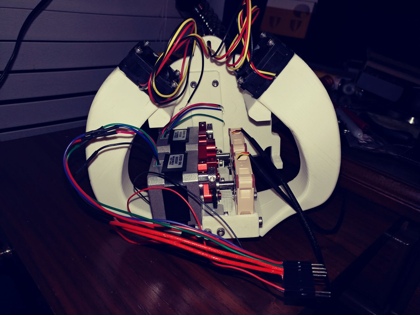

 ![Flexion.jpg](https://us1.discourse-cdn.com/flex020/uploads/lulzbot/original/2X/3/3dfdd27f889df5014d521b9353a81cedb80d2cc8.jpeg)
I am still waiting on the bracket from Misumi. I am not impressed by that company. Overpriced, slow, non-responsive and overpriced shipping.
I’ve printed out all of the parts and installed heat-serts.

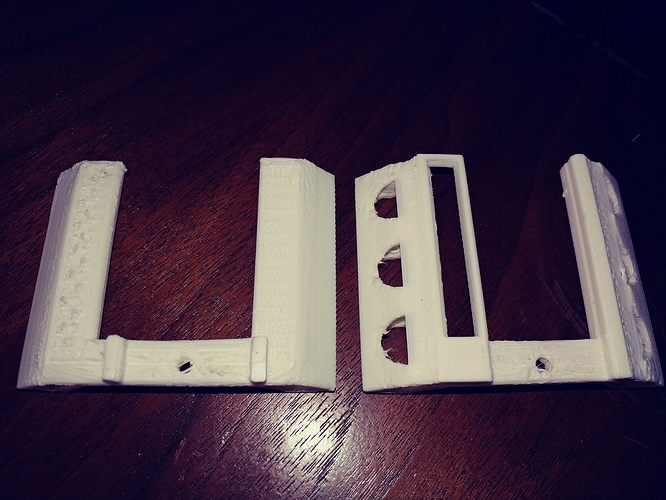

 ![Stabilizer.jpg](https://us1.discourse-cdn.com/flex020/uploads/lulzbot/original/2X/9/953f103ba84c4a0bf2f56c18ce39ddea6c572b98.jpeg)
I should be getting the hardware from McMaster tonight so I printed out the L-Bracket (as you can see in the second picture) and I am going to pre-assemble it. The L-Bracket from Misumi won’t ship till at least Thursday the 16th.
Something of note for those following the build, as you can see in the picture of my 3D printed L-Bracket, I drilled the 11.5mm holes on the to the left of the holes, I have since reprinted and corrected. for those following this thread, this is important before you drill into your $50 bracket.

 ![Dry Fit.jpg](https://us1.discourse-cdn.com/flex020/uploads/lulzbot/original/2X/c/cbdfa62c90be1489b406e1bf7d4569a47a0bd576.jpeg)

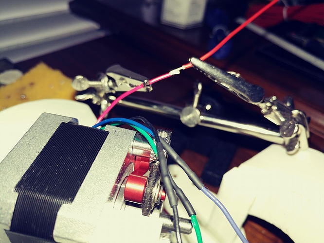

 ![Soldering Connector.jpg](https://us1.discourse-cdn.com/flex020/uploads/lulzbot/original/2X/d/d233d9123cb683dabcded0fdaf8b0ba55842f3ac.jpeg)
