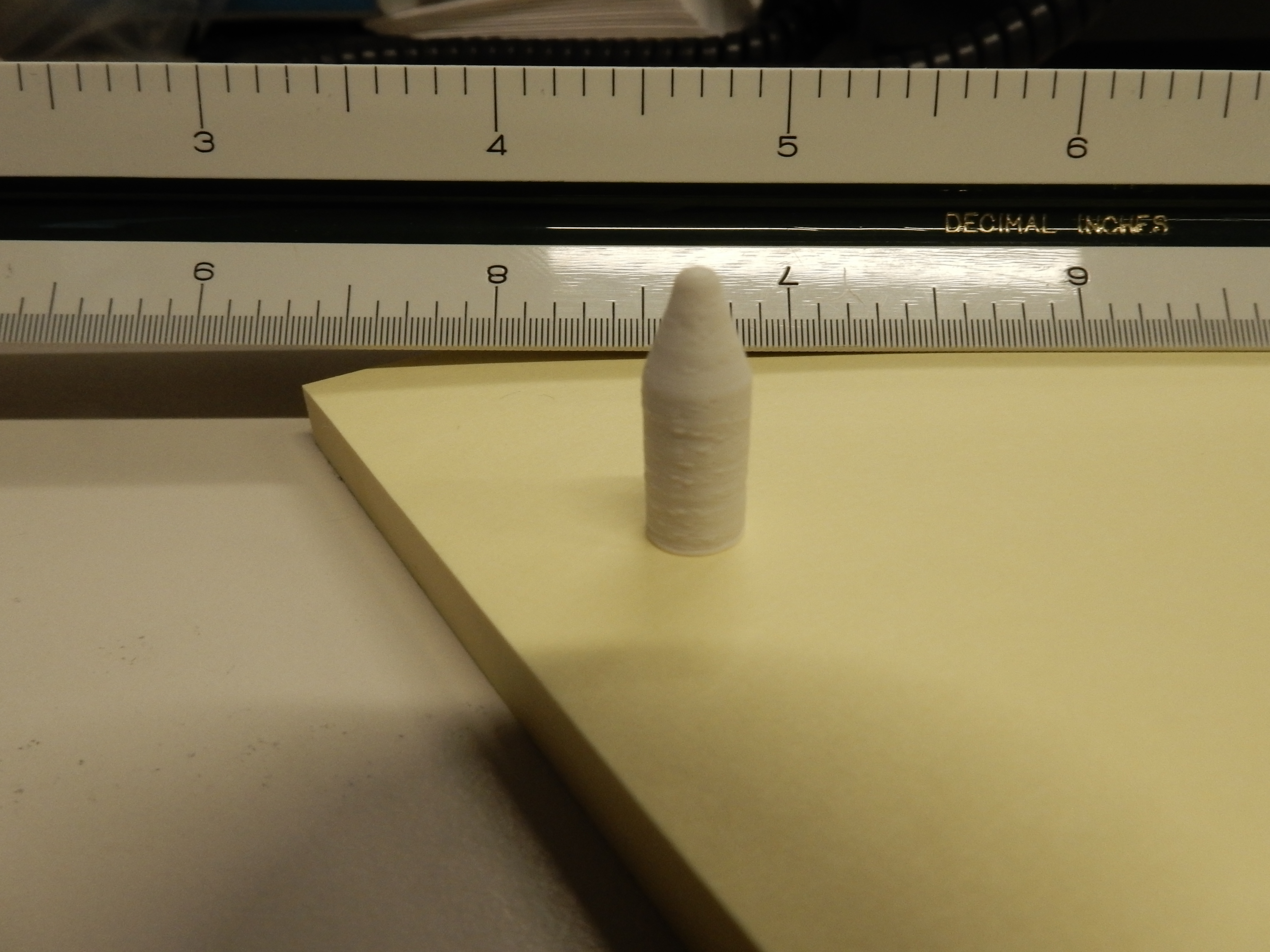

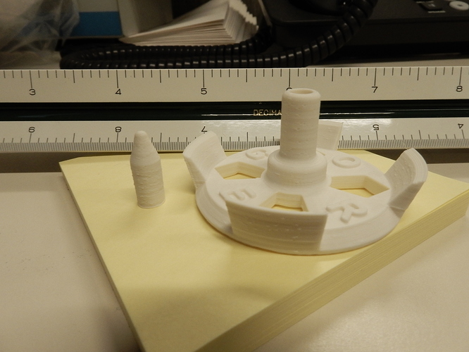

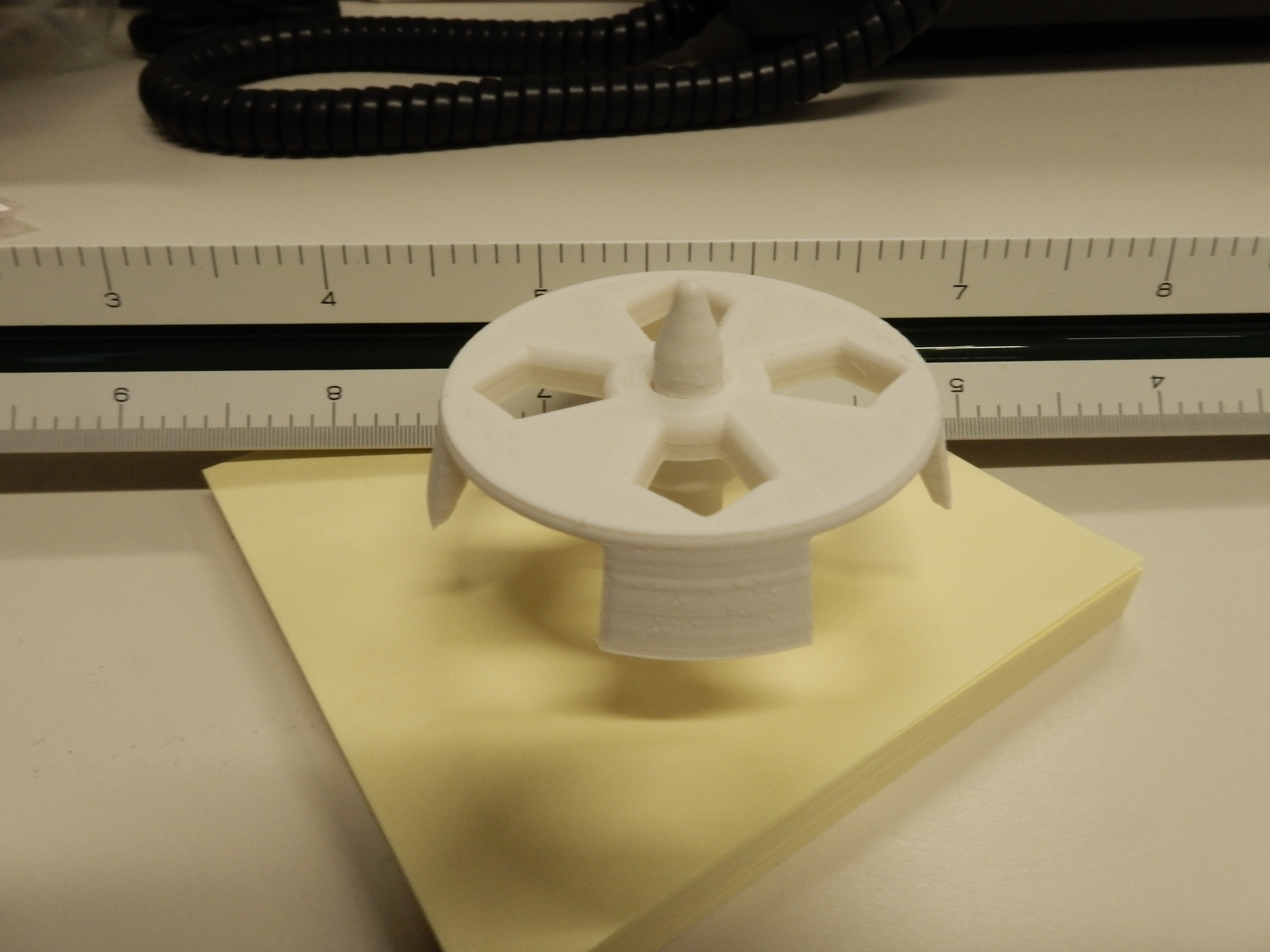

Spinning top - 2 pieces. Slic3r & Pronterface, ABS, lulzbot fine\_no support profile. Fully enclosed printer. TAZ4.
Fan on. Random seam position. Infill before perimeters. 5mm brim. Minimum print speed 10mm/s. 230c/95c
PET and Lulzjuice.
Extremely impressed with finish. Especially on the point. This thing spins like a boss. 😃

Spin it up! Use to do that back in the day 😉 Nice print edlink. What do the letters represent? Is the base a slab of MDF or a plastic print? Been a long time since I’ve seen a tri scale ruler.

The yellowish stuff is just a post-it note stack. White ABS doesn’t photograph very well. I need a darker background, but today I was in a hurry to get those pics taken so…
We’re having a “bring your kids to work” day in April, I was thinking of making these as swag for the kids.
Letters represent company I work for.
I’m a drafting and design guy. Thus the ruler.
