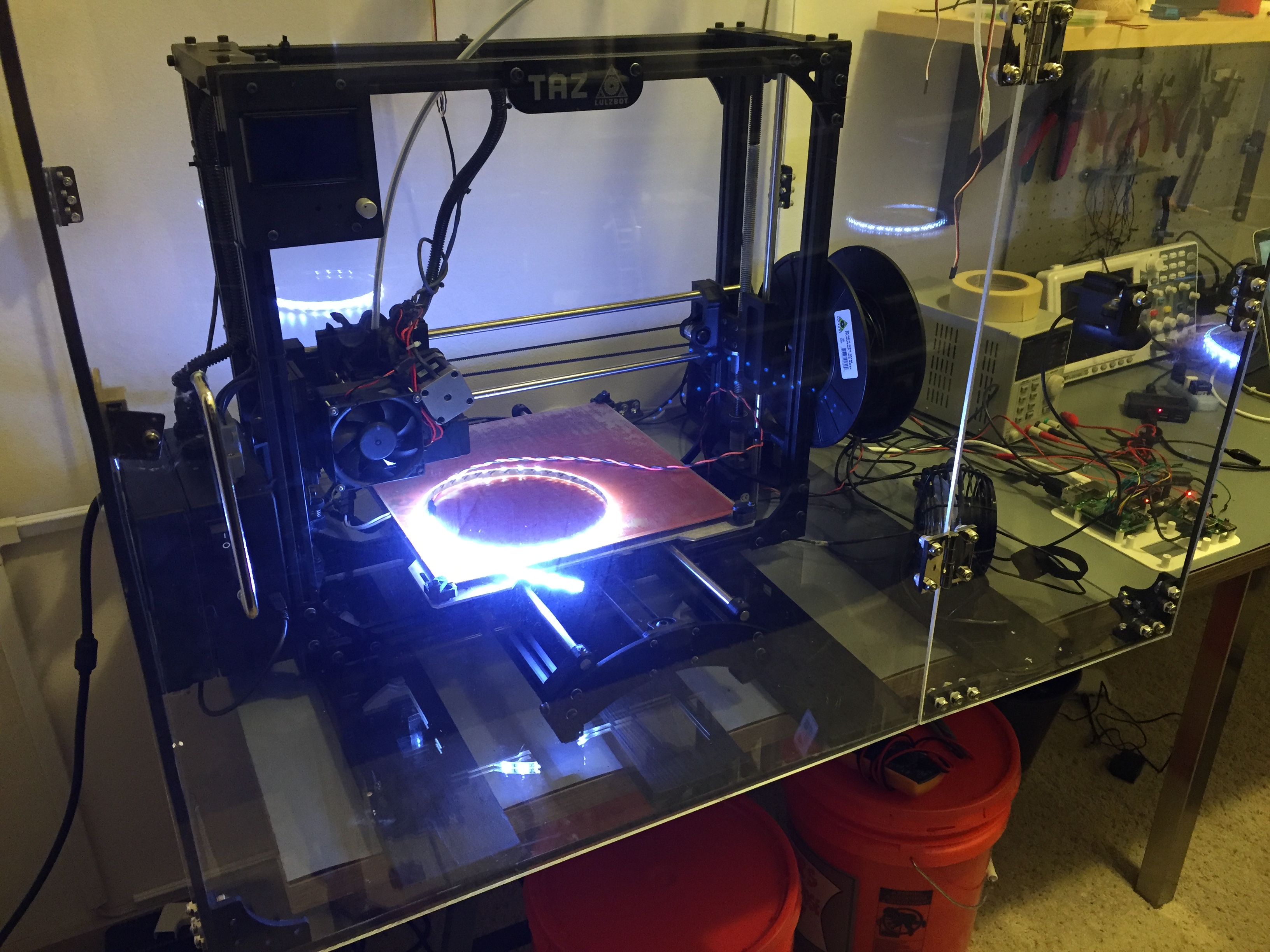

For the last week I’ve been working on a plugin for octoprint to control my enclosure.
My goal is to control a light, fans and a small heater inside the enclosure over the internet using octoprint.
I just finished the first version of the plugin.
You can find it on my github page.

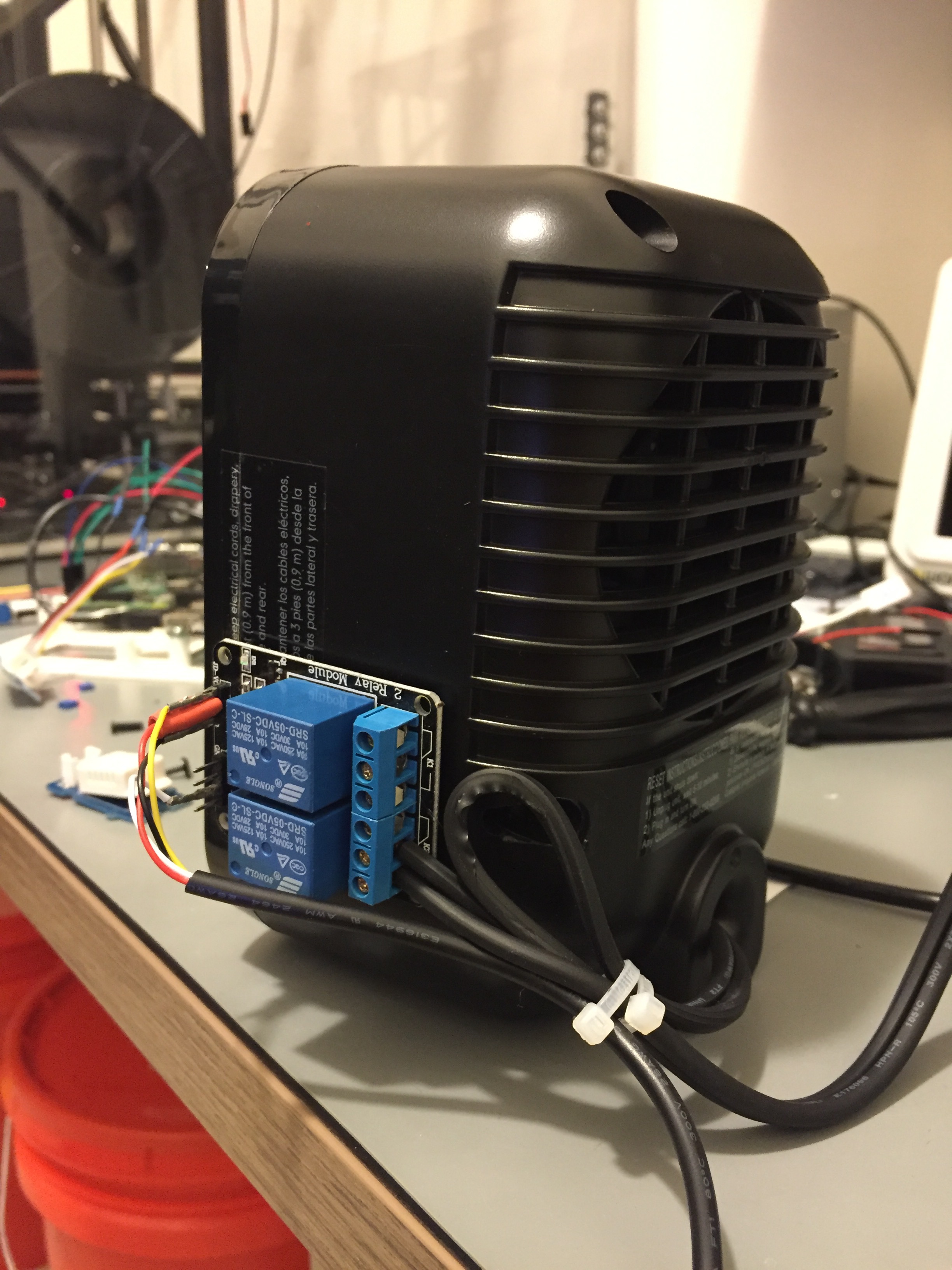

Basically I use the raspberry pi GPIO to control relays and turn on / off whatever I want on my enclosure. There is plenty information on the plugin page on github. For now the plugin only works on raspberry pi.
The heater should turn off when the print is complete. The lights are specially good when you want to check your print while you are not home over the internet.
I’m using a DHT22 sensor to measure temperature and humidity inside the enclosure, a small lasko heater and a usb fan.

Tested the heat stabilization yesterday and could keep my enclosure on a nice 40 C. It took 10 minutes to get to the temperature.
I just got OctoPrint running my Taz 5 remotely and am interested in building a similar enclosure with temperature & humidity control. I’m curious, how necessary is the additional heater? Have you found an optimum enclosure temp that is higher than what the heated build plate and nozzle put out?
If you build a enclosure, setting the hot bed to 110C and the hot end to 240C will only heat your enclosure to about 30C, due to thermal losses, etc…
With a heater and controlling the temperature, I can easily keep the internal temperature to 50C, this help a lot when printing LARGE ABS prints, where warping would be an issue, if you want to only print small ABS or PLA you don’t need a enclosure.

It only controls the heater, there is no need to turn the fan to decrease the temperature, there are plenty of heat losses on enclosure that will make the temperature drop really quick once the heater element is off inside the enclosure. Just turning off the heater makes the temperature control very stable.

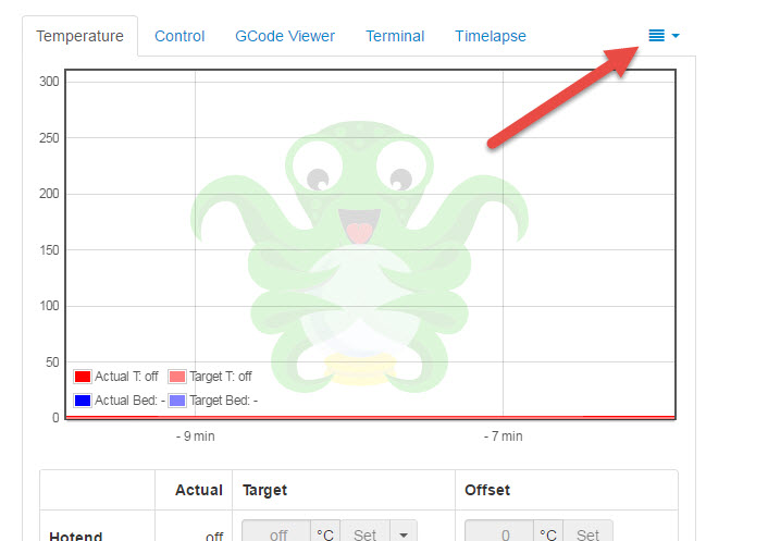

What I mean is that I have this button to show extra tabs and I dont like it.

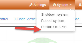

And I see in some other plugin, buttons for on/off in the system tab under restart option.
Well that is really not so important, I just ask if it is possible to have on/off buttons somewhere easly accessible.

I don’t like including buttons on the shutdown menu. It is possible to inject the html any part of the octoprint, I’ll test putting it on the control tab.
