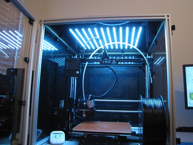

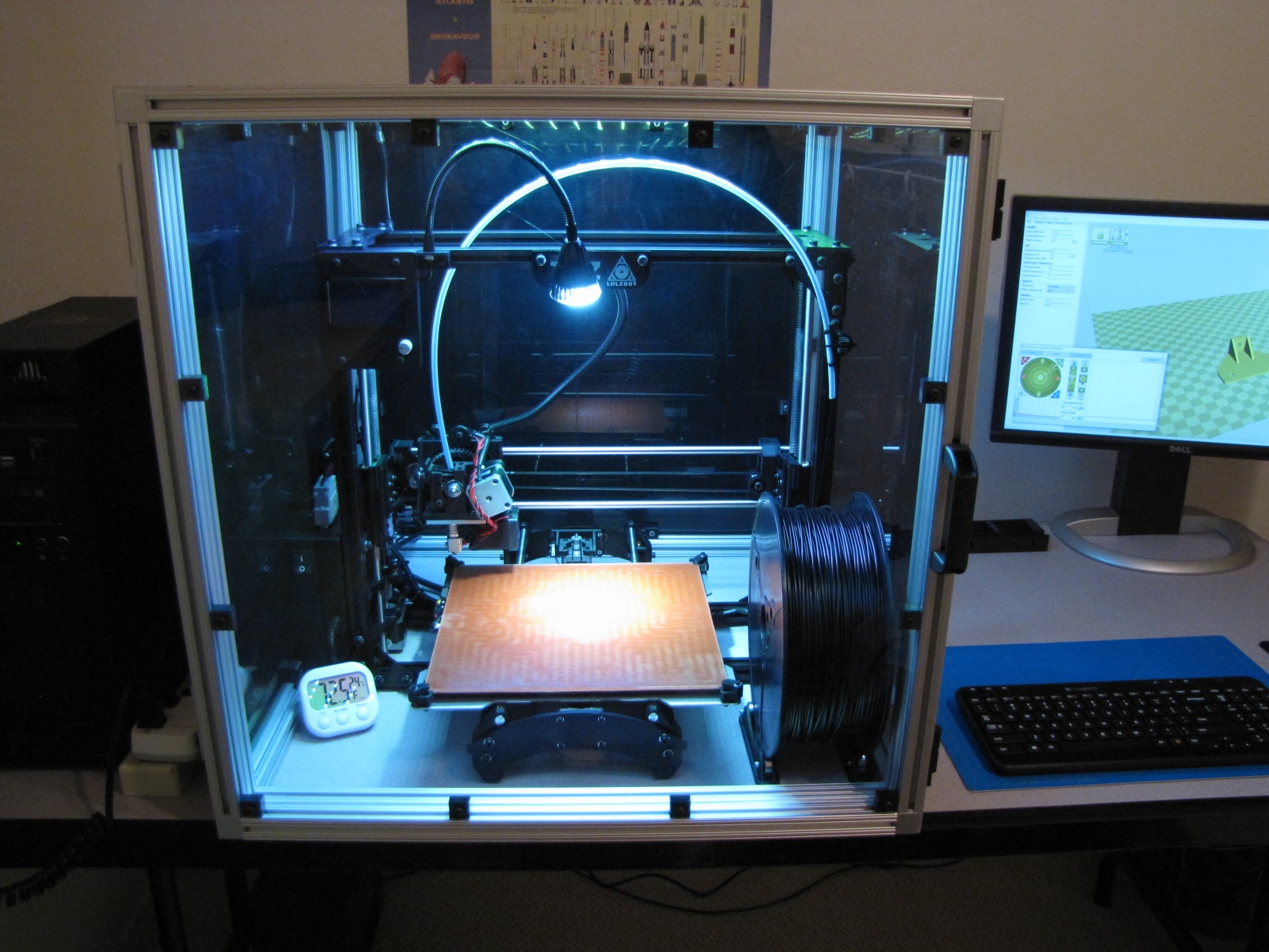

Here’s my variation on y8s’s enclosure design. I used one translucent side panel, one clear front panel, and the rest are black panels. The main improvements are the lighting and the use of lift-off style door hinges. The enclosure makes it much easier to successfully print ABS without having air drafts cause warping problems.
 ![overview.JPG](https://us1.discourse-cdn.com/flex020/uploads/lulzbot/original/2X/6/6c538b45129b834efbcd695493b50478b1665976.jpeg)
 ![front.JPG](https://us1.discourse-cdn.com/flex020/uploads/lulzbot/original/2X/4/4051a3a3182a7dcd2804b8469389e94b24a8ef8c.jpeg)
 ![translucent side.JPG](https://us1.discourse-cdn.com/flex020/uploads/lulzbot/original/2X/e/e6a58b0e233986a23374bcf111ad4d42f3f5e369.jpeg)
 ![door open.JPG](https://us1.discourse-cdn.com/flex020/uploads/lulzbot/original/2X/6/680ffb557eb65c7914b82a0780398ed5418a439b.jpeg)
 ![lighting.JPG](https://us1.discourse-cdn.com/flex020/uploads/lulzbot/original/2X/6/6a4ee3df3fe1a8c88eabd4239964205d84eabf0c.jpeg)
Here’s the BOM…
2 (McMaster) 1151A83 Surface-Mount Lift-Off Hinge with Holes; Left Hand, 304 Stainless Steel, 3" Leaf Height, 2" Width
4 (McMaster) 47065T242 External Connector, 1/4" Thread Size for 1" High Aluminum T-Slotted Framing Extrusion
8 (McMaster) 47065T244 3-Way External Connector, 1/4" Thread Size for 1" Aluminum T-Slotted Framing Extrusion
1 (McMaster) 47065T164 Handle for 1" High Aluminum T-Slotted Framing Extrusion
16 (McMaster) 47065T101 Aluminum T-Slotted Framing Extrusion; Single Profile, 1" Size, Solid, 2’ Long
1 (McMaster) pack (4) 47065T139 Compact End-Feed Fastener, 1/4"-20 Thread for Aluminum T-Slotted Framing Extrusion
2 (McMaster) packs (4) 47065T147 Dual End-Feed Fastener for 1" Single & 2" Quad Aluminum T-Slotted Framing Extrusion
1 (McMaster) box (50) 91255A269 Alloy Steel Button-Head Socket Cap Screw; Black-Oxide, 10-32 Thread, 3/4" Long
1 (McMaster) box (50) 91255A267 Black-Oxide, 10-32 Thread, 5/8" Long; Alloy Steel Button-Head Socket Cap Screw
1 (McMaster) pack (100) 90730A411 Type 18-8 Stainless Steel Narrow Hex Nut 10-32 Thread Size, 5/16" Wide, 7/64" High
1 (McMaster) pack (100) 96765A125 Black-Oxide 18-8 Stainless Steel Flat Washer Number 10 Screw Size, 0.203" ID, 0.438" OD
1 (McMaster) pack (25) 91255A522 Alloy Steel Button-Head Socket Cap Screw Black-Oxide, 1/4"-20 Thread, 5/16" Long
1 (McMaster) pack (4) 5537T161 Compact End-Feed Fastener, M5 Thread Size for Aluminum T-Slotted Framing Extrusion
1 (generic) .110" clear acrylic 2’x2’
1 (generic) .110" gray translucent acrylic 2’x2’
1 (generic) .250" black acrylic 2’x2’
2 (generic) black plastic panel 2’x2’
1 (eBay) LED Flexible Light Bed Table Desk Lamp 30cm Tube Style High Power 5W Goose Neck
1 (eBay) 3D Printer Filament Spool Holder Stand - Ball Bearing - Universal
1 (eBay) 5m Super Bright 12V 5630 SMD 300 Leds Lamp Flexible Strip
1 (eBay) 12V 4A 48W Power Supply AC to DC Adapter for Flexible LED Strip Light
1 (eBay) RF IR Wireless Remote Switch Controller Dimmer for LED Strip Light
4 (K&J Magnetics) D48-N52 1/4" dia. x 1/2" thick Nickel Plated Axially Magnetized
2 (Home Depot) weatherproofing strip
2 (custom printed) wire clips
1 (custom printed) stabilizer bracket
44 (custom printed) .110" panel brackets
12 (custom printed) .250" panel brackets
4 (custom printed) door magnet brackets
1 (custom printed) lamp bracket
The custom printed part files are attached.

Very interesting.
My Taz5 fit between the walls. I also tried to raise the control box with the same issue. I managed to get it to a point where it all squeezes in nicely.
I did have to cut an ugly hole and make a short duct though.
