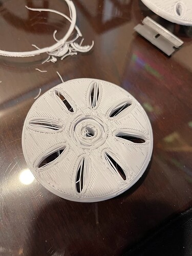

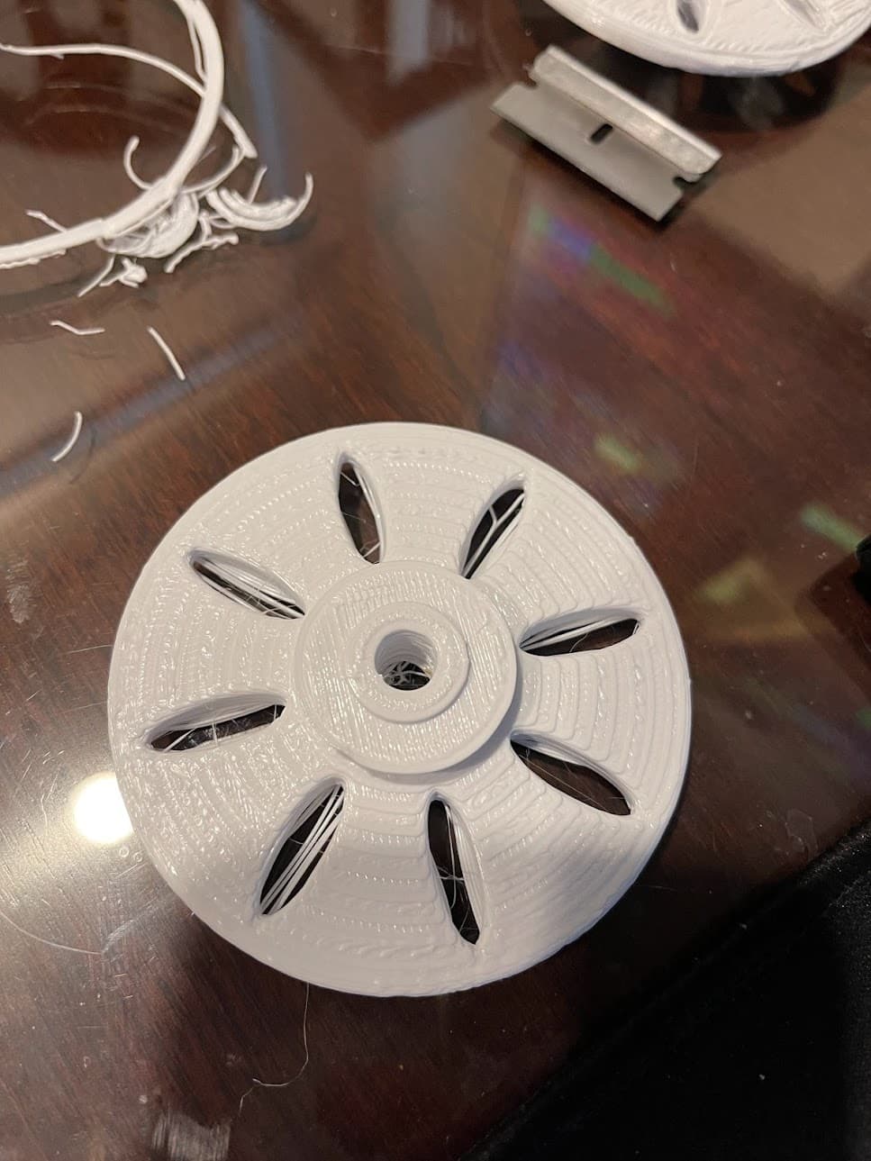

Here’s what I’m getting right now. The first image is the bottom of the print, the second is the top. The top is fine, the bottom is a mess. The bottom is also warped and sections peeled up from the bed. I tried using Dawn dish soap on the entire plate, and then scrubbing with IPA afterwards. It didn’t seem to make much difference. I don’t have a glue stick to try, but there was some on this printer when I got it (it was second hand) and nothing stuck to the gluestick either. Starting to run out of ideas. I tried print temps as high as 275 starting 265 printing and it just got stringier and didn’t stick. I’m already running -.85 z, I don’t know how much more I can go without potentially scraping the nozzle on the plate, I’m thinking maybe a couple more notches.

Edit: Is this my problem? Every video I can find of a TAZ printer the bed surface does not look like this:
 ![image](https://us1.discourse-cdn.com/flex020/uploads/lulzbot/original/2X/5/52b5c828dd2c4273839e68612a6079a2b08147ee.jpeg)
My bed is SUPER shiny and smooth, literally glass. Did someone remove the PEI or whatever is supposed to be on here? This printer is second hand.
Edit2: The printer included the magnetic OctoGrab plate in the box, but not the magnetic bed part. (I didn’t know what the extra plate was until I started Googling). I also ran a print with the Octograb plate just sitting on the bed I have, and the stuff stuck like I glued it on there. This is infuriating to me that I was this stupid and missed this. I would love confirmation, but I’m 99% the previous owner of this printer peeled the PEI layer off the glass bed, and this is why everything I print doesn’t want to stick…

Yeah, that glass is way too shiny to still have a PEI sheet on it. Apply a new PEI sheet and you should get much better results.
