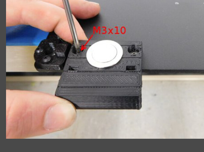

**Post date:** [April 25, 2024, 3:05pm UTC](https://forum.lulzbot.com/t/extruder-pushing-too-far-into-contact-sensor/26594/2 "2024-04-25T15:05:33Z")
Video of the failure would help a lot, if you can record and post to youtube.
By sensor are you referring to the washer at the corner, or the Z minimum button?
 ![image](https://us1.discourse-cdn.com/flex020/uploads/lulzbot/original/2X/8/8ae293d6da88d72b2f9a20865f5d5d577ee4625e.jpeg)
If it’s the button, the usual problem is that you have the wrong toolhead selected, so the nozzle is hitting off-center and not triggering. If it is hitting centered and not stopping, there is likely a break or disconnect in the wire from the button, or the switch has failed or is no longer mounted correctly.
If it’s the washers at the corners, the usual problem is a very dirty nozzle, or again, a break in the wire from the bed.

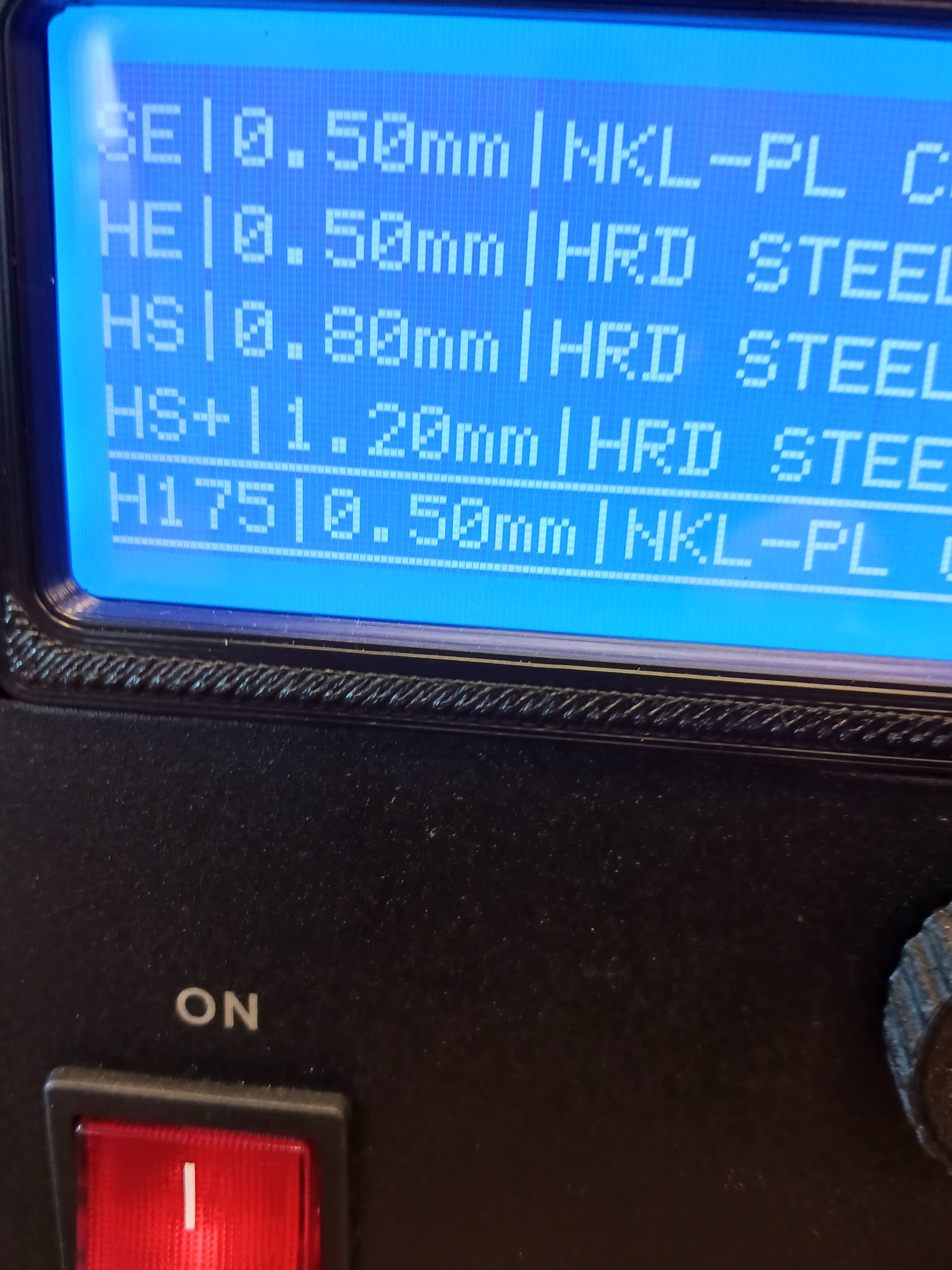

**Post date:** [May 1, 2024, 5:16pm UTC](https://forum.lulzbot.com/t/extruder-pushing-too-far-into-contact-sensor/26594/14 "2024-05-01T17:16:40Z")
If you’re running the latest firmware (2.x universal), there will be a toolhead menu on the printer itself.
There’s plenty of different toolheads, so take a picture of yours so we can be sure it’s the right one.

**Post date:** [May 1, 2024, 7:23pm UTC](https://forum.lulzbot.com/t/extruder-pushing-too-far-into-contact-sensor/26594/15 "2024-05-01T19:23:14Z")
I usually select just the Standard Toolhead
 ![Taz 6 Toolhead Settings 1 - Standrd](https://us1.discourse-cdn.com/flex020/uploads/lulzbot/original/2X/b/b47f79df46e830937aa2133810fda94251db081d.jpeg)
(1st one listed) but perhaps I’m choosing unwisely?
 ![Taz 5 Toolhead Settings 2](https://us1.discourse-cdn.com/flex020/uploads/lulzbot/original/2X/d/db3d307e794e6e4f949ecfc984daa974312cf8bb.jpeg)
**Post date:** [May 1, 2024, 7:49pm UTC](https://forum.lulzbot.com/t/extruder-pushing-too-far-into-contact-sensor/26594/16 "2024-05-01T19:49:44Z")
Without the requested picture of your toolhead, I don’t know if that’s the correct one.
