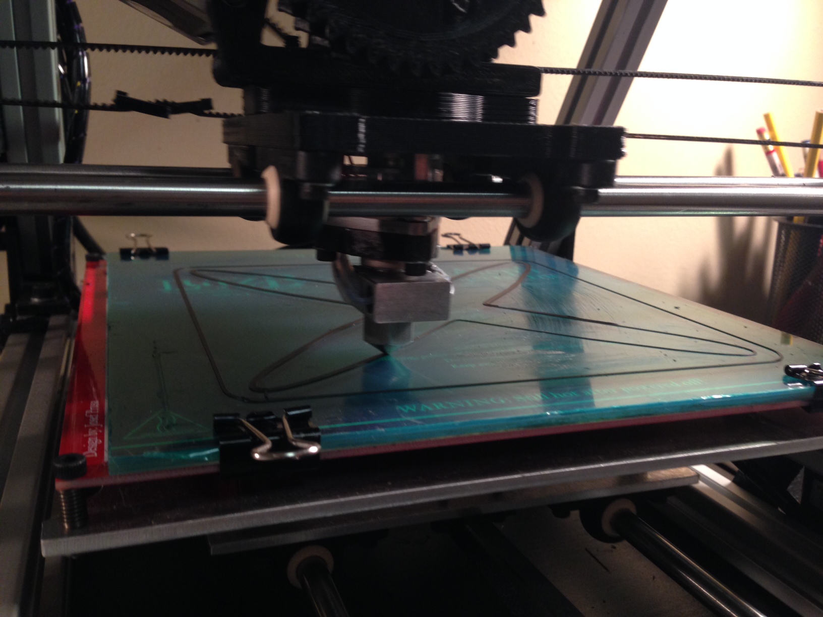

Well now I did it… I messed up the nozzle. I tried to take off the nozzle without heating it up and I ended up stripping out the threads on the shaft. I think the nozzle is still salvageable.
I am very frustrated with myself because this now mean I won’t be able to print for another weekend!!!
Does anyone have any suggestions on how to get the PEEK insulator off with out ruining it?
Also I found the original problem I think. The nozzle was not fully seated on the threaded rod…

**Post date:** [January 13, 2014, 4:43am UTC](https://forum.lulzbot.com/t/extruder-struggling/413/14 "2014-01-13T04:43:34Z")
Success (or at least from the moment). Today I made the long drive out to Deezmakers in Pasadena CA. They were able to hook me up with some spare parts and gave me some good advice.
Lessons Learned
1. MAKE SURE THE NOZZLE IS ALL THE WAY ON!!!
2. Use some anti-seize when you take your nozzle off.
3. Nozzles are not meant to be taken on and off frequently
4. Listen to others advice (Like Orias - would have saved me several hours and about 60 bucks)
5. Patience. I tried to rush a couple things and it ended up costing me time and money.
Well I am happy to be back up and printing…
