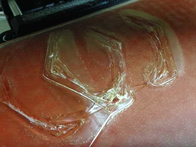

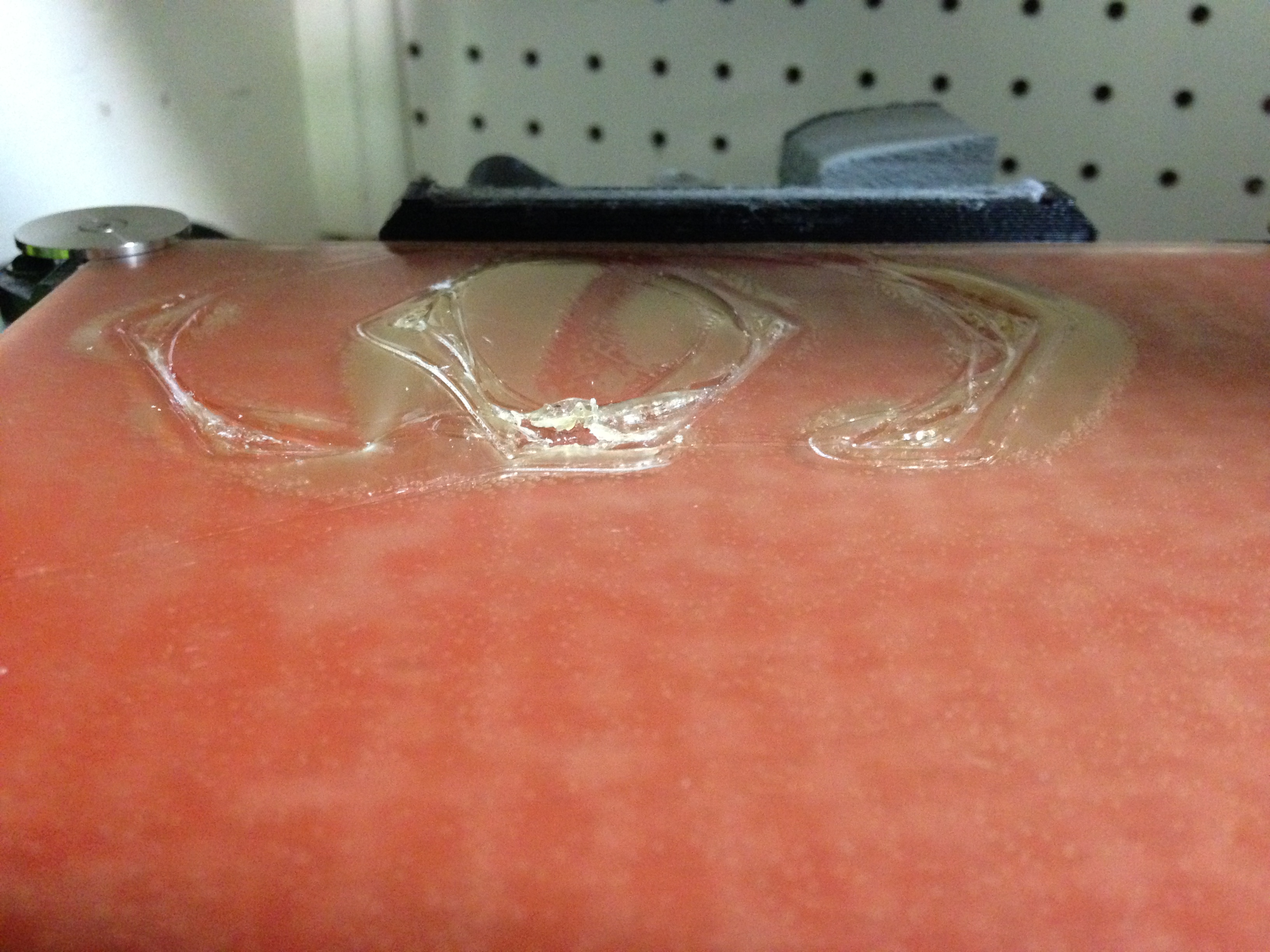

Instead of the rocktopus 1st print I loaded a different STL model and tried to print. The spool wasn’t turning as the head moved over the bed, but I saw the bed starting to bubble. Here are some pictures below. Does anyone know what may of happened? Thanks ahead of time.

Your going to want to call support on that one. It looks like your auto leveling failed catastrophically.

I’m with Piercet on this one. My bet is that your nozzle or one or more of the washers on the corners of the bed had some crud on them, preventing electrical contact between the nozzle and the washer, throwing off the auto-level. Your nozzle probably came down too low as a result and made contact with the print bed. (Same thing happened to the elementary class I was working with when they tried their first print, though their melt-down was not as bad.)
It’s an easy fix. It’s unlikely the borosilicate glass bed was damaged. It’s just a matter of removing the old PEI sheet, cleaning the glass thoroughly, and installing a new sheet.

The filament is the green HIPS piece that comes standard with the unit, the temperature entered was 240 as mentioned in the instruction manual. But during the run no filament came out during the print (I did verify extrusion using Extrude 10 a couple of times like the manual said). Something didn’t look right when it was doing its first auto-leveling out of the box, it looked like it bumped into one of the four corners and it also made very loud sounds. I’ll call tech support. I’ll see where to get more of those PEI sheets. Thanks!

Call support. Your bed leveling failed. They will send you a new pei/glass/heating element assembly under warranty and you can swap it out in less than 10 minutes.
