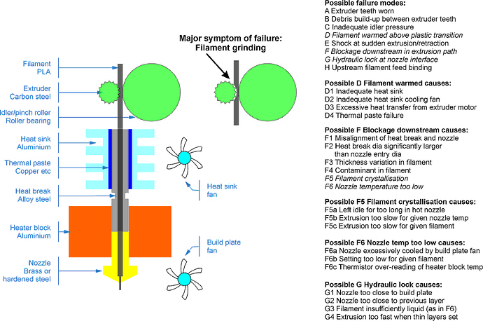

Failure mode analysis for extruder grinding
Would appreciate your experience and intelligence in adding to my list of the possible causes of extruder grinding my Mini 1.03 filament. Not ready yet for your suggestions on how to fix it (smile)! Just seeking areas to investigate that I haven’t thought of. Here is my list so far, your additions most welcome, thanks!
