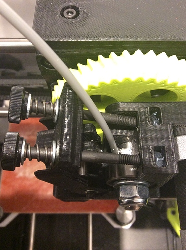

We have a mini we got for our high school student about a year ago, never had any issues with it. Just this week it stopped feeding filament – pictures attached.
I’m not sure how to diagnose, where to go from here. I tried adjusting the tension on the filament feeder, as well as changing the retraction speed. Nothing seems to matter, and nothing but a small dribble will ever come out of the hot end. Mostly it will just spin like its trying to retract, but never actually pull anything in, and after awhile digs mostly through the filament. The skate bearing there seems to move freely, and ive taken a small brush and cleaned out the feeding bolt grooves, all to no avail.
This is with ABS plastic, and I’ve tried a few spools - doesnt seem to make a difference. Also tried heating it hotter than normal with no success.
Any suggestions would be greatly appreciated, I don’t know what to try next to get this fixed?

Check that the tiny “blower” fan is running (the tiny fan pointed at the aluminum fins above the nozzle and heat block). If this fan fails or ingests something that stops it from spinning, the filament softens too high in the path and will kink/buckle which prevents extrusion.
The nozzle may be clogged. Has PLA also been in use? If so, that increases the possibility of a clog – since PLA can carbonize at higher temperatures and cause a nasty clog. Do some searches on how to do a “cold pull”, which is a way to clean the nozzle of minor clogs without disassembly. If it is a major clog, it may require disassembly or nozzle replacement.
It is also possible the thermistor is bad, saying the nozzle is hot enough to extrude when it really isn’t. That can be tested with a multimeter, by disconnecting the extruder and checking resistance on pins 17-18 (small red and black wires – see diagram for steps #5 and #6 at [https://ohai.lulzbot.com/project/86797b55-7d08-4c6d-be77-3c116a320547/mini/](https://ohai.lulzbot.com/project/86797b55-7d08-4c6d-be77-3c116a320547/mini/). Resistance should measure approximately 100k Ohms.
Regarding tension, the washers should be about 7-8mm apart when filament is loaded and the idler is closed.
