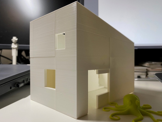

Been working on a series of prints and latest pieces are starting and then the filament stops flowing. I’m printing with Polylite PLA and had sucess on the prints just a few days ago. I then started to have prints fail/ filament discontinue to flow as the head continued to move through the Path. Started to suspect heat creep, but this happens at various time sometime early sometimes later in the print. As a test I printed out the Benchy and it made it through just fine. Any Ideas for troubleshooting this would be appreciated. Thanks.
 ![Benchy](https://us1.discourse-cdn.com/flex020/uploads/lulzbot/original/2X/1/138fc126c36e536150a84791caf96b5cf9e2885e.jpeg) ![misfire](https://us1.discourse-cdn.com/flex020/uploads/lulzbot/original/2X/b/b1cf2ec6935b2b27cea3f584f4ac5fd998f71df9.jpeg) ![Shell](https://us1.discourse-cdn.com/flex020/uploads/lulzbot/original/2X/f/f4df8c8bf1e67fad296b72f046f5a31b9a827ee5.jpeg)

Thanks for all the tips. After continued fails, I started to inspect a bit more in the gearing/ feeding elements. I removed the extruder from the printer and found a small crack in the small herringbone gear, which was had stopped spinning the large gear to feed the filament. Luckily I have a friend who has a workhorse and was able to get a replacement printed. After some downtime getting the new gear installed, the printer is back Taz 6 is working like a charm. I would highly suggest printing a few of these working parts just for an occasion like this.
 ![image](https://us1.discourse-cdn.com/flex020/uploads/lulzbot/original/2X/e/ea492887fc90bbe597a76745dc821529f8f95ec8.jpeg) ![image](https://us1.discourse-cdn.com/flex020/uploads/lulzbot/original/2X/f/fad1df0194adc9424e6405303cac57026b3ff972.jpeg)
