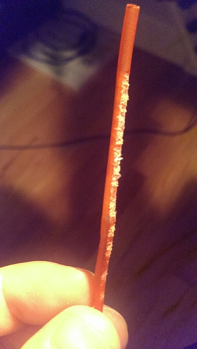

Piercet I have attached some pictures of the extruder as suggested. I did clearance the hole before i put the extruder together. The hobbed bolt is from Lulzbot and the idler spins freely without any binding at all. After taking off the hot end I can consistently extrude 100mm of filament without any issues.
With a Lulzbot purchased Buda I assume the QA done before the nozzle is built will take care of the thermister resistance and anything else that might cause a problem.
While searching this forum I came across a post with a similar issue and they were having issues with eat creep during printing. I decided to measure the filament after the extruder jams up and it is consistently between 3.15 and 3.25 mm. I think this is my issue. I already have a fan on the nozzle but not on the cooling fins.
Let me know if you see anything odd in the pictures. Any suggestions are welcome.

I just re-read your original post and noticed you were printing with PLA… Yeah, I do think you will definitely need a fan pointed at the fins! PLA tends to “swell” when it’s heated up, so it’s crucial to keep the heatsink of the buda cool enough… The fan pointed at the nozzle is really to help with the quality of the print. There was a design posted here on the forum for a fan mount that divides the airflow between the buda’s heatsink and the nozzle, that would be worth a try!

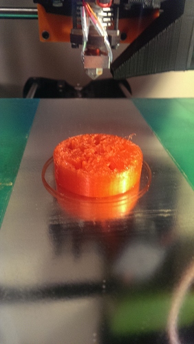

I just tried printing out the 5 gear bearing after putting things back together. The print made it a little bit further but the same thing happened again. Attached are some pictures to show in more detail.
I will track down that mount and print to see if it makes a difference. I am just curious why more people dont see this issue with the Buda printing PLA. Are the handful of people you see posting the only ones? Or do most people print ABS and Fleximagic with there Taz?

Just want to follow-up and say the hybrid cooling fan mount here:
[https://www.thingiverse.com/thing:374906/#comments](https://www.thingiverse.com/thing:374906/#comments)
has really helped my jamming. The reprap community is awesome!

I was just drive by reading and stumbled on this thread… Dont know if you fixed this yet or not, but after seeing your pictures the problem is pretty obvious.
That filament of yours should NEVER be over 3mm. Some hot ends even have issues with 3mm filament. Most filament is between 2.75 and 2.9.
If it really measures 3.34 mm in some areas that filament is junk (or defective). Trow it away.
