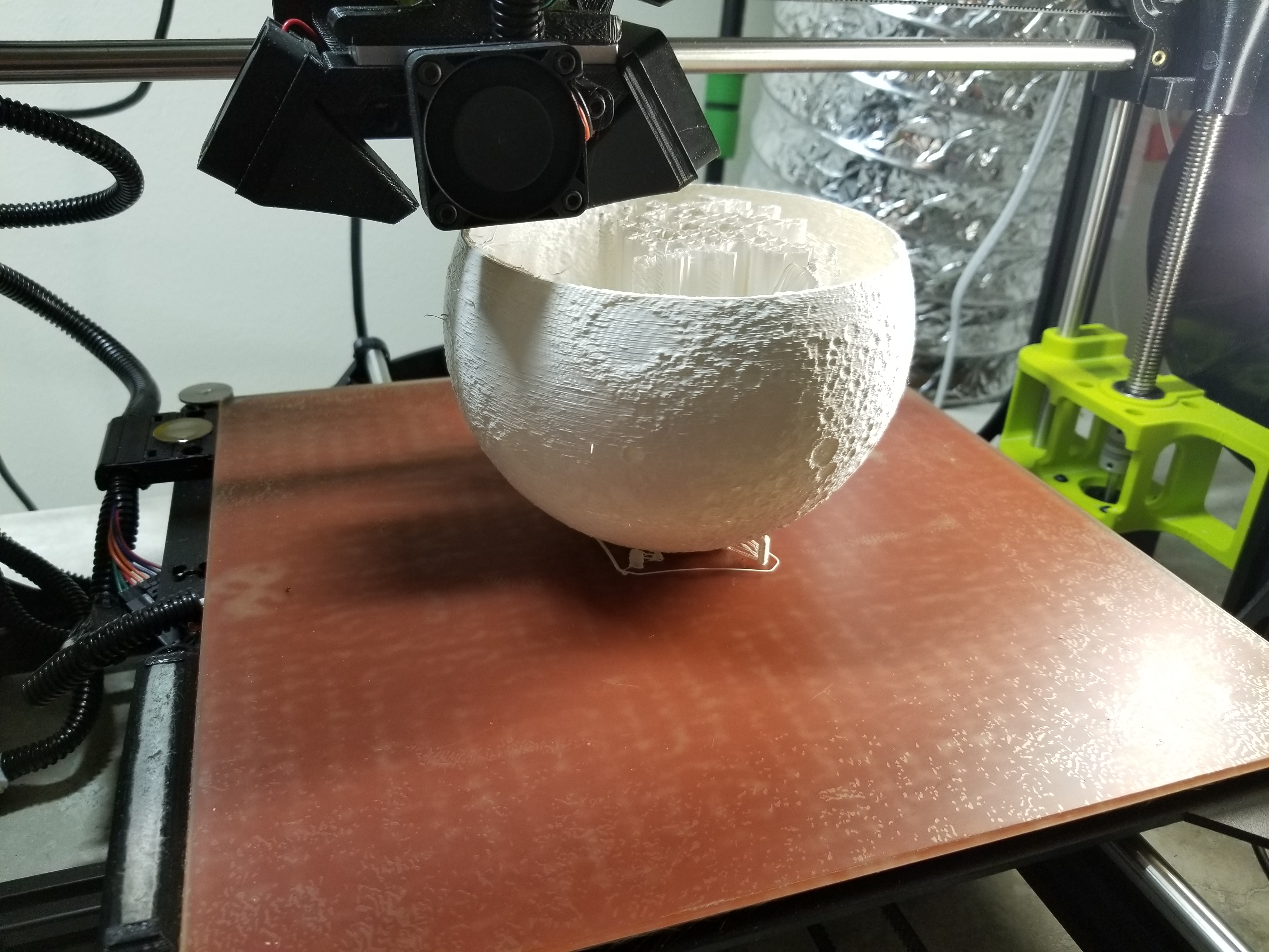

I started a print job (fairly large) with some white filament from MatterHackers. After about the 10th? z layer I noticed that the extruder wasn’t putting down any plastic. I have restarted the print several times with the same result. The gear where the filament is pulled down (gear next to bearing) wears a notch in the filament. Photo attached. Does anyone know what might cause this? I am using PLA with the “Village plastics” setting and high quality. I am using the recommended settings and not custom. Is it a problem with the PLA I am using or something else?
 ![20180624_120446.jpg](https://us1.discourse-cdn.com/flex020/uploads/lulzbot/original/2X/6/6aeb473a132246d66d8e7837d7213c3b4b45db15.jpeg)

For starters what toolhead are you using when this happens? It looks like heat creep, which PLA is known for. Heat creep is when the heat travels up the heat break from the nozzle and starts to soften the filament at the hobbed bolt, and once it starts to soften there, the hobbed bolt just chews into the softened filament rather than catching on it and pushing it down and out the nozzle.
Generally when using white PLA, try reducing the hotend temperature to 195C and see if that helps any. Also, now that a bite mark has been cut into the filament, make sure to clear the residual filament out of the teeth of the hobbed bolt, otherwise you can see the problem happen sooner, do to the teeth being filled with plastic and not being able to bite down on the filament and feed it into the extruder.

The tool head is the single extruder that ships with the Taz 6. I saw that there was residue on the gear so I’ve cleaned it out each time that happens. I’ll try reducing the temp and seeing that that helps the issue. Thanks!

I also got the same problem with some translucent green PLA. The model has a lot of support structure (10 diameter moon) on the bottom which covers almost the entire print bed. I haven’t run into this issue before so I am wondering if the large amount of retraction might cause the issue along with the heat creep. I am going to test with a much smaller version of the model and see what happens.

With such high ambient temperatures, it makes it more likely that your problem is heat creep - and even the improved heat-sink cooling fan on the newer extruder can’t cool enough to keep the filament from softening too high up and jamming.
You could try different filament that isn’t so sensitive to heat creep, or move the printer into an air-conditioned space for a test print.

Printed the moon in ABS to see if that would make a difference. It did. The ABS model printed completely without getting chewed. I’ll have to come up with a way to cool the room (or heat it)
At least now I have a good idea what the issue was. I appreciate all the suggestions and help!
