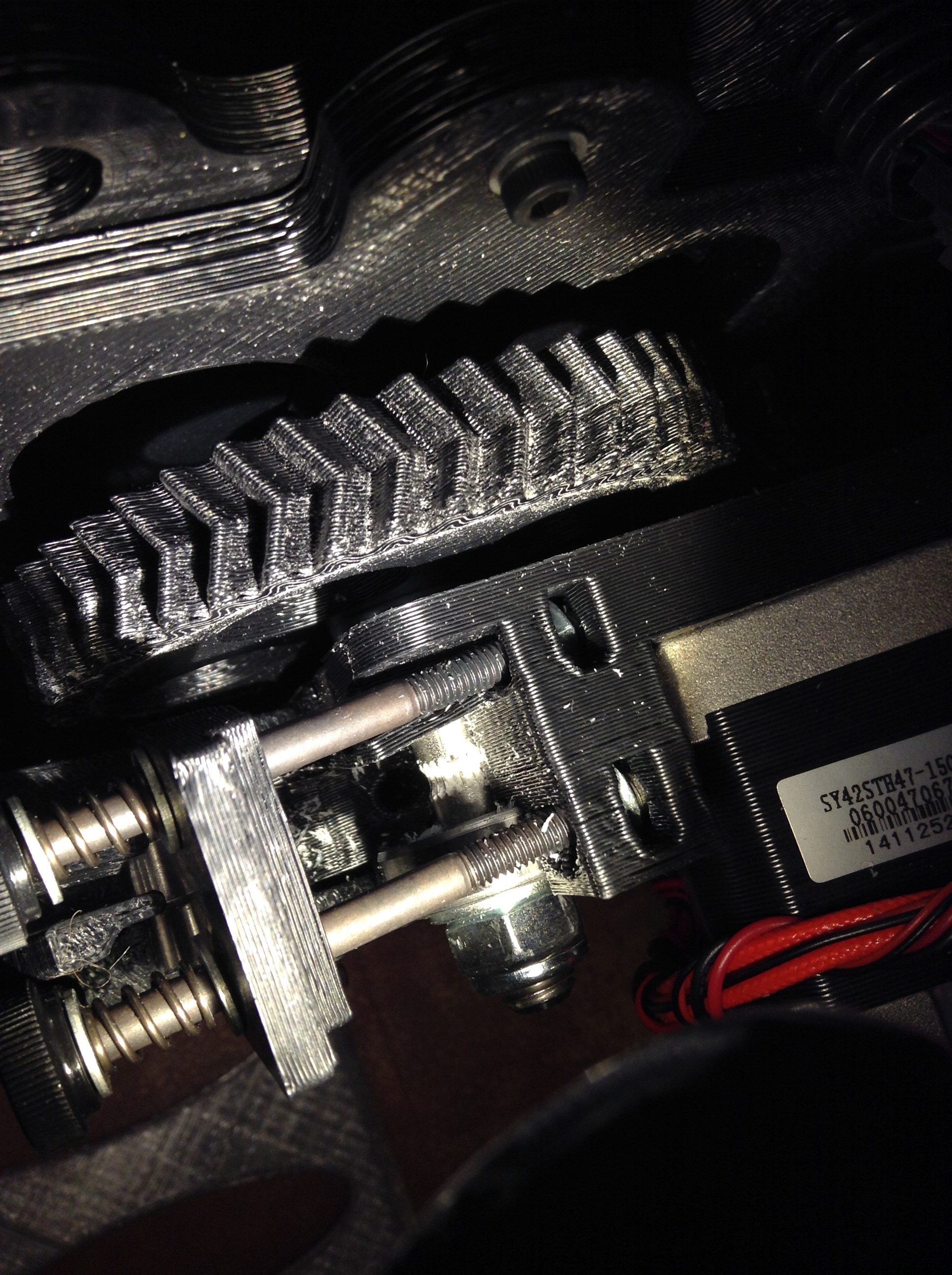

Hi Guys, So I got my Lulzbot Taz 5, new to 3d printer, first thing that I did was read the entire mhackney guide.
Leveled the bed with a gauge indicator, got the first layer as perfect i i thought it can be, but I’m having a problem.

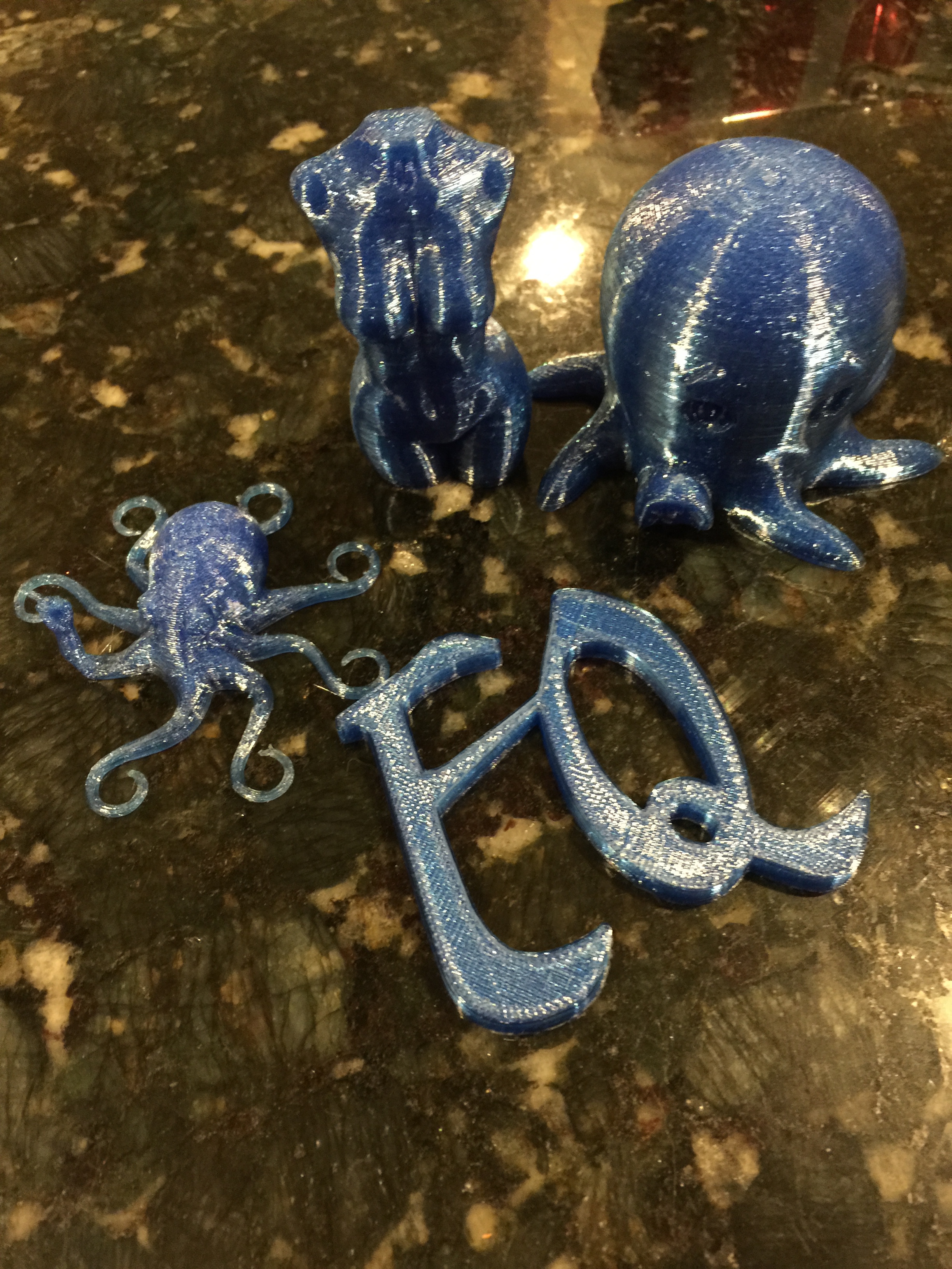

The first tests that I did was with ABS, got 3 prints perfect, the octopus, the mount for the gauge indicator and a spare herringbone gear, all cool.

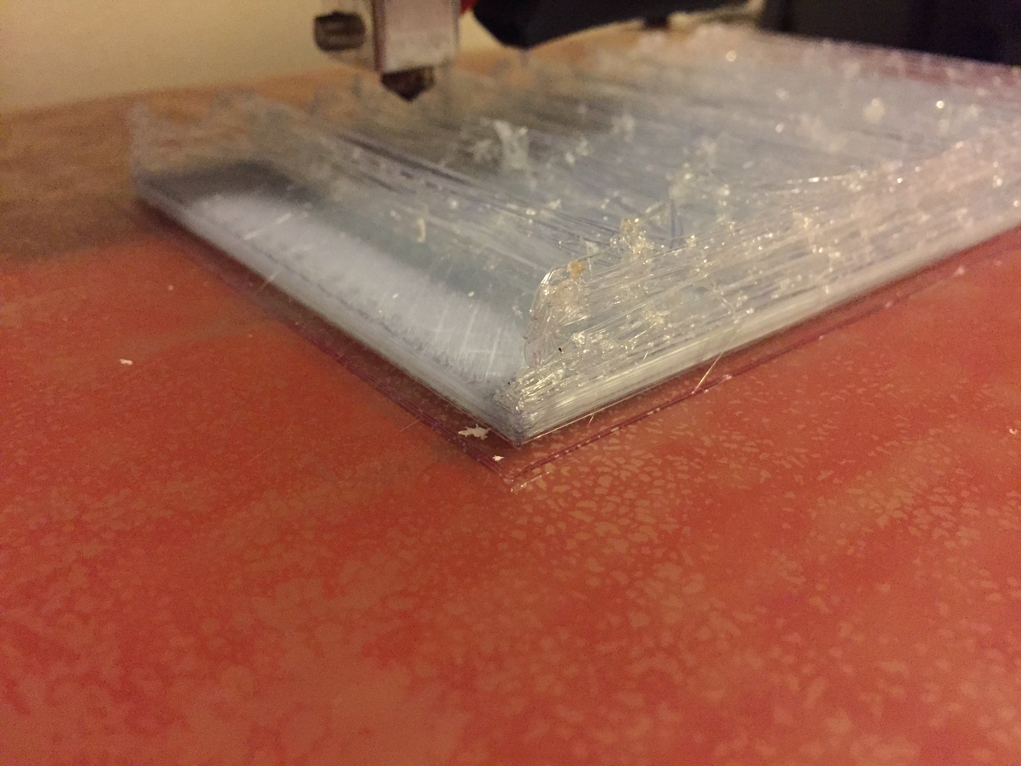

Then i switched to PLA, because i wanted to print something [bigger](http://www.thingiverse.com/thing:676482), and for what i read PLA is more dimensional stable.
First layer perfect, 5 hour print, and my PLA start striping, removed the filament, cleaned the hobbed bolt (without disassembling the extruder) as whell as I could, put the fillament back in, tightened the two screws that make pressure on the filament. Few print hours, same thing. Few hours of print, filament start stripping.
Things that i noticed:
- There is a small friction on the path of the filament between the hobbet bolt and the extruder, exactly when the metal part meets the plastic one, the filament need to be pushed on the correct angle, once is passed that small gap I can feel any friction.
- once and i while i can hear a small “click” that I’m almost sure that is the hobbet bolt slipping.
- It looks like the hobbet bolt is not perpendicular with the herringbone gear, doesn’t it? Check the pictures.
I’m not sure what I need to do now, disassemble the extruder? clean everything and try again?
First test was default fast settings for cura and PLA on Taz 5. Second test I increased 5 degrees on both the extruder and the heated bed.

**Author:** ![Muggs](https://sea2.discourse-cdn.com/flex020/user_avatar/forum.lulzbot.com/muggs/32/9237_2.png) [@Muggs](https://forum.lulzbot.com/u/Muggs)\
**Post date:** [March 19, 2015, 6:00pm UTC](https://forum.lulzbot.com/t/fillament-striping/1493/6 "2015-03-19T18:00:17Z")
vitormhenrique,
I had the same issue. I took apart the hotend and pulled the hobbed bolt from the extruder and cleaned the grooves with an x-acto knife. there was PLA jammed into the groves so deeply that the brush did little to help.
You can read the thread here: [https://forum.lulzbot.com/t/trouble-all-of-a-sudden/1464/1](https://forum.lulzbot.com/t/trouble-all-of-a-sudden/1464/1)

I have found if you over-tighten the thumbscrews on the extruder you strip the filament like you are showing. The instructions call out for a 10mm distance from the top of the thumbscrews to where they enter the extruder that is way off and way too tight. What you want is the spring to be compressed to a height of about 5mm between the washers. If you go much tighter than that it will crush the filament and not let it extrude, resulting in grinding it up into fine particles.
It doesn’t take much pressure at all on those screws to get good extrusions.
