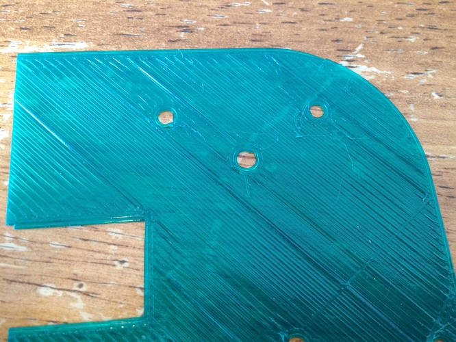

Im in need of help to get a better first layer. the attached photo of a pla print was originally face down on my taz5. How can I improve this print as this is the side I need to look good.
 ![GK Buckle.jpg](https://us1.discourse-cdn.com/flex020/uploads/lulzbot/original/2X/a/aa1d79302fa805d4ffc66478da2e91ea580d7a6d.jpeg)
**Author:** ![mhackney](https://sea2.discourse-cdn.com/flex020/user_avatar/forum.lulzbot.com/mhackney/32/46_2.png) [@mhackney](https://forum.lulzbot.com/u/mhackney)\
**Post date:** [March 15, 2015, 2:53pm UTC](https://forum.lulzbot.com/t/first-layer/1469/2 "2015-03-15T14:53:59Z")
Hello gemmark. Did you read my Guides linked in my signature? They will help you with a strategy to get the great prints you are looking for. This looks like a typical case of “first layer blues” - a combination of a too low nozzle at Z=0 and poorly prepared build surface. There may be some extrusion issue mixed in there too.
Was this your first print? How much experience do you have?
On PEI, I print PLA and get absolutely flawless bottom surfaces 100% of the time for the 3D printed fly reels I manufacture. It can be done and you are already a big step in the right direction with a PEI bed and TAZ 5.

I have not had the opportunity to read the entire guide, but did skim through it. I have very little experience with this printer but very eager to learn. The build plate was heated to the suggested temp and it seems to be level. I did print the rocktopuss as a first print and did notice a similar first layer but not as poor as my file. In a quick summary, what would you suggest?
Mark
**Post date:** [March 15, 2015, 4:19pm UTC](https://forum.lulzbot.com/t/first-layer/1469/4 "2015-03-15T16:19:02Z")
Read my guides and follow them 🙂
First, set the Z height properly. I’d reads it up by .02mm and retry. Keep doing this until the first layer looks good. Best to use my single layer object rather than your print, just to save time and filament. If you can’t get the simple single layer object to print nicely with a Z layer change (by far the most common issue) then we need to be systematic and go through the Guide.

I do use Slic3r for some things. However, I assert tha the intent is not to compensate for an incorrect Z setting, it is to legitimately change the layer height of the 1st layer. If you use this feature and print the 1t layer, it should be exactly the height that you set. If you use this feature to compensate for printer adjustment, when you attempt to reprint the gcode file in the future when your printer might have changed, it will likely fail and you’ll need to replace. Whereas, if you adjust the printer to be accurate, you can print the same gcode file anytime in the future perfectly.
**Post date:** [March 16, 2015, 1:33am UTC](https://forum.lulzbot.com/t/first-layer/1469/7 "2015-03-16T01:33:28Z")
> [@gemmark](#):
It looks like your z-stop is set too and therefore the filament is not sticking where it should on the PEI bed.

kcchen\_00, I disagree, see this marked up photo:
 ![Smooshed.jpg](https://us1.discourse-cdn.com/flex020/uploads/lulzbot/original/2X/c/c64c7093699e66253e1aaa40db0534bd1c314a49.jpeg)
These are clearly areas where the nozzle is smooshing the filament into the bed - it is too close, not too far away. I’d also say from the even distribution of “smoosh” that at least over the area of this part the bed is reasonably level.
And as I said somewhere in an earlier post today, it is bad practice to compensate for Z height first layer issues in the slicer gcode. Set your Z=0 height correctly and be done with it. You’ll be able to reuse gcode in the future that way. Otherwise, you have to slice and remember what to change every time you print.

Ok… I stand corrected. Maybe there is good smoosh. But how do you explain the areas where the filament width is clearly delineated? If the initial height was too low it would be uniform one way or the other across the bottom. Looks like an uneven bed surface… Almost like air or dust under the painters tape/kapton.
Edit: To check whether the print surface is even, use the edge of a ruler and a flashlight. If you can seek peeks of light under the ruler then the surface may not be even. Best done after leveling the bed to ensure its not deformed from twisting.
I also agree a properly adjusted bed and initial z-height cannot be overlooked. Using the z-offset offers the precision of .1, or .01, increments the initial z-height to vary adhesion to the PEI. That precision can’t be achieved with the z-stop adjustment knob. Partially because there is play introduced by the spring, and the bed deflects when using rigid feelers. I’m actually thinking a rigid standoff would keep the X0Y0 more consistent… versus the springs which deflect.

kcchen\_00 - I’ve seen very similar patterns with too low a nozzle. What happens is the filament can’t flow out properly, building back pressure. This leads to the visible filament strands. Then, when some pressure threshold is reached, the hotend releases that backed up filament, resulting in the shiny “smooshed” areas you see. This does not completely make sense from what I see in the photo but, but fix one thing at a time starting with the biggest issue will usually obviate the secondary issues that were being masked.
**Post date:** [March 16, 2015, 8:33pm UTC](https://forum.lulzbot.com/t/first-layer/1469/12 "2015-03-16T20:33:06Z")
Yes, too close resulting in blobs from the built up backflow is what I’ve seen too… the edges of the print resemble this, but honestly looks more like the filament extruded above the bed lacking detail. I’ve never seen the completely smooth surface and striations of the extruded filament.

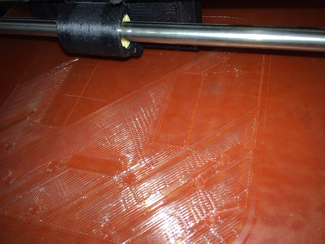

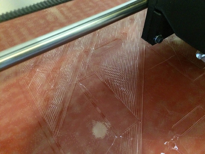

I’ve had my Taz 5 for a year and have printed over a hundred of great prints in PLA, ABS, and HIPS with the original 0.35 mm nozzle. I recently swapped out the Hexagon hot end with the 0.5 mm nozzle. That’s the nozzle they shipped for the 2nd half of Taz5 production. I’ve been having terrible problems ever since. I followed the online instructions for assembling the toolhead with filament in it to align the hot end and I’m using the 0.5 mm Lulzbot Cura profiles, but get lots of bad artifacts on the first layer. All of this has been with PLA.
I also rezeroed the Z-axis, re-leveled the bed, and printed the the “star/plus-shaped” bed calibration gcode.
I never had these sorts of issues over a year of use with the 0.35 mm nozzle. Any ideas? Here are a few jpgs with PLA.

Looks to me like your Z is too low.

Thanks – I went through the “paper thickness” recalibration again and this time calibrate z a bit higher. That made all the difference - thanks!
