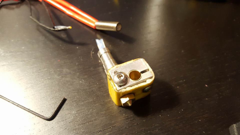

**Post date:** [June 7, 2016, 12:56am UTC](https://forum.lulzbot.com/t/flexion-extruder-build-log/3525/2 "2016-06-07T00:56:59Z")
So the Flexion came in today and it looks great! I am so excited to get this going. I will be using the thermistor and heating cartridge from an old hexagon hotend I have this way there isn’t anything to change on the firmware side of things besides the E-Steps. Next thing is for me to get a stepper motor for this and assemble it so I can think of some good mounting strategies. Any tips?

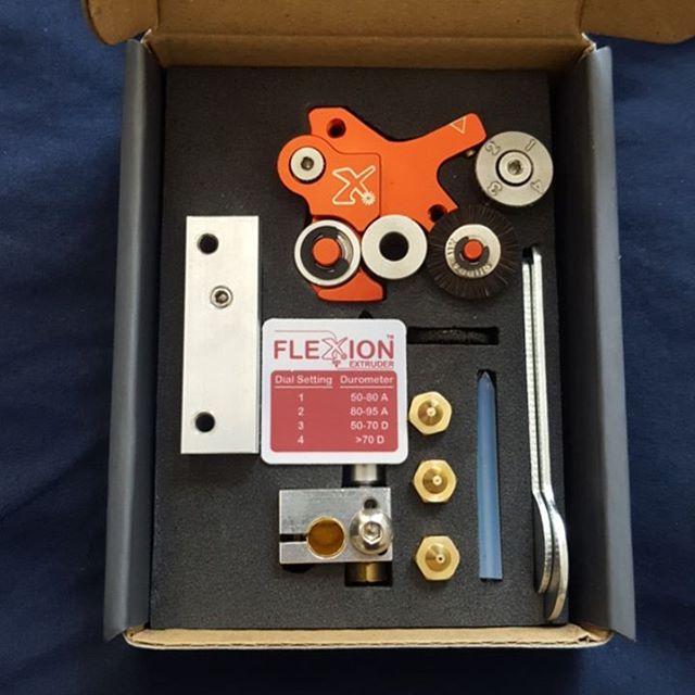

**Post date:** [June 10, 2016, 2:21am UTC](https://forum.lulzbot.com/t/flexion-extruder-build-log/3525/3 "2016-06-10T02:21:45Z")
I just finished the main assembly of the Flexion. It is a super simple process and I used the wiring harness, thermistor, and heating cartridge from an old Hexagon hotend. I am waiting for 2 fans and a heatsink to come in. In the meantime I will be designing and printing a mount for this bad boy.

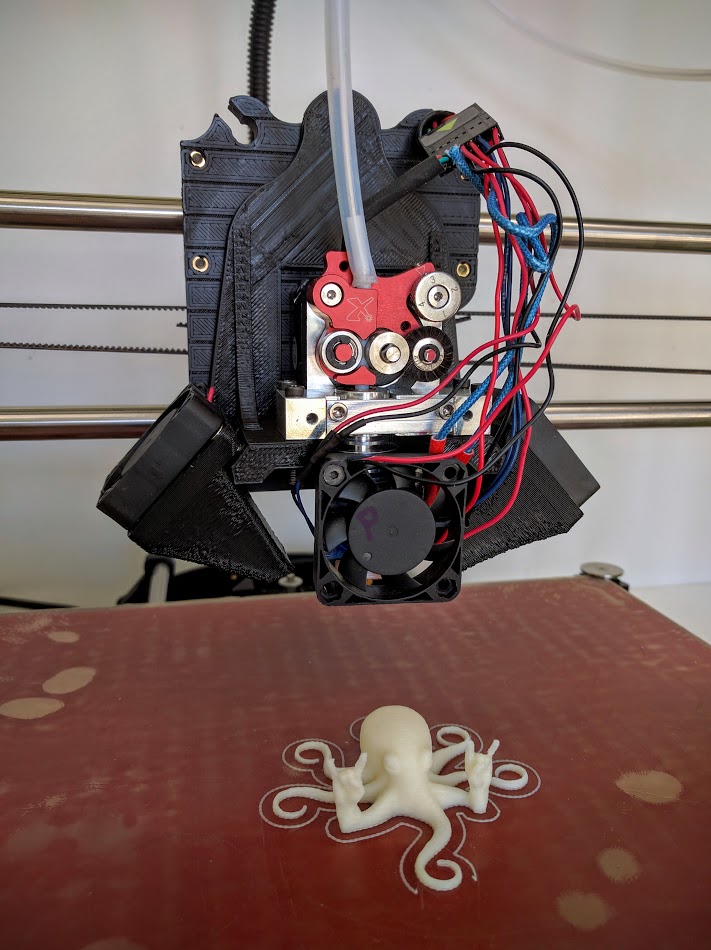

Here’s an alpha of a TAZ 6 flexion we’re testing.
We’re looking forward to offering 1.75 solid/flex in one tool head!
I’ll share the model once we’ve worked the bugs out- I’m already printing a revision. A Mini version will come after that.
 ![diabase flexion taz 6 alpha first print.jpg](https://us1.discourse-cdn.com/flex020/uploads/lulzbot/original/2X/f/f5c66f71e19528eff96f09e0d105226c193c3860.jpeg)
