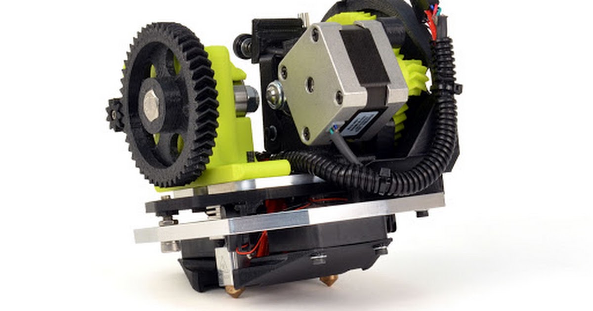

I am having a problem with the ABS side of my Flexydually grossly over extruding on my TAZ 6.
I don’t believe the problem has anything to do with the print head itself, because I have a second Flexydually print head, which does the same thing when installed on that machine.

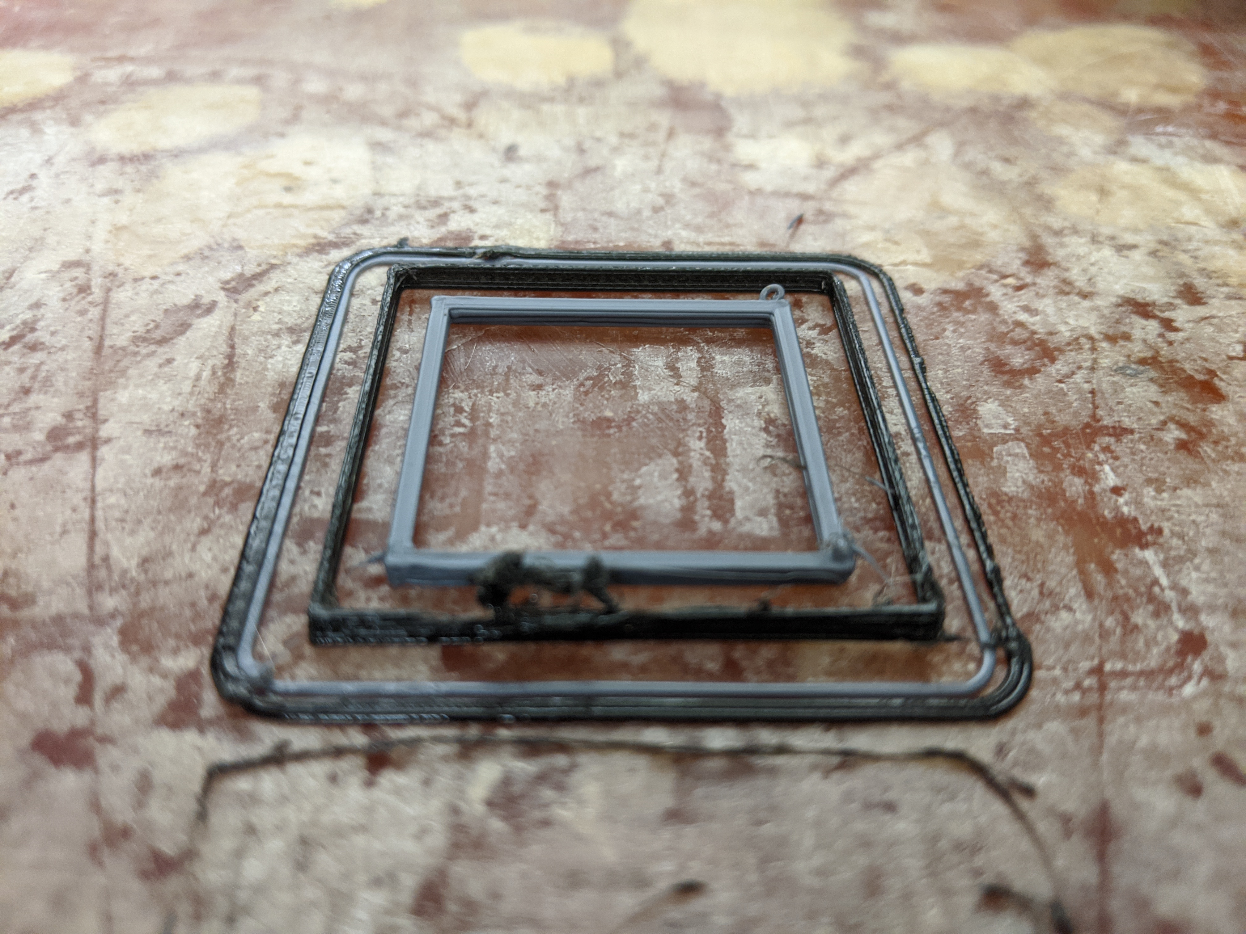

This is the first layer of abs.

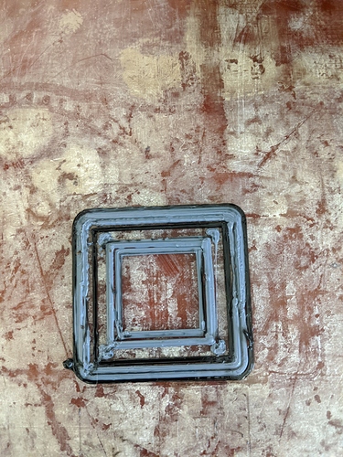

First layer of ninjaflex

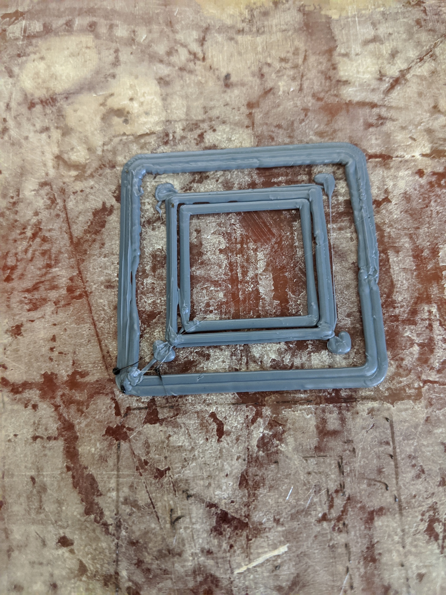

2nd layer of abs. This is as far as I got. The Ninjaflex side ejected it’s filament for some reason. Maybe a glitch because I was pausing to take a picture after each layer.
The FlexDually does use 0.6mm nozzles (assuming they haven’t been changed).
Thanks for posting those photos … it certainly looks like the nozzles are heavily over-extruding.

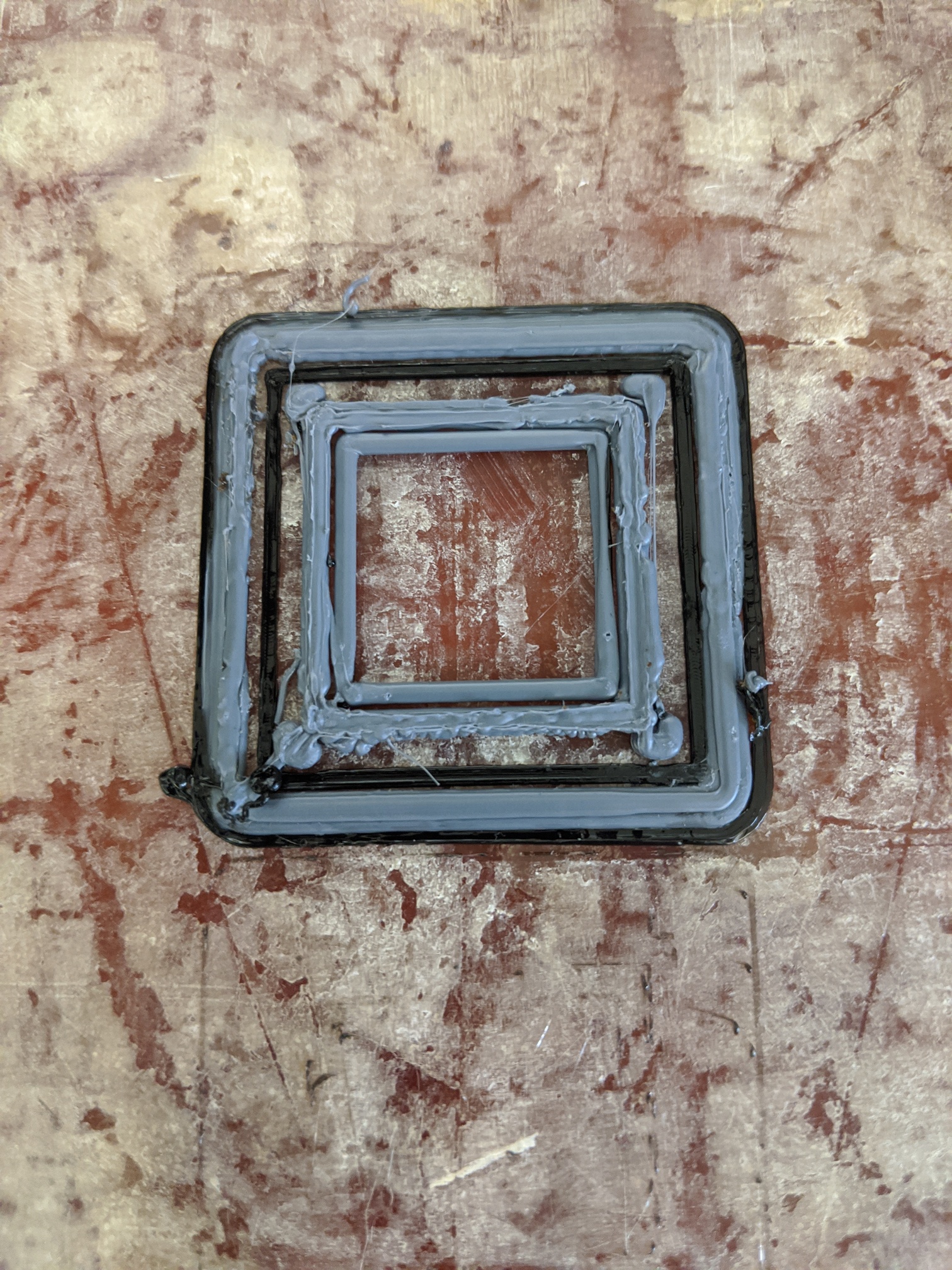

I aborted this print because the Ninjaflex nozzle was dragging a big glob around.
The ABS flow rate was set to 50%. The Ninjaflex was set to 100%.
In the one oi pictures, I peeled off everything except the abs so you could see the layers. It still looks like over extruding to me at 50% flow rate!
