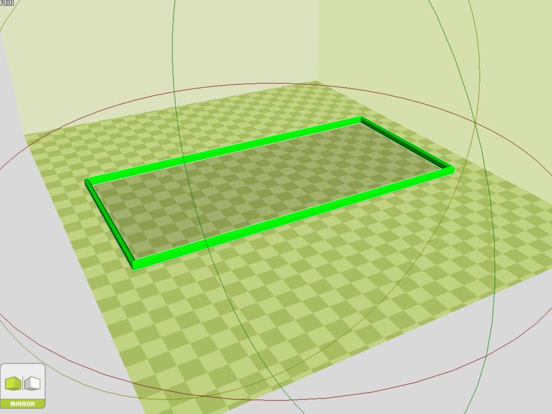

That basically gets me to where I need to be, printing with just the front flexy extruder. I was able to print the needed [gasket](https://www.thingiverse.com/thing:2119644url) alone in ninaflex.
Positioned horizontally in Cura:
 ![gasket horizontal.jpg](https://us1.discourse-cdn.com/flex020/uploads/lulzbot/original/2X/6/6eaf9880e2fc2744389c33bd61a07e5d2af10f10.jpeg)
Comes out like this:
 ![20170718_220218.jpg](https://us1.discourse-cdn.com/flex020/uploads/lulzbot/original/2X/5/54dc768d4e103d5b4c0eeb2956140d2c6445a6e2.jpeg)
Already removed 3mm brim in photo but it printed ok, model centered along X however not along Y (ok in this case, but not for a bigger model)
Positioned Vertically in Cura:
 ![gasket vertical.jpg](https://us1.discourse-cdn.com/flex020/uploads/lulzbot/original/2X/8/82113651dfc963006cf9a8579ffc1448f9fdc439.jpeg)
