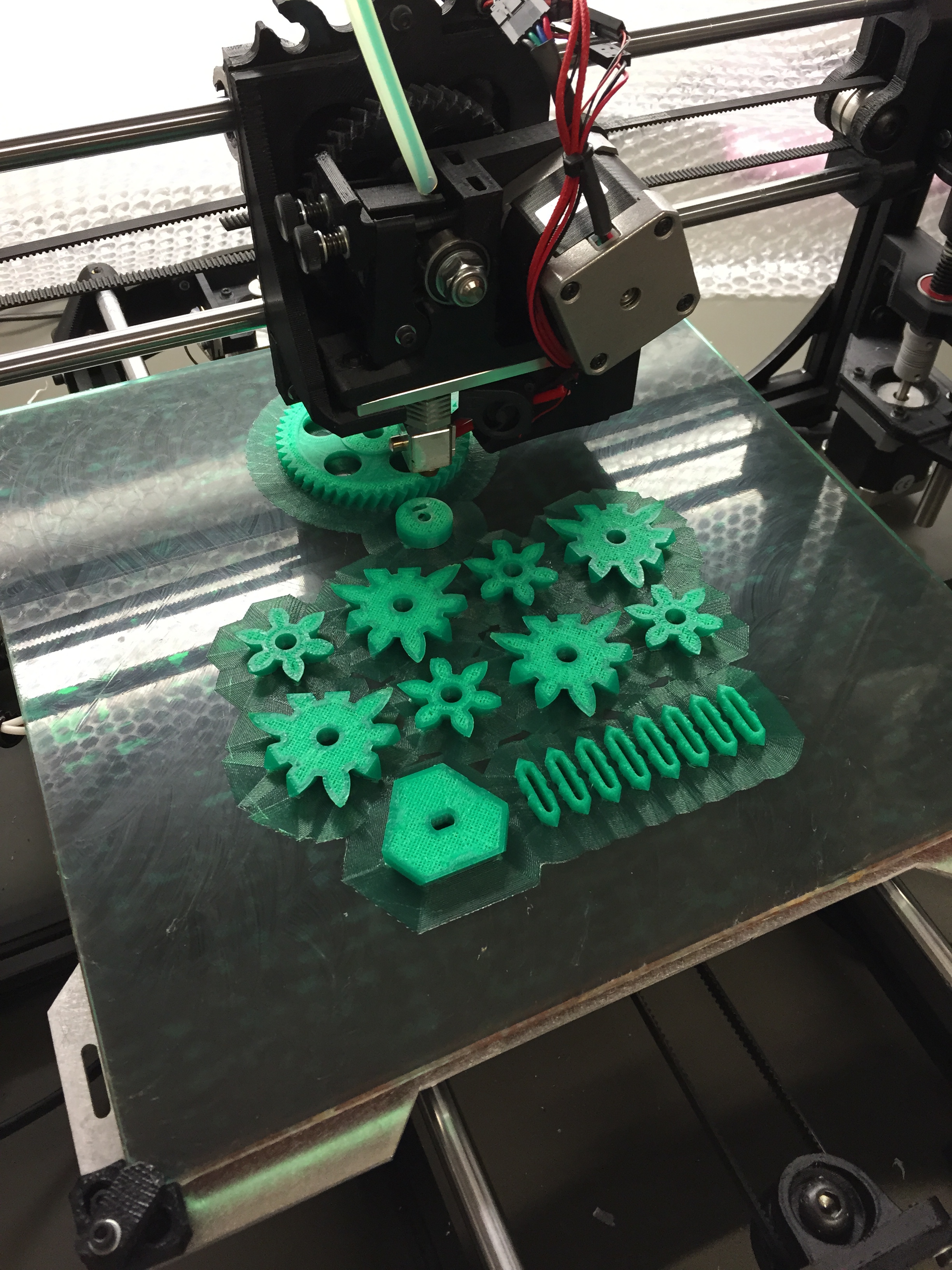

**Post date:** [March 24, 2015, 9:55pm UTC](https://forum.lulzbot.com/t/for-those-who-want-to-print-with-105-trimmer-line/1489/5 "2015-03-24T21:55:47Z")
So I did some searching around and I printed in a laboratory fume hood and the trimmer line seems to work great so far.
It holds a bit of artifacts but noting that I would consider bad.
 ![IMG_0804.JPG](https://us1.discourse-cdn.com/flex020/uploads/lulzbot/original/2X/6/6999defd9dd7ee5b7632bb85c14c755d43d85e23.jpeg)
 ![IMG_0803.JPG](https://us1.discourse-cdn.com/flex020/uploads/lulzbot/original/2X/c/c87b3ff16ea94515a41f8f5b2c0df5e2803f7f88.jpeg)
 ![IMG_0802.JPG](https://us1.discourse-cdn.com/flex020/uploads/lulzbot/original/2X/4/4387ffe3424248484b929bcd9a3543705e8f1764.jpeg)
 ![IMG_0800.JPG](https://us1.discourse-cdn.com/flex020/uploads/lulzbot/original/2X/2/263be5a4946fc39451510ac15182bdd930883483.jpeg)
**Post date:** [March 25, 2015, 5:49am UTC](https://forum.lulzbot.com/t/for-those-who-want-to-print-with-105-trimmer-line/1489/6 "2015-03-25T05:49:41Z")
Those look nice! Very interesting… Maybe in a jam I might have to try it.
I’ve heard of folks using trimmer line with my other printer… But no one ever produced pictures.
Thanks for sharing.

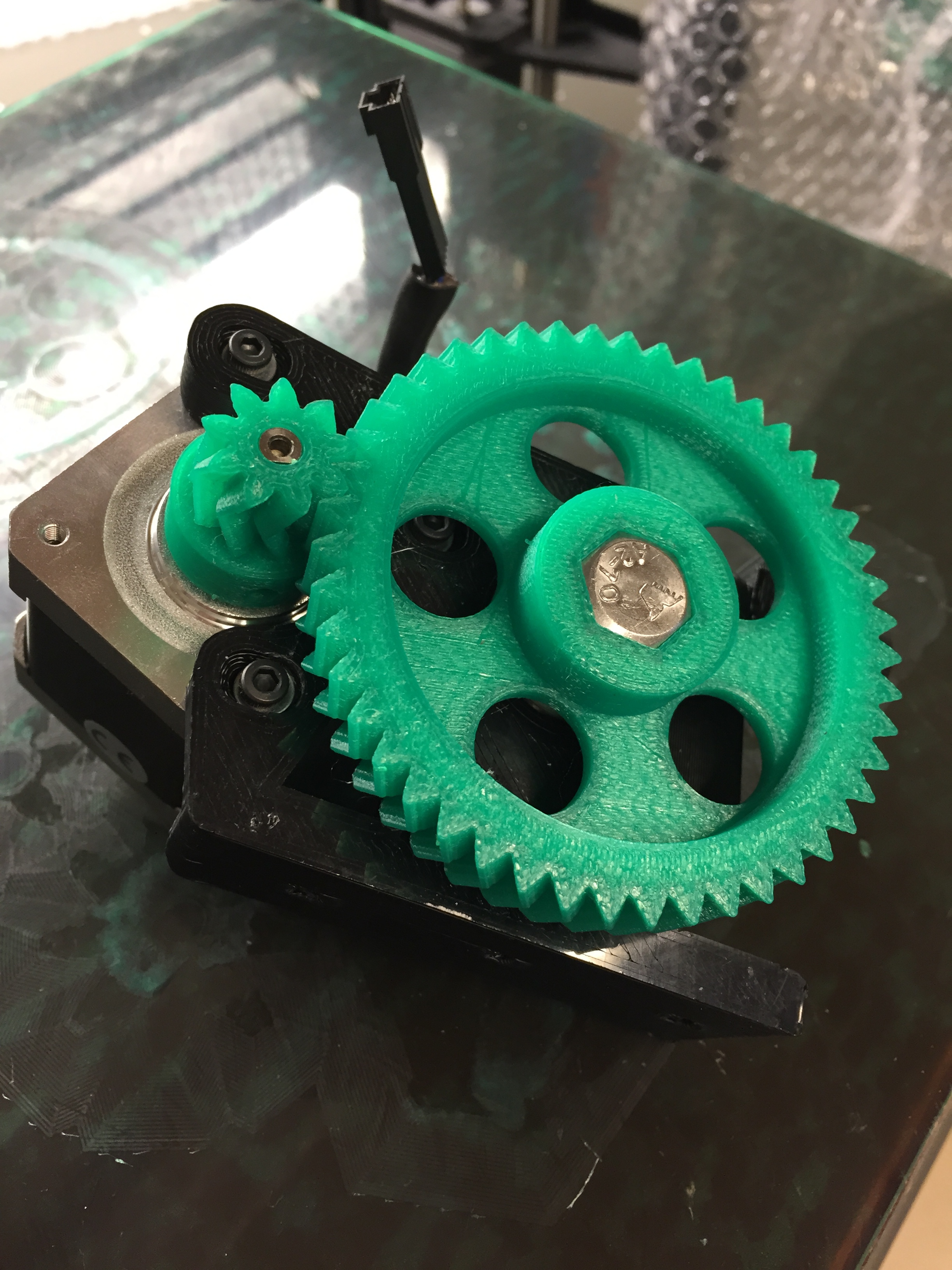

**Author:** ![Brew4You](https://avatars.discourse-cdn.com/v4/letter/b/ebca7d/32.png) [@Brew4You](https://forum.lulzbot.com/u/Brew4You)\
**Post date:** [March 25, 2015, 5:27pm UTC](https://forum.lulzbot.com/t/for-those-who-want-to-print-with-105-trimmer-line/1489/7 "2015-03-25T17:27:21Z")
It seems to work out pretty well. I would think outside of what is off gassed the biggest think I look out for when finding filament is if there are additives in the line to make it more abrasive like fiber glass that could clog up or grind away my nozzle. I think the cheap stuff is better/safer for the machine, as there isn’t money spent on as many additives.
What I’ve noticed after 50+ hours of printing with this stuff:
Cons:
The dimensions run a little expanded, about 0.01-0.03mm bigger on outer dimensions and same thing but smaller on inner dimensions.
It has an issue with contraction. I can’t always get it to stick down to PET with Elmer’s glue and when it does stick it can lift the PET from the glass. An enclosure helps out tremendously I’m hoping a PEI sheet will also fix the issue. It will also contract on really sharp overhangs. I noticed the problem when going from 60° to 70°.
It is stringy, not oozy so it’s not that bad.
Pros:
Really smooth prints that can run at high speeds.
Overhangs up to 60° are not a problem.
dimensional difference is still within 10% of the nozzle size
Here is a print speed sample.
 ![FullSizeRender 3.jpg](https://us1.discourse-cdn.com/flex020/uploads/lulzbot/original/2X/f/f157fba27c86326d0281ce38a9121ea8fd79f18f.jpeg)
 ![FullSizeRender 2.jpg](https://us1.discourse-cdn.com/flex020/uploads/lulzbot/original/2X/9/9066b3bf62e769746805755ffeddb2204a66da3c.jpeg)
