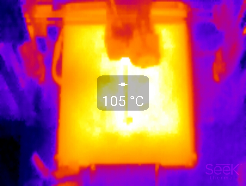

I think its the aluminum causing more uniform heating. I took a quick pic while I was printing an object, and the bed seems to have distinctive hotspots also. This is a newly replaced bed due to the PEI bubbling. If you flip the bed around, you can see faint outlines of the nichrome wire pattern.

Huh. Interesting to see the stock 5 bed there for comparison. What temperature did you have the bed set at there? Mine were only at 80 in those pictures.
**Post date:** [September 12, 2015, 5:30am UTC](https://forum.lulzbot.com/t/fun-with-infrared-cameras/2192/12 "2015-09-12T05:30:17Z")
Probably 100 or 110C…
**Post date:** [September 12, 2015, 6:27am UTC](https://forum.lulzbot.com/t/fun-with-infrared-cameras/2192/13 "2015-09-12T06:27:29Z")
The aluminum bed is a little thicker than the glass bed, I wonder if it takes a bit longer to get up to temperature for that reason. It seems to hold heat well enough and get all the way to temperature after a bit though.
