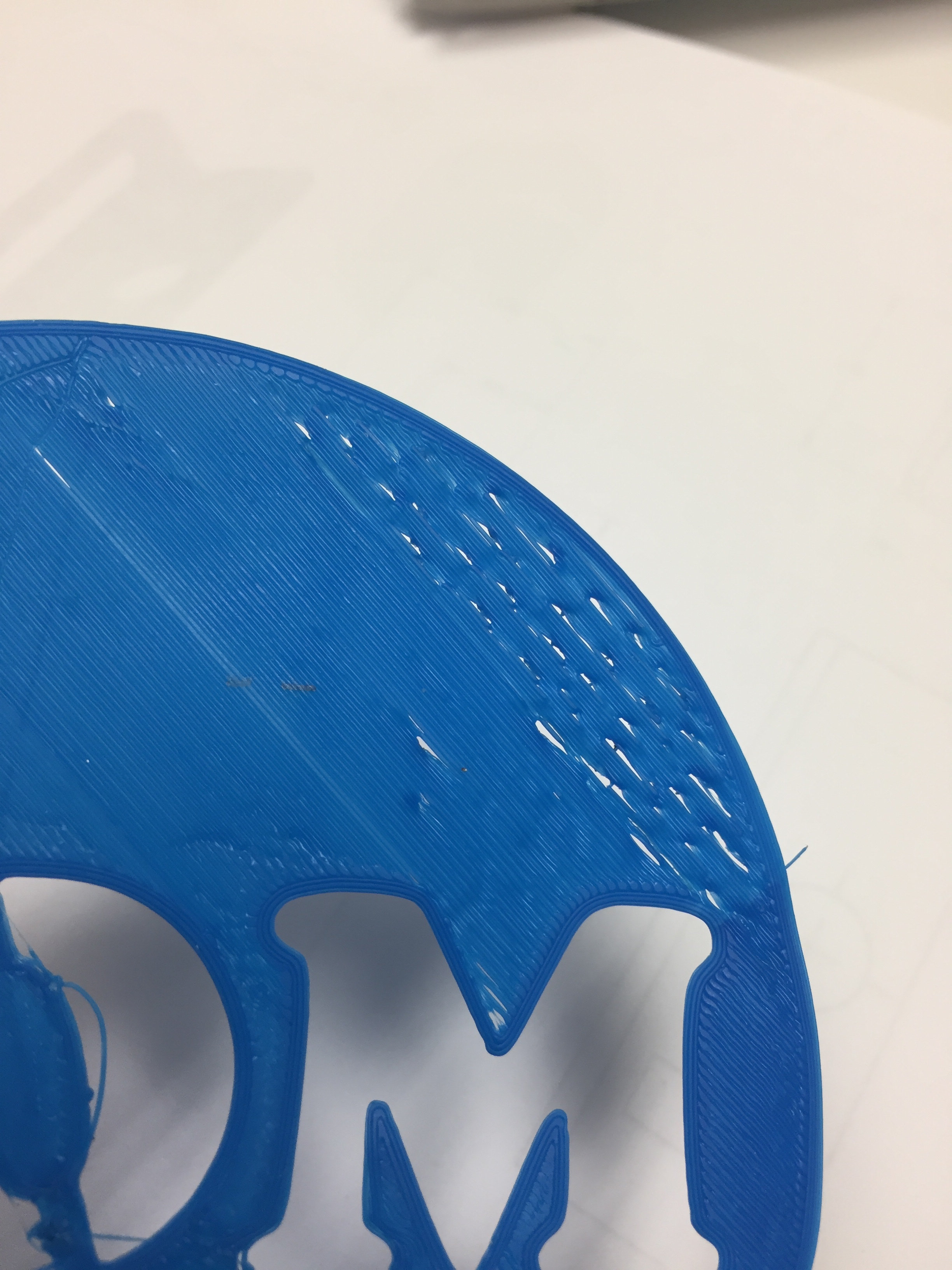

Hey Folks,
Just wondering if anyone can give me some tips to get ABS plastic to stick to this new PEI bed surface?
I’ve had great success with small parts sticking 2"x2" square and rectangle shapes.
Larger shapes make bacon as I call it, the first layer does not fully adhere and becomes wavy and each subsequent extrusion just builds on to the wave.
Currently running it a 270C extruder, 100C Bed, no fan and extruding the first layers at 15mm/s with a 0.35 nozzle on 0.2 layer height.
Here is an example of a part that didn’t’ want to stick.
 ![IMG_3916.JPG](https://us1.discourse-cdn.com/flex020/uploads/lulzbot/original/2X/2/28e1b4bc20c6aca7c89d0e38e807583ef2fd9ec6.jpeg)
On the short extrusions (the Left/Right side of the M) it does fine. It seems to do it on longer extrusions.
**Post date:** [October 23, 2019, 2:14am UTC](https://forum.lulzbot.com/t/getting-abs-to-stick-to-pei-bed/6980/2 "2019-10-23T02:14:39Z")
The temps seem off… Try 250C and 110C. Try scoffing up the PEI with a green scotch brite pad.

**Post date:** [October 23, 2019, 3:19pm UTC](https://forum.lulzbot.com/t/getting-abs-to-stick-to-pei-bed/6980/3 "2019-10-23T15:19:10Z")
I tried adding a brim to the print to help it stick but even the brim was popping off after about four extrusions. Not layers, just the forth time around the brim shape it would twist
This blue colored ABS just wanted to warp up something serious.
I have cleaned the PEI with alcohol.
I will try your suggestions and report back.
Would running a slower first layer help? Just thinking that a slower speed would give the extruded plastic time to set and might eliminate some of the stress that’s causing it to warp.
**Post date:** [October 24, 2019, 5:01am UTC](https://forum.lulzbot.com/t/getting-abs-to-stick-to-pei-bed/6980/4 "2019-10-24T05:01:25Z")
Make sure the print fans are off when printing ABS to help with adhesion.
If your slicer allows for variable cooling, I like to set the fan to 8% after the print has reached 3mm (10 layers at .3 layer height). Also drop the bed temp to 100C or 90C after the print reaches 6mm… the base should have solidified enough to resist warping.
