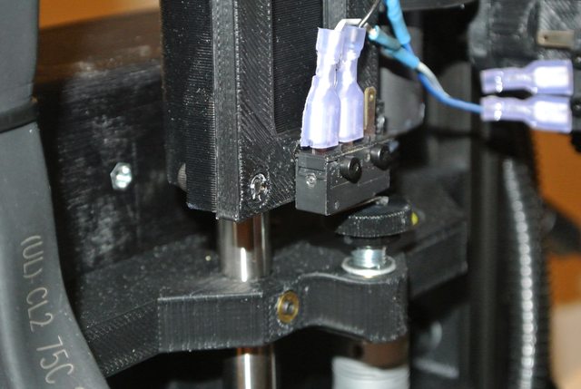

1. change out the Z axis endstop switch and wiring. It moves from the lower threaded rod mount to the upper X end motor mount, so you will need a longer endstop wire. The endstop itself also mounts differently so you will need some M2 cap screws. I think the 10mm long ones work. You will also need an M5 Cap screw thumbscrew cover for the new Z endstop target. ANd a different spring and bolt for that matter.

Yes, I had noticed today that the endstop wiring is rather short! Heh. Will for sure have to lengthen that wire. I already have the M5 capscrew and spring, so that’s all set to go in too.

So far I’ve got the print bed completed. Here are some photos of my work. I had intended on replacing the belts on the Y and X axis, but upon close examination they’re still in fine condition. I’ll just put the new belts I bought in the replacement parts pile for now.

Some initial problems I had with the printer was with one of the Z-axis steppers. When I first tested that, only one side worked as it started racking the entire assembly. Caught it in time. The problem was that two of the wires to the right most Z axis stepper had pulled out of the pins. I’ll have to figure out how to pull that apart and fix them. For now, I just stuffed the wires back in the holes. Needless to say, I won’t do much printing the way that is till I fix it.
After I corrected the messed up belt routing fiasco, I leveled the Z axis with my digital dial gauge, then proceeded to level the heated bed. Got it within 0.01mm between all four corners.
![](http://i.imgur.com/XukWxkll.jpg)
![](http://i.imgur.com/NqTgerYl.jpg)
The printer looks a little ghetto right now with the limit switches being held in place with masking tape and none of the wires routed nicely (and a bad connector), but I HAD to do a test print regardless.
