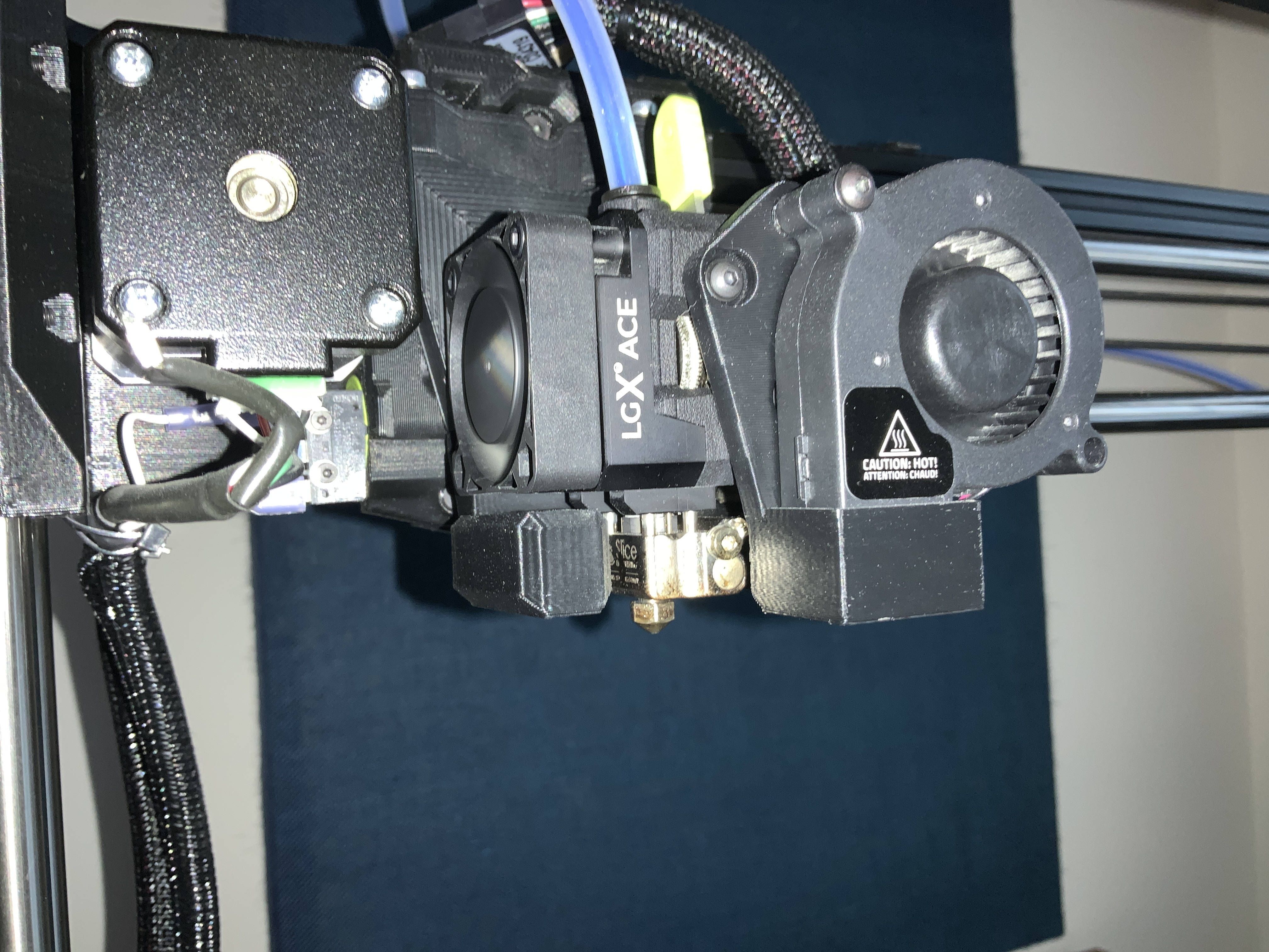

You may have been asked and answered this already, but can you provide a picture of the actual toolhead installed?

**Post date:** [February 13, 2025, 9:55pm UTC](https://forum.lulzbot.com/t/heating-failed-taz-workhorse-trouble-at-temps-200c/27184/28 "2025-02-13T21:55:16Z")
![image](https://us1.discourse-cdn.com/flex020/uploads/lulzbot/original/2X/b/bb5d80975c3a68ad1d6e9507b65cfe1a05968405.jpeg)
 ![image](https://us1.discourse-cdn.com/flex020/uploads/lulzbot/original/2X/4/490c75f5b8f10d89f3fae5574113a15d44cd2425.jpeg)
> **[LulzBot Meteor 285 Tool Head | Nickel Plated Brass | 0.5 mm | LulzBot](https://lulzbot.com/store/lulzbot-meteor-285-tool-head-nickel-plated-brass-0-5-mm-kt-cp0189?ref=KT-CP0189)**
> Experience the Meteor 285 Tool Head's entry into our tech orbit; precision and reliability reimagined with flexible filaments in mind. This genius marriage of a custom 2.85mm Slice™ Hot End and Bondtech™ Extruder, teleports us to uncharted...
**Post date:** [February 13, 2025, 10:06pm UTC](https://forum.lulzbot.com/t/heating-failed-taz-workhorse-trouble-at-temps-200c/27184/29 "2025-02-13T22:06:23Z")
So, just to be clear, when you add the machine in Cura LulzBot Edition 4.13.10, it should be selected as Taz Workhorse(+) with Meteor 2.85
 ![image](https://us1.discourse-cdn.com/flex020/uploads/lulzbot/original/2X/d/d6a247a2723055207f907587de485a24c7c9c4e7.png)
After doing that, updating firmware should be putting firmware 2.1.3.0.29
 ![image](https://us1.discourse-cdn.com/flex020/uploads/lulzbot/original/2X/b/b67b941db883b5018a3c3a16daf8828d5b69b8f8.png)
 ![image](https://us1.discourse-cdn.com/flex020/uploads/lulzbot/original/2X/7/7dc5dc2f9b9f9596fa4a76d3b418d213c57e7abd.png)
I just checked the latest Marlin code for the firmware, and it indeed does NOT have different values for the 2.85 vs 1.75 Galaxy-series toolheads:
 ![image](https://us1.discourse-cdn.com/flex020/uploads/lulzbot/original/2X/c/c21340ab36ccd20f8be05ac2e9b3abc0b69e206e.png)
So it will be necessary to put in the command to use the 2.85mm filament heat capacity. It might get changed when you select the toolhead from the toolhead menu, but I can’t check that right now.
