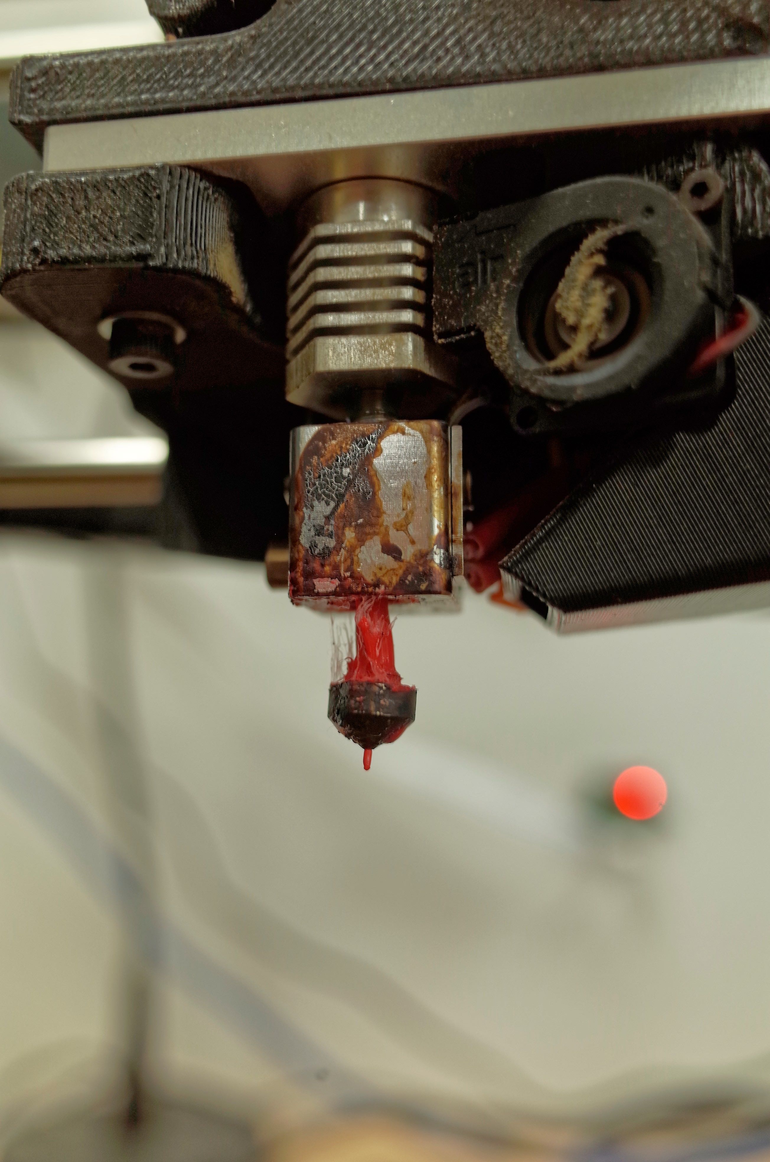

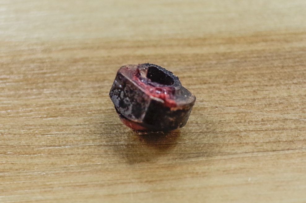

Hi all, I was printing with some scrap material, which seemed to be melting at lower temperature than HIPS, so I assumed it was PLA. I indeed got one print done successfully, but when I tried to print again, filament started seeping around the nozzle, and then the nozzle popped off. Could anyone tell me whether I need to get a new hot end, or whether I can simply push the nozzle back in place? Our printer is shared, so if I need to buy another I would like to know ASAP.
I hope the pictures clarify what is wrong.
Thank you very much,
Zora
 ![01 - 2016-05-08_135545.jpg](https://us1.discourse-cdn.com/flex020/uploads/lulzbot/original/2X/3/3dd969d6b9f435b9d51d6be489927e43e5a44082.jpeg)
 ![_R040419.jpg](https://us1.discourse-cdn.com/flex020/uploads/lulzbot/original/2X/f/f12d6603eb990b34b4b5ba1440c710b28a914abd.jpeg)
**Post date:** [May 8, 2016, 10:04pm UTC](https://forum.lulzbot.com/t/help-hot-end-nozzle-popped-off/3413/2 "2016-05-08T22:04:07Z")
Your threaded nozzle has broken off inside the hot end. It looks like it was leaking and someone over-tightened it and caused it to break. You cannot just push it back in, if it is under warranty still contact support about a replacement.

That happened to me once. I was able to use an easy out to remove the remaining piece of nozzle from the warm heater block.

Thank you both for the replies. Does anyone know if I could use a E3D replacement nozzle like this from Amazon [[http://www.amazon.com/dp/B010MZ8VDK](http://www.amazon.com/dp/B010MZ8VDK) ]? Another option is this: [http://www.amazon.com/dp/B01EX4FAT4](http://www.amazon.com/dp/B01EX4FAT4). I’ve contacted Lulzbot support as well; my coworkers tell me it is under warranty, but again I’d like to get it fixed ASAP.
Thanks again, Zora
**Post date:** [May 9, 2016, 12:27am UTC](https://forum.lulzbot.com/t/help-hot-end-nozzle-popped-off/3413/5 "2016-05-09T00:27:17Z")
E3D V6 nozzles do work. I actually prefer them because they are longer than the Hexagon nozzles and will tighten against the heat break rather than the heater block. They seal better that way and prevent the over tightening failure you just experienced. I have had no problems running them on my Taz printers but have not tried them on the Mini. The only problem I can imagine is that the pointy nozzle will be hard on the wiper pad.

**Post date:** [May 16, 2016, 3:25am UTC](https://forum.lulzbot.com/t/help-hot-end-nozzle-popped-off/3413/8 "2016-05-16T03:25:17Z")
> [@nopick](#):
E3D v6 nozzles work great on the Mini as well 🙂
