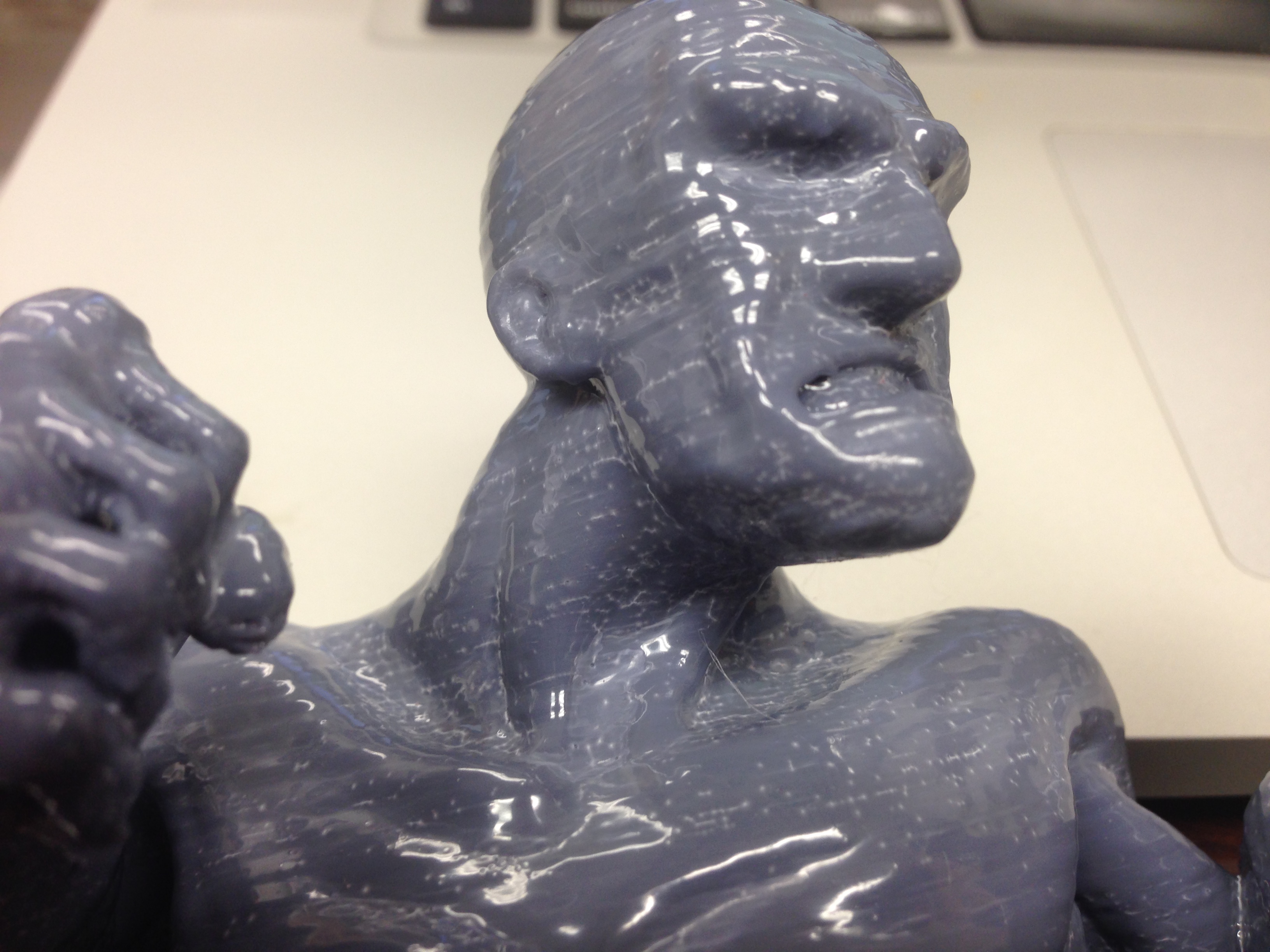

Hello All!
I printed out a character in HIPS the other day. Yesterday I experimented with acetone smoothing, and I can absolutely verify that HIPS smooths BEAUTIFULLY and quickly in acetone vapor. It actually begins to smooth as soon as you put it in the vapors. It is much faster than ABS.
BUT as the picture I uploaded shows, after the print “dried” it developed these odd little spots all over it. They did not appear until well after the print felt dry (it actually felt dry minutes after removing it from the acetone bath). I am using HIPS I got from Lulzbot/Aleph, and it is the gray filament. It looks like the pigment is separating somehow.
The natural colored ABS I smoothed at the same time did not develop these spots.
Anyone have any ideas why this happened?

I have never tried smoothing HIPS with acetone, but I know that Lemonine works great!

This thread is a little older but I will try to revive it.
I tried to smooth HIPS with acetone (nail polish remover). It did not do anything to smooth it. I thought I might not be getting enough acetone on the part so I tried with a paint brush. The acetone did not appear to have any affect on the HIPS. I did everything short of soaking the part in the nail polish remover and it did not soften.
Is there some secret I don’t know about?

From waht I have experienced acetone does not work with HIPS, however for something like $11.00 you can get lemonine delivered to your front door and smooth HIPS to your hearts content.

It sounds like PERC/Tetrachloroethylene is an alternative.

If I were going to use a solvent for HIPS, I think I’d prefer Limonene.

It sounds like some HIPS reacts to acetone, some doesn’t. Seems odd, but that’s what people report. I wonder if you need the hardware store acetone? Perhaps nail polish remover isn’t as concentrated? I know it’s available as a non-acetone type as well, it would be kind of funny if people having issues got that type.
