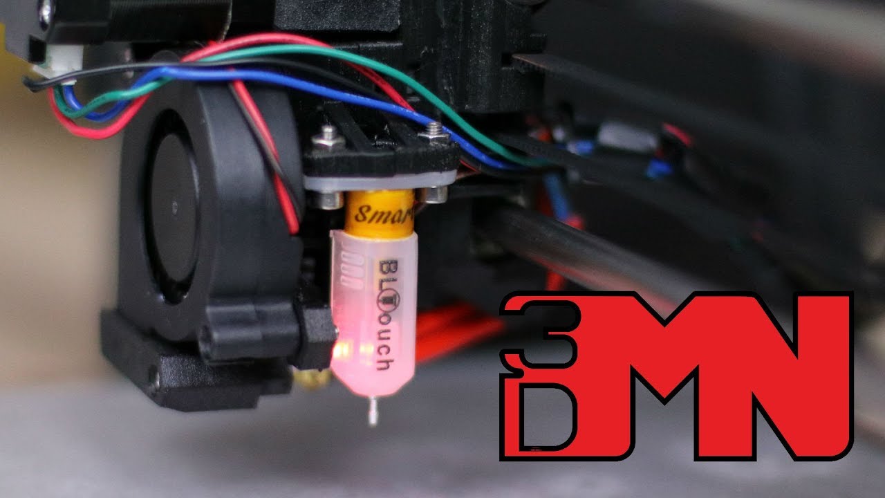

I’ve used this tutorial on a number of machines.
I haven’t put my Wham Bam Surface on the Taz 6 yet…I planned to use the tutorial steps again. Would that work with the Taz?
[![](https://us1.discourse-cdn.com/flex020/uploads/lulzbot/original/2X/2/2bfd0bd6c7ef838b80fa9a97705c53a2688090a9.jpeg "Calibrating Z-Offset With A BLTouch Bed Levelling Probe") ](https://www.youtube.com/watch?v=y_1Kg45APko)
**Post date:** [November 5, 2022, 1:40am UTC](https://forum.lulzbot.com/t/i-cant-raise-my-z-offset-high-enough-for-my-new-wham-bam-bed-plate/24953/13 "2022-11-05T01:40:31Z")
If you have a touch sensor for the 6, that tutorial would be fine, but since the 6 uses the metal washers, there’s not much that will translate with a tutorial for a BLTouch.
Basically, you’re just going to have to measure the thickness of the Whambam system (for this example, the entire system including is 1.5mm thick), add that to the Z probe offset (so it will go from somewhere around -1.25 for the standard glass + PEI to +0.25). It’s best to start high and adjust down while you dial it in.
