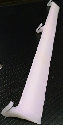

I was trying to use UHU to print PCTPE nylon with limited success so I tried some Elmer’s Washable School Glue and got great results. I was printing a long narrow piece (10" x 1".) My first print was with a skirt and it all stayed flat and well stuck to the bed. With that success, I printed a second piece w/o the skirt and it also stayed nice and flat on the bed. Both prints were done with a bed temperature of 100c.
 ![sample.jpg](https://us1.discourse-cdn.com/flex020/uploads/lulzbot/original/2X/f/f2d23d5aac3865e9fa27e898d537f5b5e2b109d2.jpeg)
This was printed with the flat side down and even the small posts stayed nicely attached to the bed as they were printed and finally joined to the main part at the top.
Cleans up with water.
Thanks for the great advice!
