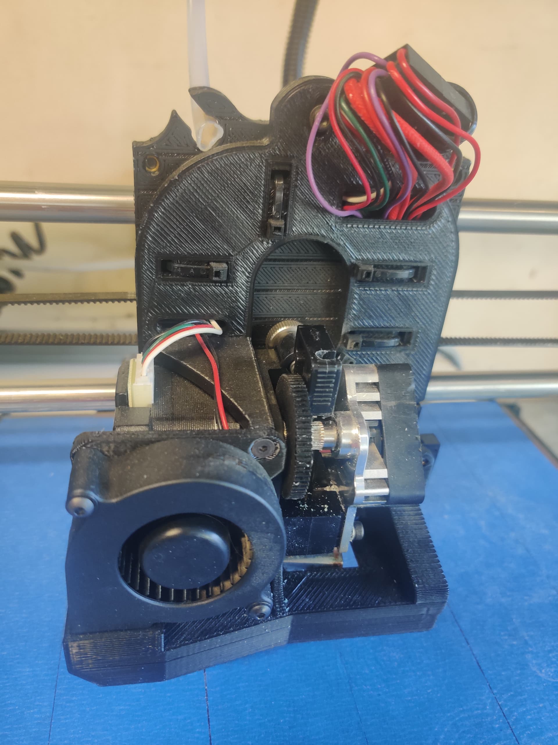

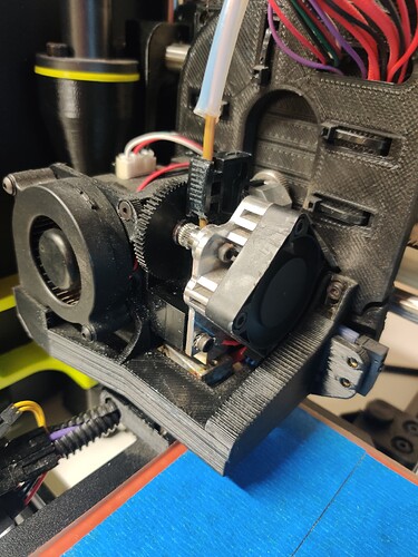

Hello, I purchased a used Taz 6, when adding the printer to Cura (ver 4.13.16), and trying to connect, I get an error that states “Wrong Tool Head Detected!..”. Unfortunately, I don’t know what tool head is on this machine. How do I find out what it is?
From the pics below are you able to help me figure out what setting to select, if not the default “Single Extruder”.

That is the [Aerostruder](https://mm.digikey.com/Volume0/opasdata/d220001/medias/docus/44/TAZ_Aerostruder_Tool_Head_Web.pdf), LulzBot part number KT-CP0128-0405.
**Post date:** [June 16, 2025, 1:49pm UTC](https://forum.lulzbot.com/t/identifying-tool-head-on-used-taz-6/27608/3 "2025-06-16T13:49:21Z")
Original Aerostruder head.
> **[OHAI: Open Hardware Assembly Instructions](https://ohai.lulzbot.com/project/taz-aerostruder-assembly/hot-end-tool-head-assembly/)**
It’s an old legacy (no-longer supported) toolhead in modern firmware, as they switched to mirrored Titan Aero-based extruders in the SE 0.5, SL 0.25, HE and such, so that the tension knob would be accessible instead of pressed against the mounting plate.
It should operate fine as the SE 0.5, but you may need to activate and use [the M206 command](https://marlinfw.org/docs/gcode/M206.html) in order to position the nozzle in the correct position to wipe and level correctly.
