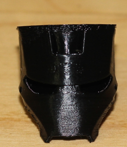

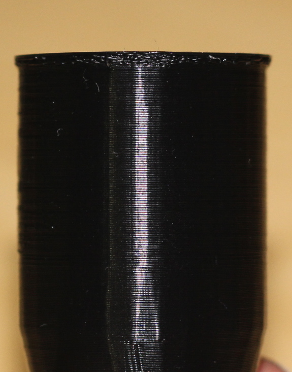

Sorry If this is a super noob issue but I wasn’t able to find a solution in the forums from searching.
I’m having an issue where the first 10 or so layers of a print are kind of messed up. They look almost semi melted and not perfect lines. However its not a problem anywhere else in the print other than those first few lines. Does anyone what might be causing this? I dont believe this was an issue when I first started printed but has become more pronounced.
Just in case it helps I’m using eSun PLA with extruder temperature at 200 and the bed at 65.

Does it go through the bed leveling ok? Sounds as if the nozzle is not close enough or its too close to the bed. A picture sometimes is worth a 1,000 words 😃

It does seem to be doing the auto level process. Here are a few pictures of the issue.

**Post date:** [December 25, 2015, 4:50pm UTC](https://forum.lulzbot.com/t/initial-layers-mis-printing-problem/2671/4 "2015-12-25T16:50:04Z")
You are either too close to the bed at start and need to change your Z offset amount setting in Cura, or you are overextruding at start slightly due to an incorrect filament diameter set in Cura.
Edit: you may also be getting some lifting of the part off the bed, increase the bed temperature by 5 degrees.
**Post date:** [December 25, 2015, 6:08pm UTC](https://forum.lulzbot.com/t/initial-layers-mis-printing-problem/2671/5 "2015-12-25T18:08:45Z")
To amplify what piercet said, you find the setting he is talking about in Cura by selecting “machine” from the top level menu, then “machine settings” and adjusting the “Z-Offset” in the popup. Raise is positive, lower is negative. You might want to try raising it 0.1 mm at a time to see if it improves matters.
