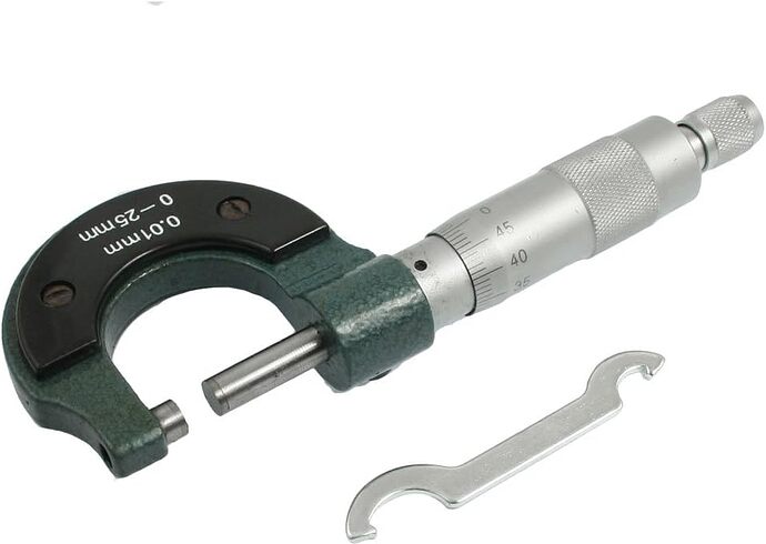

> Also make sure your first layer height is spot on. If your first layer is set to .2mm, then print 1 layer, let cool, peal and measure with a caliper to verify the thickness. I can not stress this enough and it will eliminate a lot of issues. Not only for PEI bit for every print surface and printer!
Best advice out there when first starting to print in general. I would recommend using a micrometer to measure filament and 1st layer height. A caliper that is ±0.1mm does no good-- a measured 0.1mm layer could actually be anywhere from 0.2mm to 0.0mm thick!
> **[Amazon.com: uxcell® 0-25mm Outer Mesuring Micrometer Caliper Measure Tools...](https://www.amazon.com/uxcell%C3%82-Mesuring-Micrometer-Caliper-Measure/dp/B00AO9J43G)**
> Buy uxcell® 0-25mm Outer Mesuring Micrometer Caliper Measure Tools 0.01mm Grad.: Vernier Calipers - Amazon.com ✓ FREE DELIVERY possible on eligible purchases
$15 investment and it is within ±0.01mm–I double checked it with some fancy calibration cubes that are ±0.0005mm. Best part is unlike the digital ones it still works after the battery dies 😃

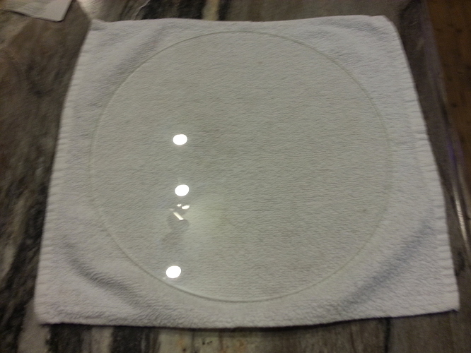

- **Step 1)** Clean your print bed with alcohol and water. I have a round borosilicate glass for mine, but you may be using some other material.

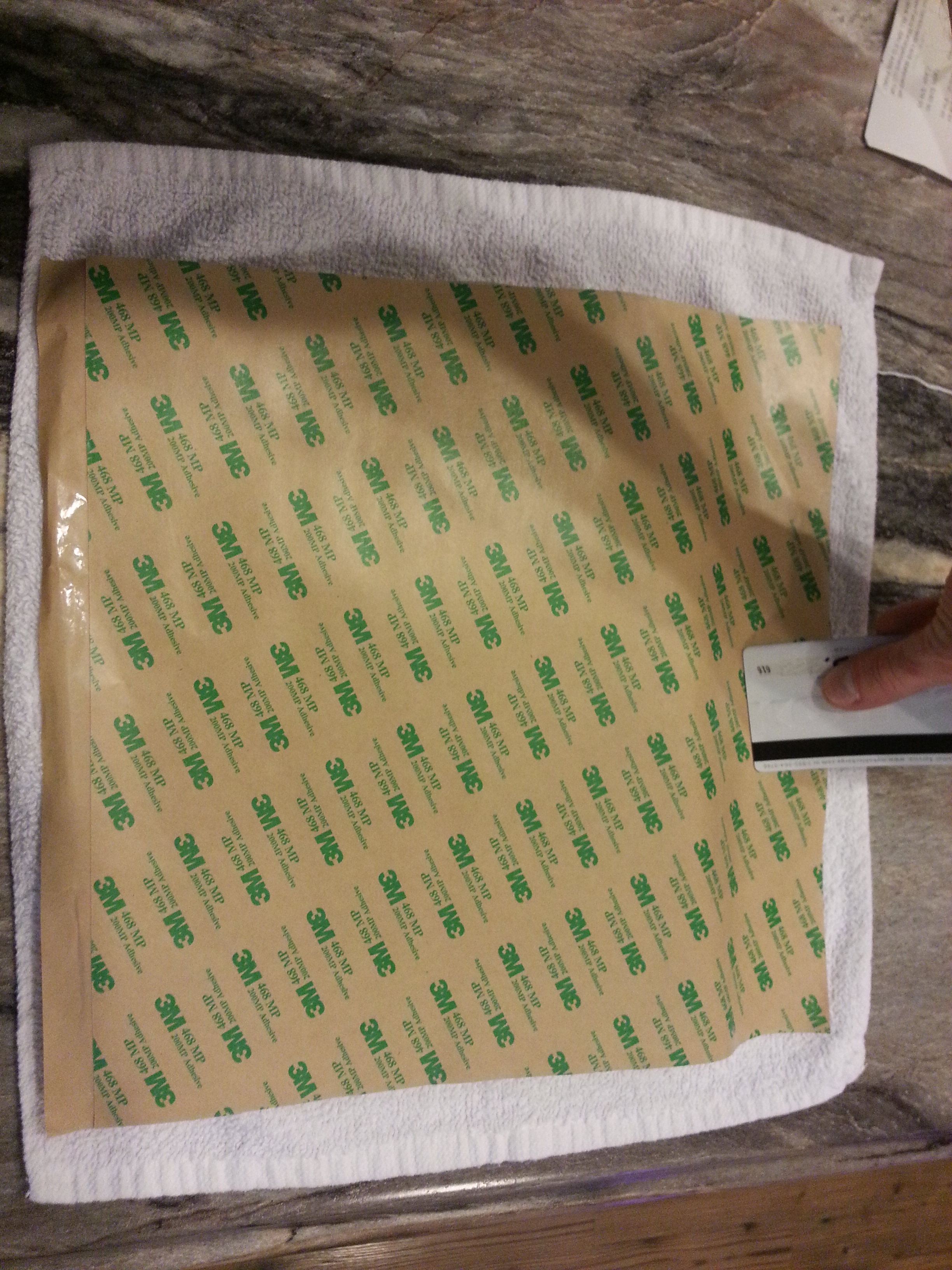

**Step 2)** Pick and edge and start applying the double stick tape. Do your best to center the sheet, my 12x12 piece didn’t quite fit my Rostock Max print bed
 ![Step2_20150423_075135.jpg](https://us1.discourse-cdn.com/flex020/uploads/lulzbot/original/2X/b/b7ac11b1cf464e013d4aed027fb067bb367b851f.jpeg)
**Step 3)** Using an credit card or some other plastic squeegee, work the air bubbles out from under the sheet of double stick tape. Work left to right more than pushing from the edge toward the curl to prevent creases.
 ![Step3_20150423_075202.jpg](https://us1.discourse-cdn.com/flex020/uploads/lulzbot/original/2X/6/6d5d8abff73c992746c0348c78b7b2b34eba4773.jpeg)

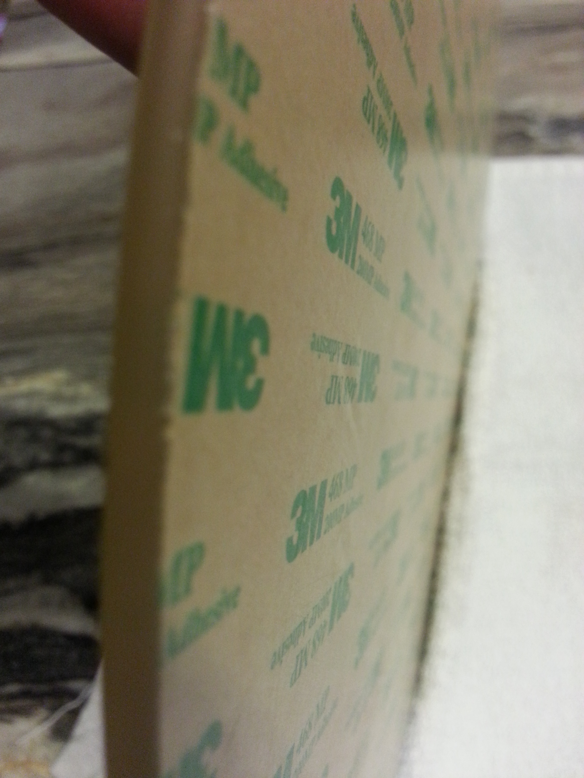

**Step 4)** Continue to squeegee the sheet of adhesive tape down. Try to work the bubbles out as they appear.

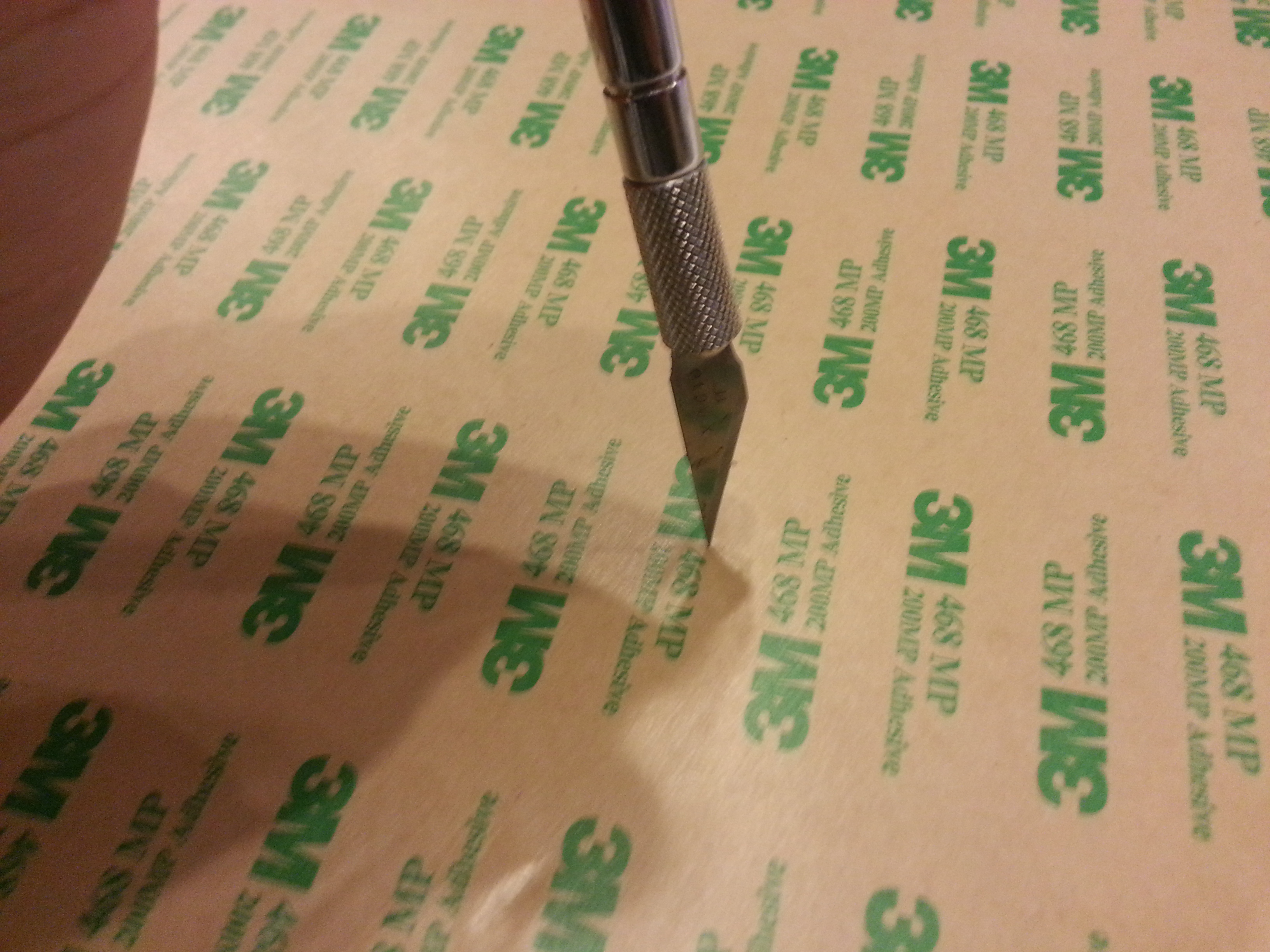

**Step 5)** Once the double stick tape is all applied, use an exacto knife to trim the excess. **_Be careful._**

- **Step 6)** It’s important to angle the exacto blade just so it skims the edge of the glass. Peeling away the excess with your other hand will help your knife glide smoothly.

**Step 7)** Inspect the double stick tape for any missed air bubbles. Look down the edge of it too see any overlooked bubbles.
