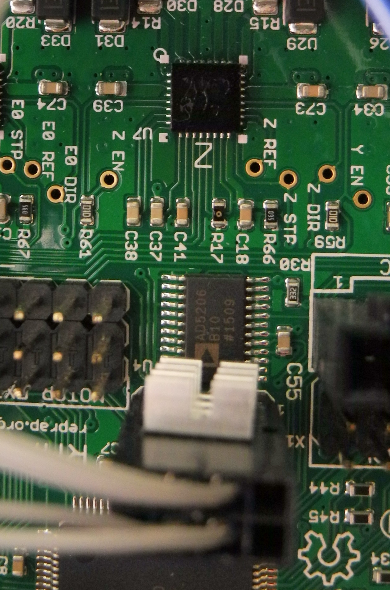

**Post date:** [April 16, 2016, 12:43pm UTC](https://forum.lulzbot.com/t/is-it-supposed-to-do-this/3304/6 "2016-04-16T12:43:55Z")
The heat sink on the Z driver may have fallen off, which I read happened to a Mini owner a week or two ago. That would cause the chip to over heat from the load on it and start dropping steps. AKA - drag the head on the print and snap the carriage.

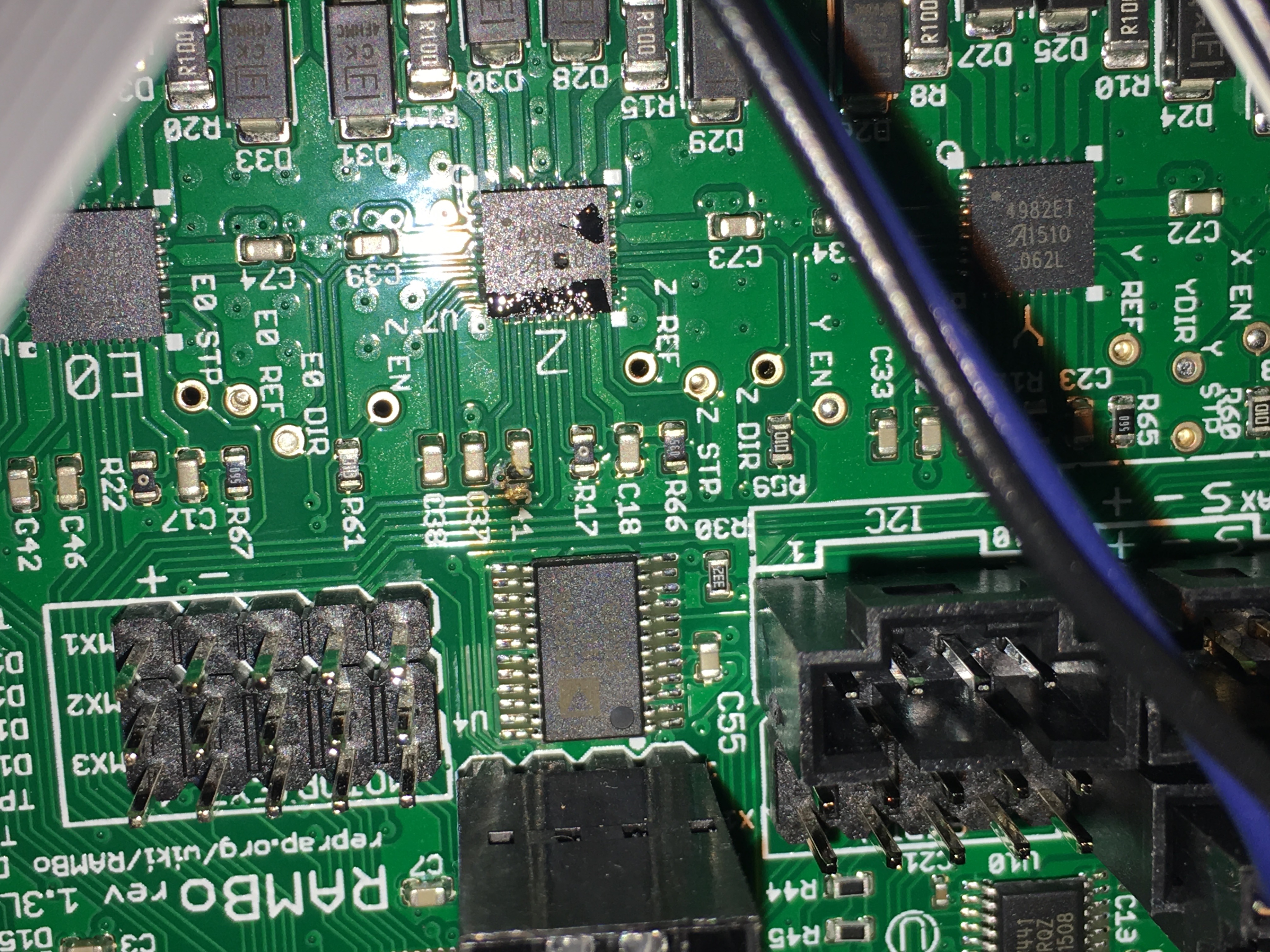

**Author:** ![BHivelabs](https://avatars.discourse-cdn.com/v4/letter/b/a87d85/32.png) [@BHivelabs](https://forum.lulzbot.com/u/BHivelabs)\
**Post date:** [April 16, 2016, 1:48pm UTC](https://forum.lulzbot.com/t/is-it-supposed-to-do-this/3304/7 "2016-04-16T13:48:41Z")
Thanks for the head’s up. It looks like that is exactly what has happened. We didn’t have a heatsink on Z, we had one stuck to the LCD SPI connector beneath the controller chip.

**Post date:** [April 16, 2016, 4:25pm UTC](https://forum.lulzbot.com/t/is-it-supposed-to-do-this/3304/9 "2016-04-16T16:25:45Z")
The heat sink fell off the Z stepper driver of my Mini. Result was missed Z steps and a messed up print, but fortunately no machine damage.
I just don’t think the adhesive pads on those heat sinks are up to the task, given the vertical orientation of the board. They work fine for VRAM on video boards, but video boards don’t shake/vibrate like a 3d printer doing fast infill.
So I cleaned off the adhesive and used Arctic Silver Alumina thermal epoxy to remount it. I also added sinks to the X and Y chips while I was there. Probably not needed, as I think Z gets much hotter due to driving two steppers.
**Author:** ![LanceHS](https://sea2.discourse-cdn.com/flex020/user_avatar/forum.lulzbot.com/lancehs/32/9347_2.png) [@LanceHS](https://forum.lulzbot.com/u/LanceHS)\
**Post date:** [April 16, 2016, 11:55pm UTC](https://forum.lulzbot.com/t/is-it-supposed-to-do-this/3304/10 "2016-04-16T23:55:14Z")
I purchased a TAZ 5 in December 2015 and ran into the same Z axis issue during a print. At one point, turning the printer off and then back on, there was a loud pop and spark from the controller box. A quick look uncovered a dislodged Z driver heat sink that caused a short. Lulzbot support was great and they sent me a replacement printer. I wonder how prevalent this issue is?
