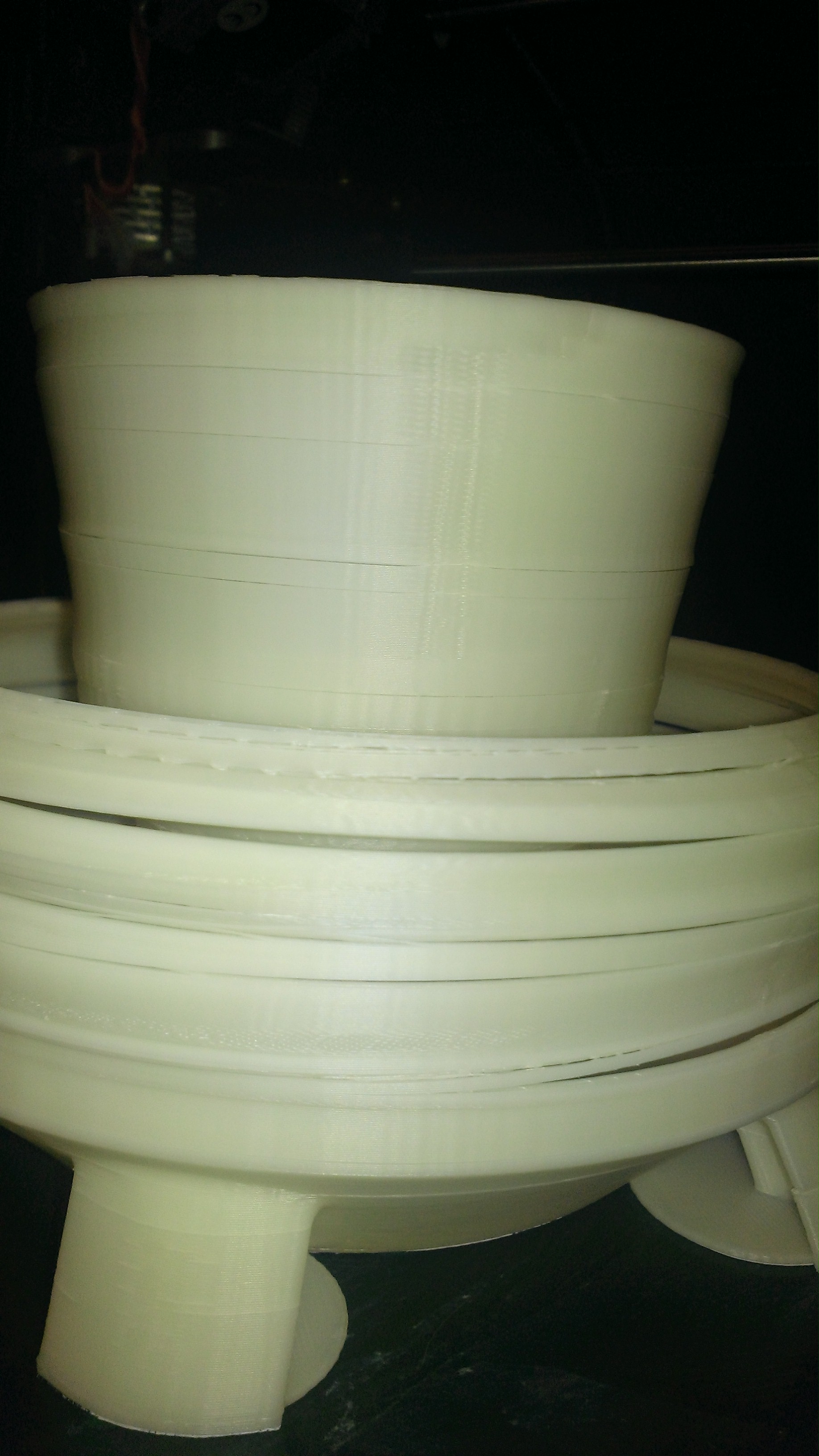

I’ve been having a tough time with layers separating on some prints (really anything taller than a few mm). My current project is a planter that is tall with thin walls (about 2mm thick).
 ![pot1.jpg](https://us1.discourse-cdn.com/flex020/uploads/lulzbot/original/1X/34df5fbd5e53f58646e862c6eef5c3b86daf761d.jpeg)
 ![pot2.jpg](https://us1.discourse-cdn.com/flex020/uploads/lulzbot/original/1X/2f4cc45c80f8776b1bf1007e1d1bb565f409f2f2.jpeg)
I’ve tried nozzle temps of 225, 230, and 232. Temp doesn’t seem to make a significant difference.
I’ve also tried slowing down (esp. on the perimeters). Again not significantly better.

ABS has an inherent tendency to warp when cooling. The larger of an object you print the greater the effect. An enclosure would help, to lengthen the part cooling time (similar to tempering). Printing with HIPS or PLA may be easier, as they do not warp to that extent. A tall skirt may help hold in heat around the outside of the print. You can find that setting in Slic3r at Print Settings \> Skirt and Brim \> Skirt \> Skirt height: and change to ( model height in mm / layer height).

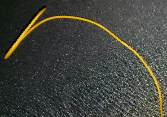

Thank you for the reply. I have more information to report. It appears as though I’m having a feed problem. Anything faster than 100mm/min feed rate is backing up. Even at 100mm/min, I don’t get quite as much extruded as I expect. If I print at 200mm/min, I get very little output, and what does come out is in a tight corkscrew:
 ![corkscrew.jpg](https://us1.discourse-cdn.com/flex020/uploads/lulzbot/original/1X/70cd9babbc823ec9adbc46ae0436f3e28bd42285.jpeg)
it’s hard to see, but the output isn’t the smooth flow I’m used to seeing.
I tighten the tension screws down to about 3.5mm between the washers (very tight), and it didn’t help. I thought I might have a problem with the nozzle, so I swapped the stock .35 with a brand new .50 - same result. Could I be having a problem further up the nozzle? What do I try next?

The hobbed bolt did have a bunch of junk in it after these experiments. I cleaned it out and tried again. Same thing. Feeding with nozzle temp at 237 improved things a bit. Here are some feed rate tests at 237:
20mm @40mm/min = 20mm actual feed
20mm @100mm/min = 19mm actual feed
20mm @300mm/min = 17mm " "
20mm @500mm/min = 16mm " "

If it’s not mechanical. maybe it’s the heater core or the sensor? if the machine thinks your hot end is operating at a higher temperature than it actually is, that could do the trick. Only other thing I can think of is if the hot end itself got hit and is offset to one side or the other now and binding the filliament where it exits the hobbed bolt and goes into the lower extruder hole and enters the hot end. You could be able to see that from the top though, and that would be a bit of a long shot as a problem.

Piercet, you might be on to something. My laser thermometer show 210C when the hotend thinks it is 230C. Admittedly, the beam on the thermometer is a bit wide, so it’s accuracy is questionable, but I went with the highest temp I could measure when aimed at the heater block. Is there a calibration procedure for the hotend temp? If I raise the temp 20C based on my laser thermo, and it’s wrong, then I’ll be melting the PEEK isolator.
I could try to replace the thermistor (100k Honeywell Axial Thermistor, I believe), but I would need to calibrate it.
Orias, I tried your procedure, and nothing apparently off came out. Still, I’ll try another test print to see if it made a difference

The thermistor reads 131.9k at room temp. I think we’re on to something there. What’s the resistance suppose to be when it’s up to temp? I could heat it up, disconnect, and test again.
Either way, a new thermistor is cheap - so a replacement is on the way.

The new thermistor reads 101.8K at room temp, and at the same time the old one shows 111.1K.
