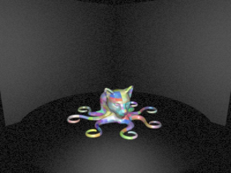

Out of curiosity, I ran a test to see what would happen when the source data was really dirty. In Blender, I added ambient occulusion to the render, and via the node editor, a different noise map is mixed for the scan and bg so theortically none of the pixels are perfectly identical in each image, despite looking similar. To make things interesting, the images are also given a slight gausian blur (prior to application of the noise map), and saved as 90% quality jpegs. I also changed the scanner’s materials so that the inside is matte black, and the lights are much brighter.
I tried a couple of PIL-only methods for dealing with the noise, but the results were unusuable for my purposes.
Here is what I’ve come up with for the code:

Here is the new “scan” data and background reference:
 ![scan.jpg](https://us1.discourse-cdn.com/flex020/uploads/lulzbot/original/1X/39d98ca14f0ccaa6c7d91fa741cc4ac526225eb1.jpeg)
 ![bg.jpg](https://us1.discourse-cdn.com/flex020/uploads/lulzbot/original/1X/3df59b09ec87ae9250756505fab7ae98856073d7.jpeg)
The resulting difference map:
 ![just_diff.png](https://us1.discourse-cdn.com/flex020/uploads/lulzbot/original/1X/62171a86f95b87162fbce51646a2a09d6f6f6855.png)
The resulting mask image:
 ![mask.png](https://us1.discourse-cdn.com/flex020/uploads/lulzbot/original/1X/dafe5c85a4b7726e9d934a27c44c081df0710f7e.png)
**Author:** ![aeva](https://sea2.discourse-cdn.com/flex020/user_avatar/forum.lulzbot.com/aeva/32/2_2.png) [@aeva](https://forum.lulzbot.com/u/aeva)\
**Post date:** [January 31, 2014, 1:55am UTC](https://forum.lulzbot.com/t/lulzbot-3d-scanner/426/11 "2014-01-31T01:55:18Z")
Here it is again, without changing any of the settings, from the upper camera:
 ![scan.jpg](https://us1.discourse-cdn.com/flex020/uploads/lulzbot/original/1X/dd3b6f19ae6a08190d5bc25bc842ec5926be7f99.jpeg)
 ![bg.jpg](https://us1.discourse-cdn.com/flex020/uploads/lulzbot/original/1X/194fdb322ec3fb3d49b0883bc6941cd6cf72469d.jpeg)
 ![mask.png](https://us1.discourse-cdn.com/flex020/uploads/lulzbot/original/1X/4ce463b093845820f875e09575e84f0bb4b9983e.png)
Also, the threshold and noise settings are hard coded - if the object being scanned doesn’t effect this too much, we might be able to get away with just having these values hard coded for whatever makes sense for the scanner.
**[edit]**
Also, here is another version that doesn’t use open\_cv, is faster, and produces somewhat cleaner output:

And the resulting output:
 ![mask.png](https://us1.discourse-cdn.com/flex020/uploads/lulzbot/original/1X/a612a527ff9249e678f011ed28b854fa05bd05f3.png)
**Post date:** [January 31, 2014, 5:29pm UTC](https://forum.lulzbot.com/t/lulzbot-3d-scanner/426/12 "2014-01-31T17:29:13Z")
Out of curiosity this mornining, without tuning the settings, I ran photographic samples through the demo script instead of virtual scans to see what would happen:
 ![scan.jpg](https://us1.discourse-cdn.com/flex020/uploads/lulzbot/original/1X/481ac91b1868a6b1697aa40faa4ae802254dad5d.jpeg)
 ![bg.jpg](https://us1.discourse-cdn.com/flex020/uploads/lulzbot/original/1X/8f59cd74e51bb145e1eb34abceda6654cc0d827b.jpeg)
 ![diff.png](https://us1.discourse-cdn.com/flex020/uploads/lulzbot/original/1X/18e1cabf4a84ec01eb9850094287332fab806244.png)
 ![mask.png](https://us1.discourse-cdn.com/flex020/uploads/lulzbot/original/1X/e10d9b7c715b760362290d4fc7ce090d6b7d94a6.png)
Note that there is distortion below the object because the table’s surface is kind of glossy. The scan interior would likely be either matte black or a (possibly retroreflective) surfacing of a very specific color (eg lime green or safety orange). Translucent objects most certainly will not work unless the background is textured (but that is problematic with using a turn table). Reflective objects might be scannable. It may also be the case that the scanner could have different settings for different types of objects, so that more things are scannable albiet with differening overall quality. Also worth noting that the scanner is planned to be enclosed, not open like most 3D scanners.
I will look to pick up some bright colored construction paper later and try this experiment again later on.
