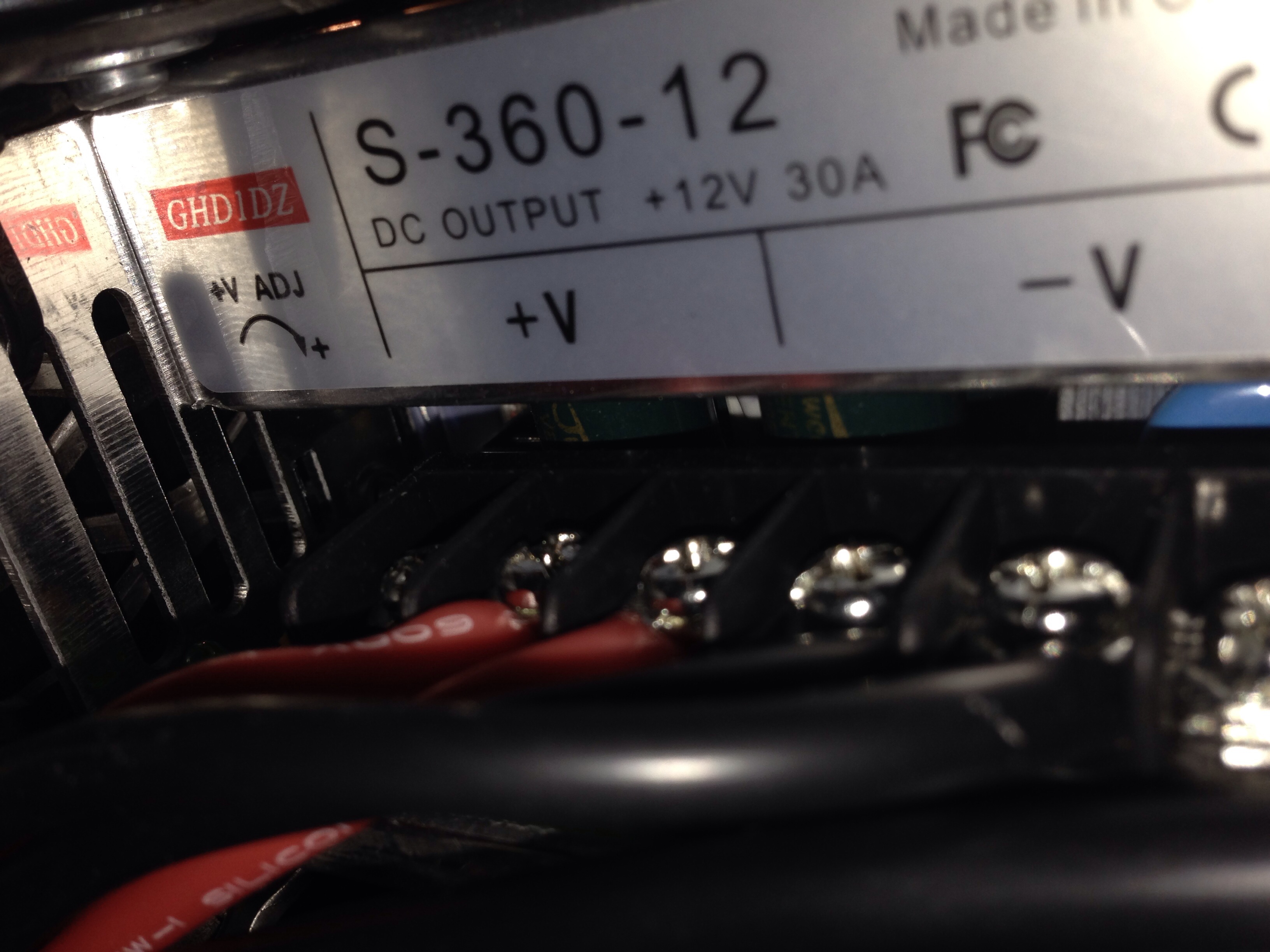

I hooked up the 12v 30a ps and set the adjustment screw so it was reading 12v a couple weeks ago. I set up my ramps 1.4, tested the motors, took another voltage reading and it was now reading 22v-23v (ish). I then tried turning the adjustment screw down, but it would only go as low as 21.

I’ve never heard of a power supply just randomly changing outputs like this before. Are you sure you’ve got the 12v one? It should say on the front of the supply – something like “DC OUTPUT +fooV barA”.
Where was the power supply purchased from? If it is indeed a 12v power supply it certainly should not be outputting close to 24v.
Thanks. Yes at least that’s what it says 12v. (See pic)

Im checking the psu right from the terminals and still getting 21v. I’m sure I had originally set it to 12v with the adj screw a couple of weeks ago.

You need to set your multimeter to DC volts to get a good reading. That’s 4 clicks ccw from the setting in the picture you posted.
cfry9999, this can’t happen. When I say this can’t happen, I mean usually power supplies would burn rather than outputting such a weird voltage. From the picture, you’ve shown, it seems like the multimeter is set to read AC voltages and not DC voltage. Please revisit the whole procedure with configuration of multimeter.
