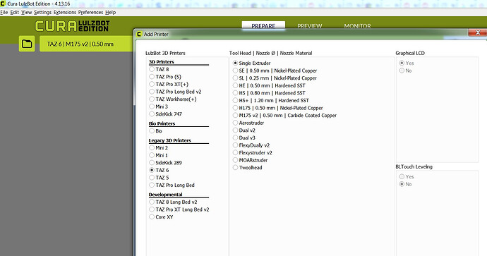

Could be and I had considered this. Although it gives no option on the list pull down list on Marlin or Cura. Just M175v2. In the end, I just had to move the bed. Not ideal at all but sometimes you need to just make it happen. It is working now but after this short foray into printing a little bit of 1.75 I will have to move it back. I have a second printer so I can hold off on the change as long as possible at least.
As a side note, a big thanks to all you guys here. I have often just lurked and used these forums to troubleshoot but never replied or created an account. B-Morgan, your posts have came up a lot and been helpful. Same to you Wrathernaut.
Screenshot of Cura options. Pretty sure H175 isn’t what I want.
 ![image](https://us1.discourse-cdn.com/flex020/uploads/lulzbot/original/2X/c/cee96dd23f1a5ba6164ff17bd870321b8c5d7e1e.jpeg)
**Post date:** [June 12, 2025, 12:39pm UTC](https://forum.lulzbot.com/t/lulzbot-taz-6-m175-v2-head-not-finding-z-home-correctly/23934/10 "2025-06-12T12:39:26Z")
I agree that there is only one choice in CuraLE but, if I remember correctly, there was something about the that only being for the 2.1 version.

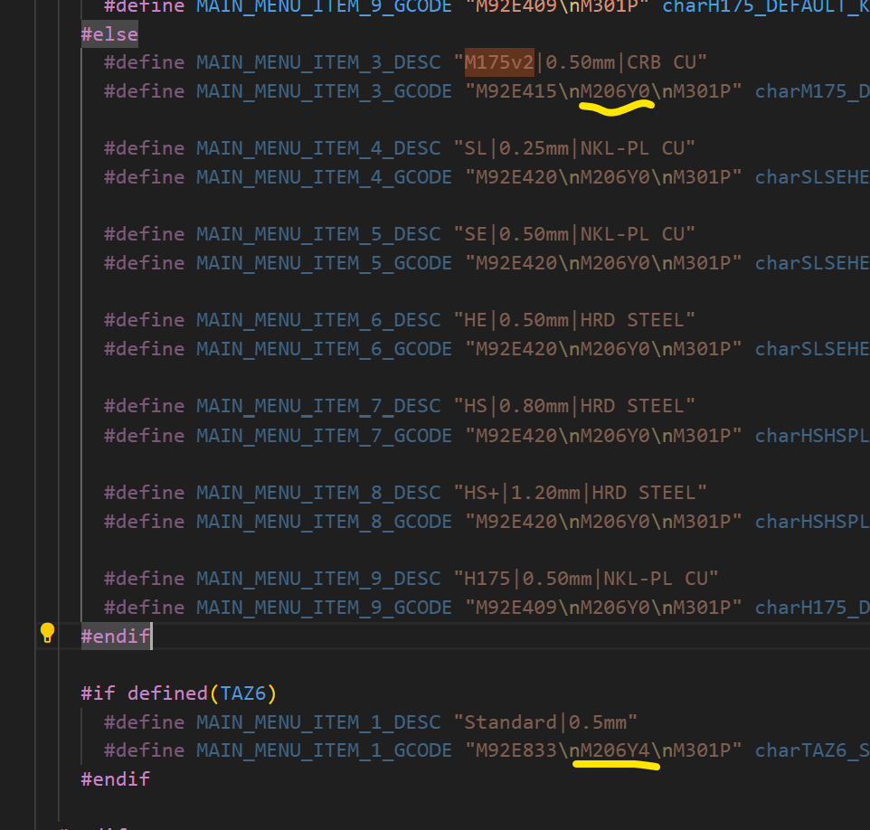

@Silentelk you can put your nozzle offset adjustments into an [M206 command](https://marlinfw.org/docs/gcode/M206.html). There used to be M206 commands in the toolhead change macros accessed in the menu:
 ![image](https://us1.discourse-cdn.com/flex020/uploads/lulzbot/original/2X/5/5bc04d4d05ad864d4f9e4147d4d92cbaa7f70ee4.png)
The M206 commands don’t appear to be in there anymore (neither is the Single Extruder for that matter):
 ![image](https://us1.discourse-cdn.com/flex020/uploads/lulzbot/original/2X/d/d575802f7cb08694adbfc15e7ff217c326f2634b.png)
Since all **supported** machine/nozzle combinations are in the same position now, there’s no need for the M206 commands in the shared code used for the toolhead menu.
The Taz 6, being a legacy printer now, isn’t officially supported, so putting M206 in is up to us.

Interesting. What file to get to the one you have shown? I have looked through a bunch of the Gcode files but nothing appears to show what you there. My understanding is the solution (for me at least) would be to change MAIN\_MENU\_ITEM\_3\_GCODE from "M92E409\nM409\nM206Y0\ to nM206X-14Y4 Am I correct? This would reorient the home position for the printers back about 14mm. That would reorient just that printer head (m175) location (assuming I just modified the file under Taz 6 file) whenever that tool was selected?
I know just enough to be dangerous but not enough to really have a clue haha. To an extent I understand Gcode but I have haven’t to modified it quite this way. 20 years ago I used to program a large 5 router with a 10 ft x 5 ft x 3.5 ft envelope. Was a fun job for 10 months until the company went out of business. Mainly A/B axis changed (wandered slightly) become the machine had 2 degree’s of play. Whenever the machine plan changed machining planes I would insert a stop and then calibrate the newest offset and incorporate it so it would all line up to previous surfaces. But that was 20 years ago and I didn’t change the parameters of the machine or software other than search and edit. And that was 20 years ago…
**Post date:** [June 17, 2025, 2:46pm UTC](https://forum.lulzbot.com/t/lulzbot-taz-6-m175-v2-head-not-finding-z-home-correctly/23934/13 "2025-06-17T14:46:16Z")

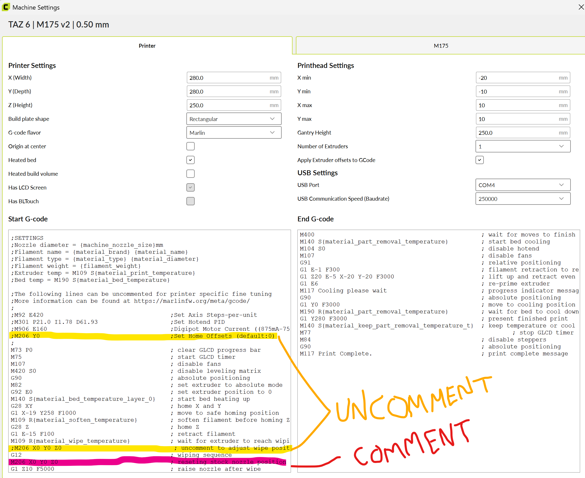

This is part of the code that gets compiled into the firmware. You could recompile it to do that, but if that’s your only change, it’s not worth the effort.
Just put the M206 corrections into the startup GCODE in CuraLE.
Uncomment by removing the semicolon from the start of the line, then put your M206 corrections in.
Comment out the “reset” M206 command by adding a semicolon at the beginning of the line.
 ![image](https://us1.discourse-cdn.com/flex020/uploads/lulzbot/original/2X/6/62019b1bbe370440d2a4db0586324180912564b0.png)
