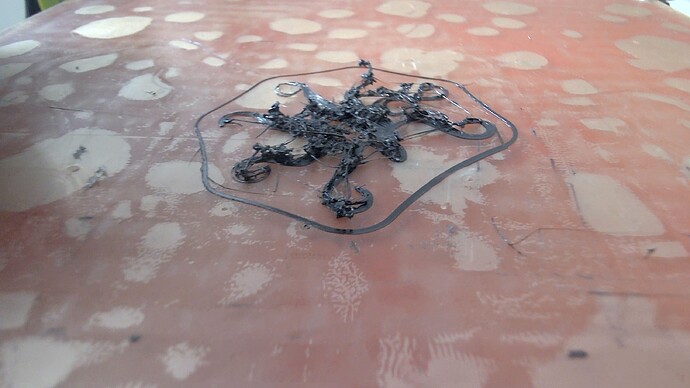

Lately, my prints have been coming out extremely stringy and hairy. They would only print halfway, and when I try to get the mess off the build plate, it won’t come off. Before this, it was not printing at all. only half of the outer ring it makes was printing. I have tried multiple filaments; none work. Some prints, it prints part of it ok, and the rest is just a stringy mess. Does anyone know how I can fix this?
 ![WIN_20240515_12_03_44_Pro](https://us1.discourse-cdn.com/flex020/uploads/lulzbot/original/2X/8/8146cc81a10999d07a9411a733cfcc13266b068d.jpeg)
**Post date:** [May 15, 2024, 4:39pm UTC](https://forum.lulzbot.com/t/lulzbot-taz-6-prints-coming-out-extremely-messy-and-hairy-and-wont-come-off-build-plate/26667/2 "2024-05-15T16:39:17Z")
Nozzle is too close to the bed.
![image](https://us1.discourse-cdn.com/flex020/uploads/lulzbot/original/2X/8/8ff8b9e71240b6a9e4e7f90d908c34f570e34c1c.png)
 ![image](https://us1.discourse-cdn.com/flex020/uploads/lulzbot/original/2X/0/0b11a7a01d12fd96851a39f0880fba14e83f2235.png)
If you haven’t been doing any adjustments to the Z offset, it’s almost certainly because your nozzle is not actually clean. It’s imperative that the nozzle be spotless for the bed leveling to work right. If there is _any_ visible movement of the bed when the nozzle touches a corner, the print will end up like this one.
The nozzle wipe before a print should be only considered a dust removal. It’s not very good at removing plastic, especially PLA.
Additionally, the bed should be very clean, with maybe a bit of PVA gluestick on it.
The Z offset should be around -1.25 to -1.32 for the PEI coated bed.

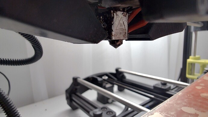

I did everything you said still getting this:
 ![WIN_20240515_14_58_48_Pro](https://us1.discourse-cdn.com/flex020/uploads/lulzbot/original/2X/4/473f15a571e9224d5c96ab6b68ab9de07de62a87.jpeg)
**Post date:** [May 15, 2024, 7:49pm UTC](https://forum.lulzbot.com/t/lulzbot-taz-6-prints-coming-out-extremely-messy-and-hairy-and-wont-come-off-build-plate/26667/4 "2024-05-15T19:49:25Z")
It’s still mashed into the bed, raise the Z offset by about .05mm - 0.1mm
Clean the hell out of the nozzle too. The factory nozzles are not soft brass, so you can really clean them before the probing. If there’s any plastic visible in your scrub pad, (especially PLA) it can re-deposit on the nozzle during the wipe, so ensure that’s not a source of contamination.
The skirt looks almost ok, because there’s room on two lines for filament to push outward, but once you get to the lines that are three or more thick, it can only go up, where it catches the nozzle on subsequent passes, or sticks to the nozzle.

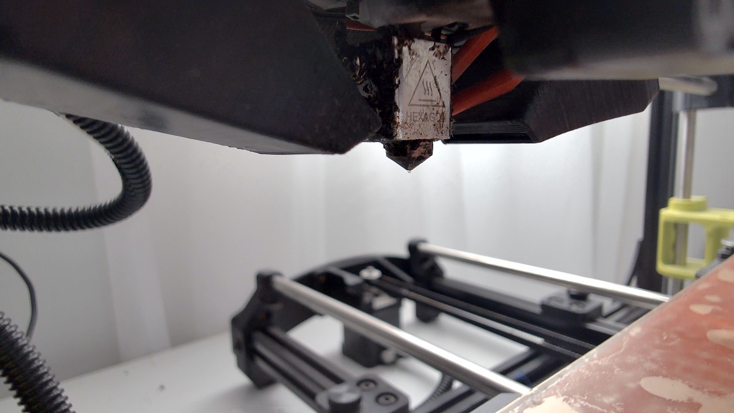

My z axis motors are working now but my prints are still like this:
 ![WIN_20240529_21_49_57_Pro](https://us1.discourse-cdn.com/flex020/uploads/lulzbot/original/2X/f/ff58aac26cc9ea6a3ab2969874088fea0de7eb05.jpeg)
 ![WIN_20240529_21_50_14_Pro](https://us1.discourse-cdn.com/flex020/uploads/lulzbot/original/2X/d/df06375e3a6521705012aef536abffece181031b.jpeg)
**Author:** ![hatchet](https://sea2.discourse-cdn.com/flex020/user_avatar/forum.lulzbot.com/hatchet/32/13550_2.png) [@hatchet](https://forum.lulzbot.com/u/hatchet)\
**Post date:** [May 30, 2024, 2:03am UTC](https://forum.lulzbot.com/t/lulzbot-taz-6-prints-coming-out-extremely-messy-and-hairy-and-wont-come-off-build-plate/26667/11 "2024-05-30T02:03:24Z")
Also forgot to mention. This started happening after I flashed new firmware. I have tried slowing down the build speed it didn’t work.

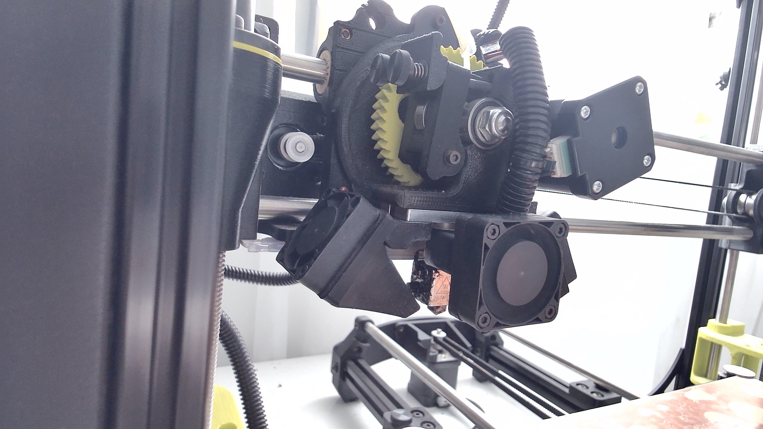

I’m not sure what my toolhead is because the printer was given to me but I think its probably the standard one I don’t think they made many changes to the printer.
**Post date:** [May 30, 2024, 12:13pm UTC](https://forum.lulzbot.com/t/lulzbot-taz-6-prints-coming-out-extremely-messy-and-hairy-and-wont-come-off-build-plate/26667/14 "2024-05-30T12:13:27Z")
Please attach a picture of your toolhead so we can help you identify which one you have.
**Post date:** [May 30, 2024, 12:49pm UTC](https://forum.lulzbot.com/t/lulzbot-taz-6-prints-coming-out-extremely-messy-and-hairy-and-wont-come-off-build-plate/26667/15 "2024-05-30T12:49:37Z")
![WIN_20240530_08_43_18_Pro (2)](https://us1.discourse-cdn.com/flex020/uploads/lulzbot/original/2X/1/19de806e0bc2e97f21eec91acf51fa6c7bc2c150.jpeg)
 ![WIN_20240530_08_43_03_Pro](https://us1.discourse-cdn.com/flex020/uploads/lulzbot/original/2X/d/d5348d382ee1a2b7e6de3446e1320da101736b4b.jpeg)

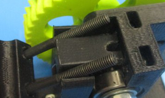

**Post date:** [May 30, 2024, 2:29pm UTC](https://forum.lulzbot.com/t/lulzbot-taz-6-prints-coming-out-extremely-messy-and-hairy-and-wont-come-off-build-plate/26667/16 "2024-05-30T14:29:49Z")
That’s the Taz6 Standard Extruder (not to be confused with the SE).
They use a hobbed bolt to drive the filament, so the extruder steps is a little different for each one. It should be on a sticker on the back plate of the extruder, or you can measure it yourself. It should be what is loaded as the default toolhead with new firmware. The default steps/mm should be close enough to get a print better than what you have there.
But the toolhead is not great at pushing PLA, it has a tendency to strip (grind) PLA. Open the idler arm and send a picture of your hobbed bolt’s teeth. Any stripping clogs them, leading to more stripping… leading to more clogs and underextrusion.

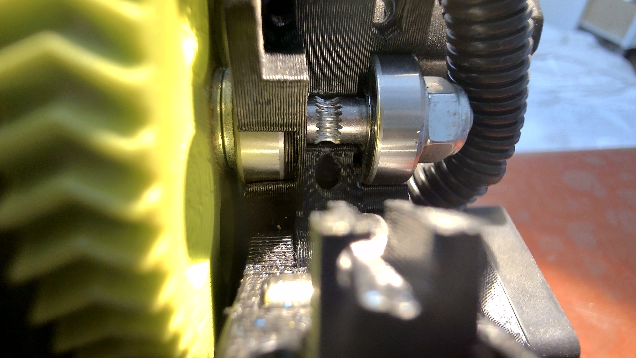

**Post date:** [May 30, 2024, 3:08pm UTC](https://forum.lulzbot.com/t/lulzbot-taz-6-prints-coming-out-extremely-messy-and-hairy-and-wont-come-off-build-plate/26667/17 "2024-05-30T15:08:21Z")
![WIN_20240530_11_04_53_Pro](https://us1.discourse-cdn.com/flex020/uploads/lulzbot/original/2X/f/f738e156517bba39443a1623920628072ad066fa.jpeg)
**Post date:** [May 30, 2024, 3:27pm UTC](https://forum.lulzbot.com/t/lulzbot-taz-6-prints-coming-out-extremely-messy-and-hairy-and-wont-come-off-build-plate/26667/18 "2024-05-30T15:27:36Z")

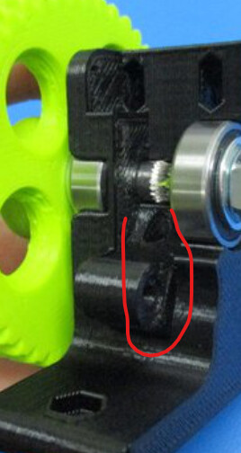

Not enough pixels to really tell condition of the teeth in there, but based on the condition of the guide, you’ve got some serious wear going on.
![image](https://us1.discourse-cdn.com/flex020/uploads/lulzbot/original/2X/2/2163417b94d713e7ea4253c2b908a92b13408aa8.jpeg)
New:
 ![image](https://us1.discourse-cdn.com/flex020/uploads/lulzbot/original/2X/2/2d87d45856eb830fcbd1d502991c18a99cab1b43.jpeg)
There may be other wear in the filament guide that’s making it easier for the filament to avoid the gears as well. Check this area:
 ![image](https://us1.discourse-cdn.com/flex020/uploads/lulzbot/original/2X/c/cabd6d1ddcc0a8dc3cc0fa25982321e700af9159.jpeg)
I’ve seen it worn enough that there was a groove in the side of the top of the heatsink before, so check the entire filament path.
