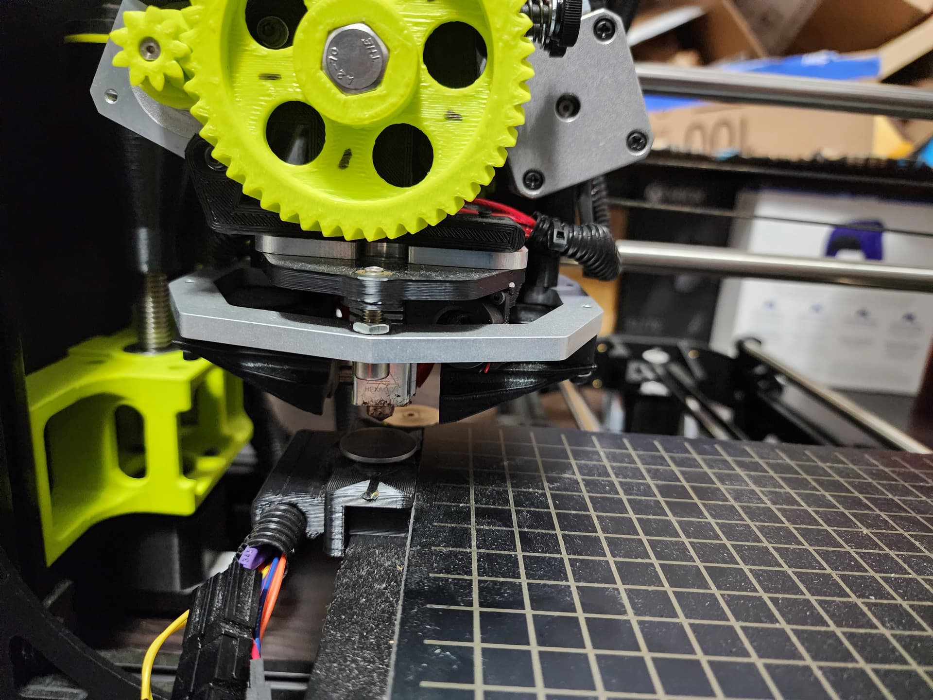

Hello. I got a Lulzbot Taz 6 that didn’t work and I’ve been trying to fix. I have a Taz 6 with a dual extruder v2 head on it. When I tried to print some gcode using Cura for lulzbot version 3.6.37 it was always failing to probe the bed. It would try to wipe the nozzles and the print head would go too low into the wiping pad and scraping the edges of the pad holder, then when it goes to probe the print head it would fail as the nozzle would touch the bed and not the bed leveling washers.
I then tried updating the firmware using Cura to TAZ 6 dualextruderV2 1.1.9.34 and now when I try printing, the printer tries to wipe the nozzle where the z-min switch is, and not where the wiping pad is. I tried flashing an older firmware 1.1.9.28 from the lulzbot website and still the same problem. Even tried the 2.0.0.174 firmware, same problem. The nozzle wipes over the z-min switch and not the wiping pad, and then I get bed leveling failed.
Anyone know how to fix this?
**Post date:** [March 11, 2023, 1:17pm UTC](https://forum.lulzbot.com/t/lulzbot-taz-6-wiping-nozzle-over-z-min-switch/25453/2 "2023-03-11T13:17:27Z")
Please post a picture of the tool head. Do you have any other tool heads? Hopefully, you have the Single Extruder V2.1 that was the standard tool head shipped with the printer. If you have it, have you successfully printed with it?
The Dual Extruder V2 has the two nozzles back to back (second nozzle offset in Y by -50 mm). The Dual Extruder V3 has the two nozzles side by side (second nozzle offset in X by 13mm).
I have both dual extruders for my TAZ 6 but my V2 is boxed up. I don’t remember what firmware version worked with it. I’ll get it out and see if I can make it work once we verify that everything else is working on your TAZ 6.
Can you also slice something simple like a 5x5x5mm cube and post the gcode produced? Maybe slice two of them side by side in two different colors.

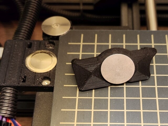

Hi. Here are some photos of the tool head
 ![20230310_222803](https://us1.discourse-cdn.com/flex020/uploads/lulzbot/original/2X/3/3df1b579db9b7783a7b9d22130f3ba43c406bf88.jpeg)
I got the printer from school cause it wasn’t working and they were going to throw it out. I was going to see if I could fix it up and keep it for personal use. I’ll ask if they have the original tool head laying somewhere and if they do I’ll use that because I really don’t care about dual extrusion. I only want to do single extrusion with this dualextruderV2 tool head, and don’t want to spend $300+ for a new single extruder when I’m not even sure if I can get this printer to work properly.

It does look like from your pictures that there is an adapter plate over the Z-min switch. Am I right?

Hi. Yes I do have that adapter on. I removed the adapter but still get the same problem. It wipes the nozzles over the z-min switch area and ends the print with probing failed.
