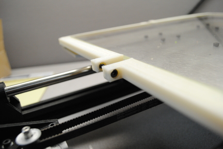

The fans on the DC will indeed hit the bed fingers on the right side of the printer, as can the E1 head on the front left. To solve this problem, I developed and alternative bed corner design that needs no fingers, but instead squeezes the glass on all sides to hold it tight in place. See the Corner Squeezer Bracket STL attached. These require 4 M3 x 14 screws and 4x M3 brass heat inserts. I have been running this full time for about 2 months without any issues.

Looking at the STL, I see what looks like 1 of four corners with 3 holes in it. How does that square with 4 screws and 4 inserts? Could you post a photo of your machine with the gripper installed?

Hell Keith,
Certainly! I should have done that sooner. See those photos here. I have just a bare piece of glass in there at the moment. It has leveled like a charm just like the standard bed corners so far.
 ![DSC_0001-1.JPG](https://us1.discourse-cdn.com/flex020/uploads/lulzbot/original/2X/6/6fe15cd5ef742cf0cc9603ac3d3b666203b259f2.jpeg)
 ![DSC_0001-2.JPG](https://us1.discourse-cdn.com/flex020/uploads/lulzbot/original/2X/1/117dce65acf40a9d9a1f704e6b679b8a20fb7aee.jpeg)
 ![DSC_0001-3.JPG](https://us1.discourse-cdn.com/flex020/uploads/lulzbot/original/2X/a/aa4b36fdae9bbdd3dfdc33e267948012b50aa656.jpeg)
 ![DSC_0001-4.JPG](https://us1.discourse-cdn.com/flex020/uploads/lulzbot/original/2X/3/3ad9e6f54e6383fa744125dacbc3962a2dcc74b1.jpeg)
Also, it looked like that last file I uploaded was indeed incomplete. See the correct file here.
[150121CornerSqueezerBracket3x3.stl](https://forum.lulzbot.com/uploads/short-url/ziPOYsO7UUmNicvnLvAdAMCl6I4.stl) (407 KB)
