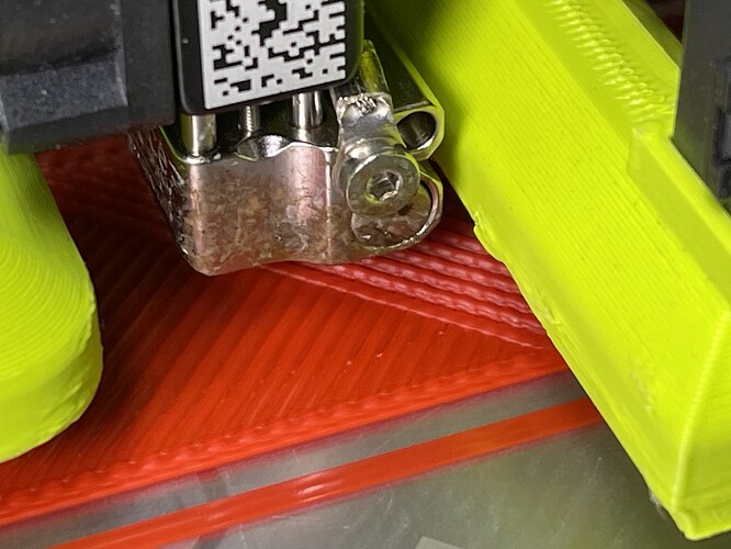

I used the universal adapter, updated the firmware and start with a simple flow test cube.
Right away I noticed the bottom (4 layers) were pretty gappy. I fine tuned the z offset on the first layer and decided to do another test. I long rectangle 4 layers tall just to make sure the z offset was good. A rectangle gives you way more room to see and tweak as you go
What’s weird is the subsequent layers were very gappy. I have a 0.8 nozzle in there and the flow cube sides all came up to 0.85mm, so flow was knocked down to 94%.
I’m a bit stumped why layers 2-4 are so bad.
 ![IMG_7012](https://us1.discourse-cdn.com/flex020/uploads/lulzbot/original/2X/9/90ae797c9f1da78beba547444e15abc43136bdb8.jpeg)
Layers are 0.25 layer resolution, Polymaker PLA Max.
The only other things I changed were some retraction values (0.8 distance and 35mm/s which are inline with what Bondtech & Slice suggest).
I figured I’d pose the question here before tweaking anything else. Latest Cura LE.

I run the default 0.5mm bridgemaster nozzle on my Taz6/M175v2, but I’m also using BLTouch and Octograb, would would affect the first few layers most.
0.25 layer height is a little smaller than what I’d run with a 0.8mm nozzle. For calibration, I’d say 50-75% nozzle width is a good height to work with. I calibrate my .5mm nozzles on a .35 layer height.
You can mask underextrusion on the first layer by manipulating the Z offset, so that layer is not a good measurement for adjusting flow on at all. The masking effect would fade away more each subsequent layer, so if that’s your problem, it is why it would only start to show up at later layers.
I would return flow to 100%, up the layer height to 0.6mm, dial in the Z offset, and do some one and two-layer tests. Post up the top and bottom side with good side lighting, and we’ll go from there.

You changed the slicer to 0.8mm nozzle right? Not trying to insult your intelligence! It just looks underextruded and that would do it.
### Author: ![WhereNerdyIsCool](https://sea2.discourse-cdn.com/flex020/user_avatar/forum.lulzbot.com/wherenerdyiscool/32/11794_2.png) [@WhereNerdyIsCool](https://forum.lulzbot.com/u/WhereNerdyIsCool)
#### Post date: [April 30, 2024, 12:41am UTC](https://forum.lulzbot.com/t/m175-on-the-taz-6/26600/7 "2024-04-30T00:41:47Z")
Well I don’t see a spot to change the nozzle since, just the bead width.
#### Post date: [April 30, 2024, 12:42am UTC](https://forum.lulzbot.com/t/m175-on-the-taz-6/26600/8 "2024-04-30T00:42:31Z")
Oh crap - you know what, I bet it is set in Machine Settings / M175 tab I’ll check
#### Post date: [April 30, 2024, 12:45am UTC](https://forum.lulzbot.com/t/m175-on-the-taz-6/26600/9 "2024-04-30T00:45:44Z")
Yep - it was set to 0.5 !
Fixed

Here’s layer two going down. Still have that gap going on. Still debugging.
@zenotek Of course I assumed this was set without even asking. Good catch!
@WhereNerdyIsCool I assume you’re using a Slice nozzle? The flat of their 0.8 nozzles is 1.4mm by my slightly scientific measurements:
 ![image](https://us1.discourse-cdn.com/flex020/uploads/lulzbot/original/2X/b/bfbbee766ca056ad746ec0136159c762af2d7d41.png)
So ensure your line width isn’t wider than that.
