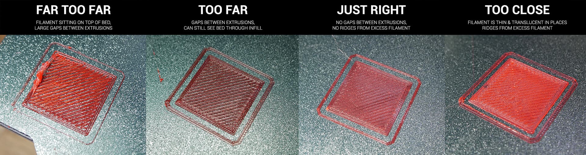

Yeah this one is very intriguing.
As I adjust the Z offset, i go from big ridges of material to gaps in lines on the first layer.
I have a long rectangle test print I like to do. That gives me plenty of time to make some changes while printing and seeing how it is going.
I’m printing at 210C and as I mentioned, mostly defaults.
As I start the print, it looks as though I am printing too close as the beads smoosh out the material to the sides, causing those tall ridges. As I slowly bring the nozzle away, trying to get that smoother layer, I can start to see the gaps between lines.
To those following along and wondering what we’re trying to dial in, here’s a graphic I grabbed elsewhere
 ![firstlayer2](https://us1.discourse-cdn.com/flex020/uploads/lulzbot/original/2X/0/04a8df20f3cf55040cee8175762bd2ed83231a4e.jpeg)
I seem to be either at Too Far or Too Close. I’m struggling for the sweet spot!
The only other thing I’d mention is I am using the magnetic Wham Bam spring steel surface. But that’s worked just fine for other prints.
I am a bit curious about the leveling this machine does. I don’t feel like it’s totally accurate - I really miss my BL Touch! 🙂

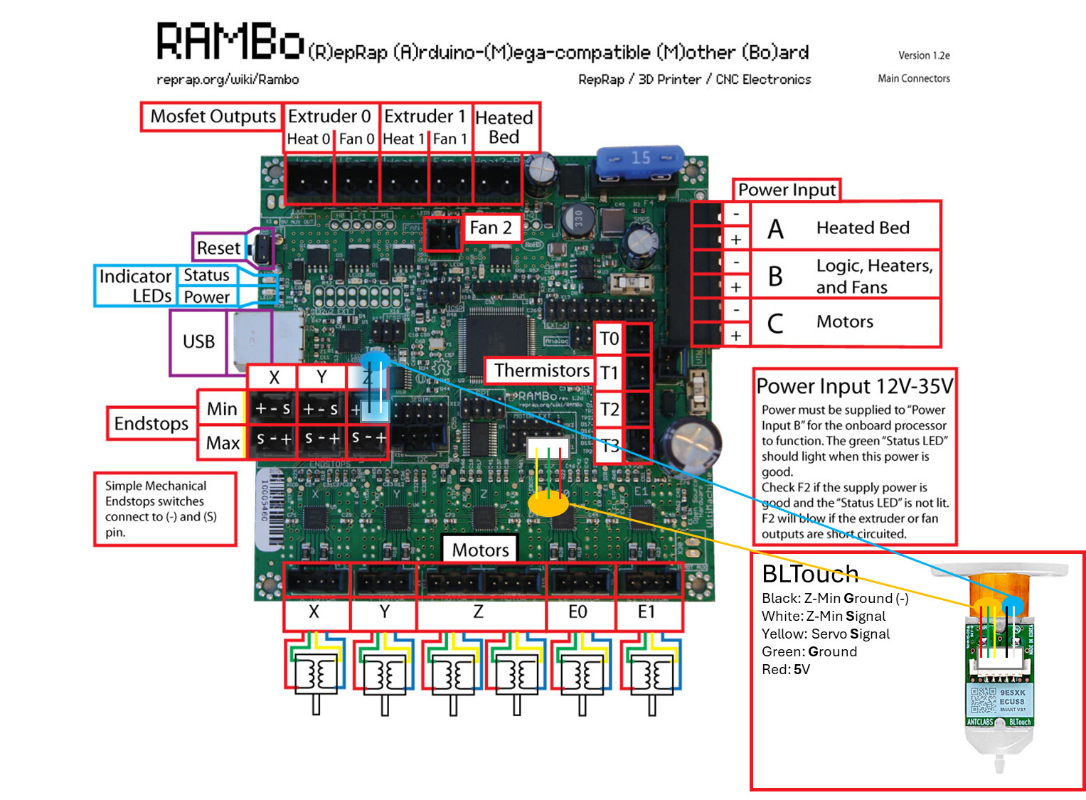

If you want to swap to BLTouch and keep the M175v2 on the Taz 6, I’ve got firmware and a modified shroud for doing just that. My Taz6 at home is heavily modified, but the one here at work is still Rambo + BLTouch + Magnetic print surface + M175v2.
**Post date:** [May 1, 2024, 6:31pm UTC](https://forum.lulzbot.com/t/m175-on-the-taz-6/26600/25 "2024-05-01T18:31:14Z")
Yeah I would be interested in that, teach us how that’s done!
**Post date:** [May 1, 2024, 7:34pm UTC](https://forum.lulzbot.com/t/m175-on-the-taz-6/26600/26 "2024-05-01T19:34:31Z")
Modified firmware: [Taz6-BLTouch-M175v2\_firmware.hex - Google Drive](https://drive.google.com/file/d/1rslMXeqvvNCmQKrvPQyFOocVoFnKIez6/view?usp=sharing)
The default offsets are set for the (preferred) front mount using my [modified M175v2 blower shroud](https://www.printables.com/model/508624-lulzbot-m175v2-bltouch-toolhead-adapters):
 ![image](https://us1.discourse-cdn.com/flex020/uploads/lulzbot/original/2X/7/77fbec783ead54ed0f1ff70d0845e92d5e067128.jpeg)
[https://www.printables.com/model/508624-lulzbot-m175v2-bltouch-toolhead-adapters](https://www.printables.com/model/508624-lulzbot-m175v2-bltouch-toolhead-adapters)

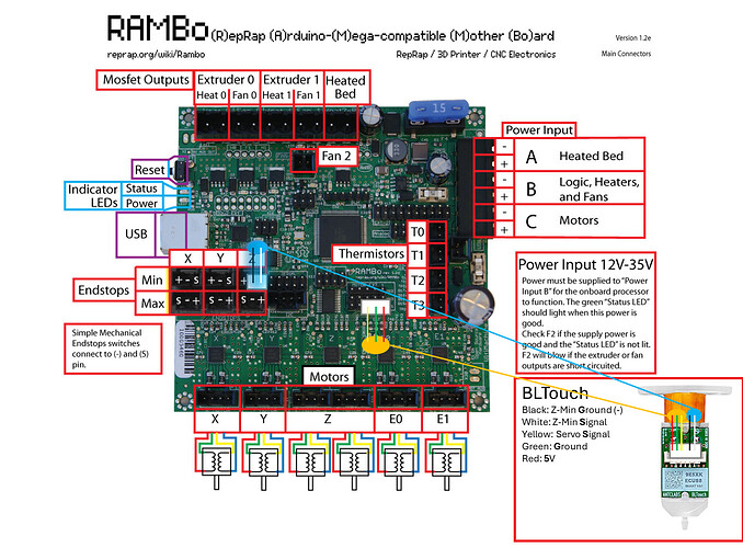

I use a BLTouch and an extended wiring kit, which connects to the board like this - wire colors may not match your extended wiring! Check your manual if you use a clone
 ![image](https://us1.discourse-cdn.com/flex020/uploads/lulzbot/original/2X/0/0dcff671df61701af302d77f09f00ccb67ee413b.jpeg)
**Post date:** [May 1, 2024, 7:56pm UTC](https://forum.lulzbot.com/t/m175-on-the-taz-6/26600/27 "2024-05-01T19:56:56Z")
Does this require a motherboard upgrade?
**Post date:** [May 1, 2024, 8:06pm UTC](https://forum.lulzbot.com/t/m175-on-the-taz-6/26600/28 "2024-05-01T20:06:05Z")
Nope. This is on the factory rambo board, as per the diagram.
