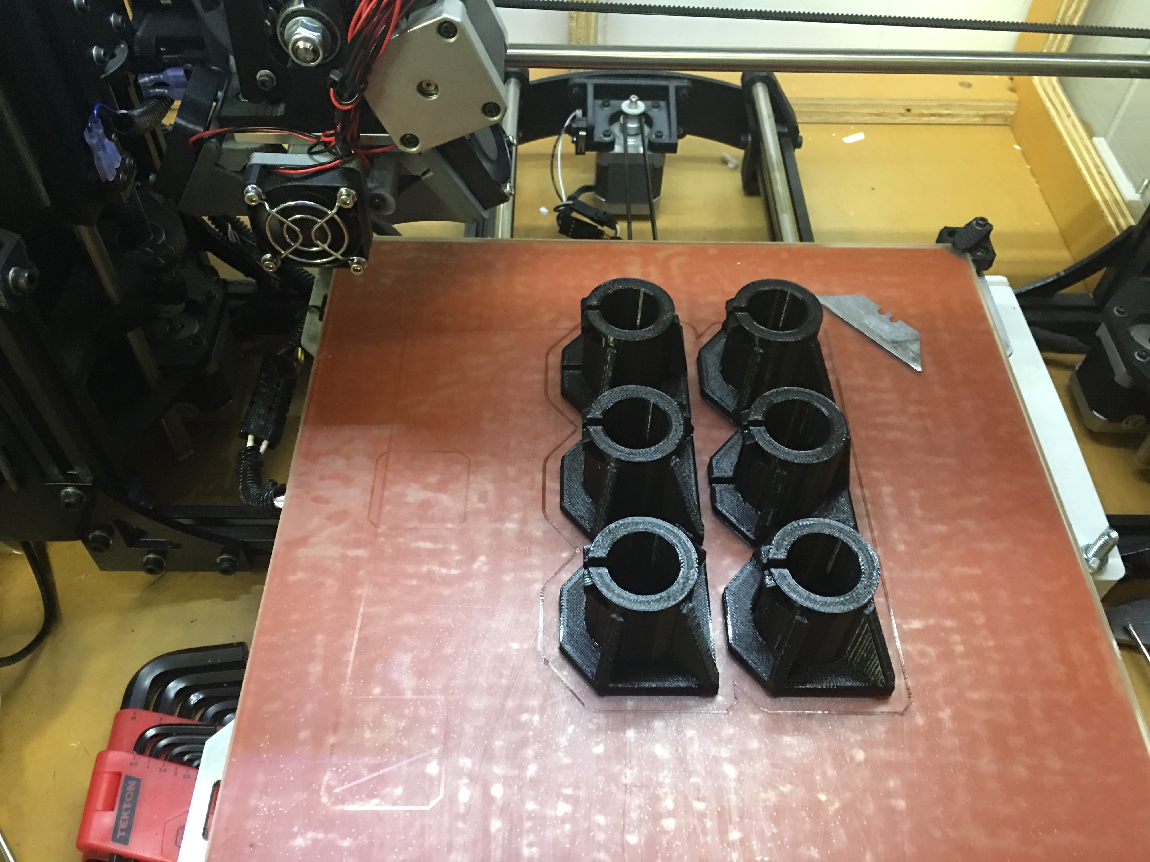

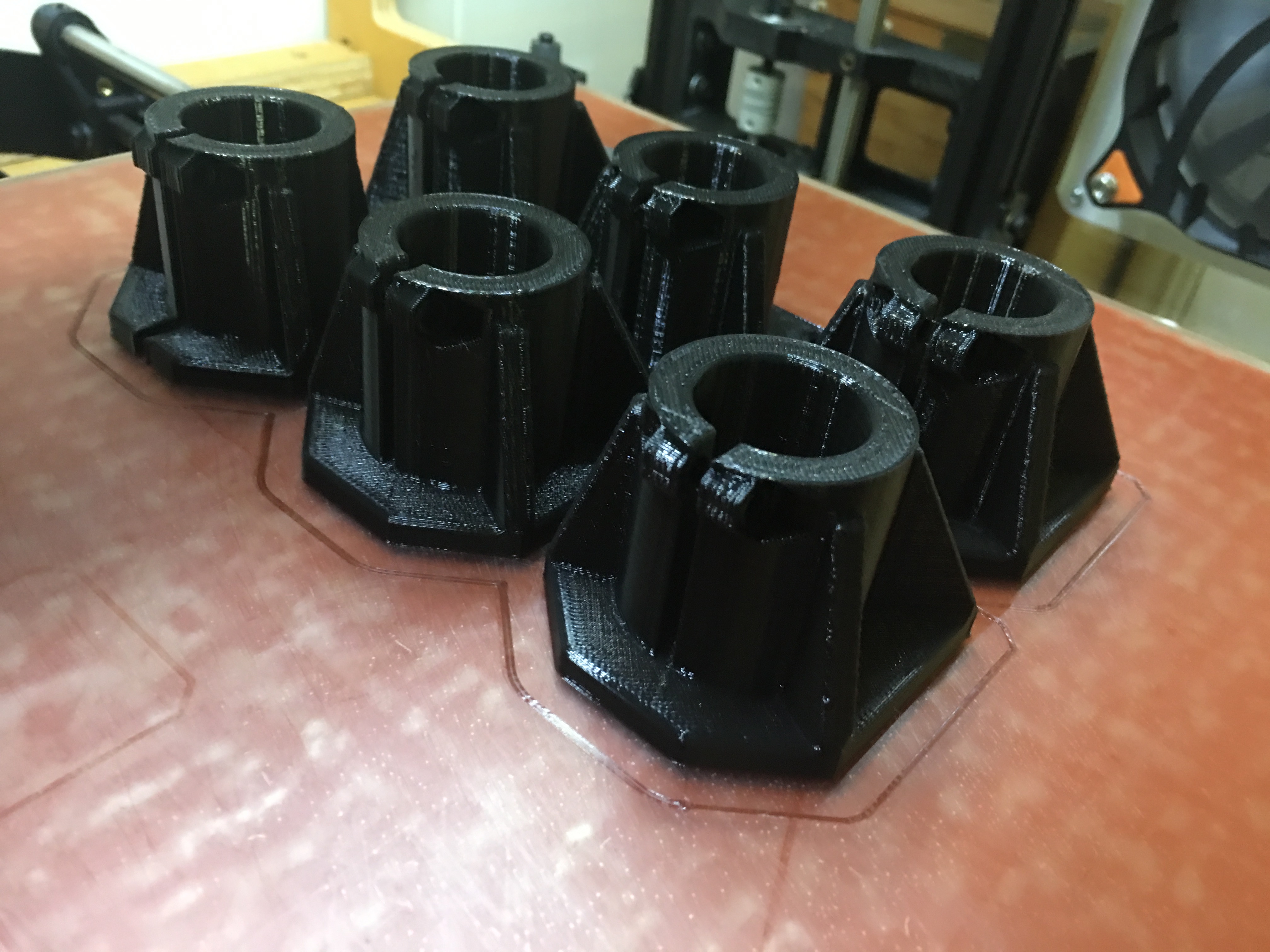

So, I am a bit of a bargain hunter, and had seen a few months back someone said MakerGeeks had good filament. So I went a little crazy on one of the filament grab bags, and then they also screwed up the order so I ended up with 10 rolls of MakerGeeks PLA! So I was very driven to get this working and failed miserably. I found this thread and it inspired me to try it again. I got it working! I’ve made a few benchies and an 11 hour print now with a few different colors of MakerGeeks. The changes I made to the basic PLA profile are: retraction set to 0.7 (instead of 1.7, this didn’t cause oozing), temperature set to 210C, and speed set to 48 mm/s, outline underspeed set to 80%. Everything else is set to 100% of the speed, even first layer. I’ve found the biggest thing with this filament is the speed. Go too slow, and you get heat creep; go to fast and it builds a lot of pressure and grinds out the filament. It also seems to compress the filament really bad, and makes it almost impossible to melt. I use S3D, so my FFF profile is attached (just change the extension from txt to fff). Sorry for the Cura people, but I think you’ll have luck making these changes in Cura. If someone tries, please post back for others!
By the way, I happened to also switch from a 0.35mm nozzle to 0.5mm nozzle during this. So I can also testify that it works for both nozzle sizes. I’m going to try to speed it up a little now with the 0.5mm nozzle, as I don’t think there will be as much back pressure.
Hopefully this helps some people out.

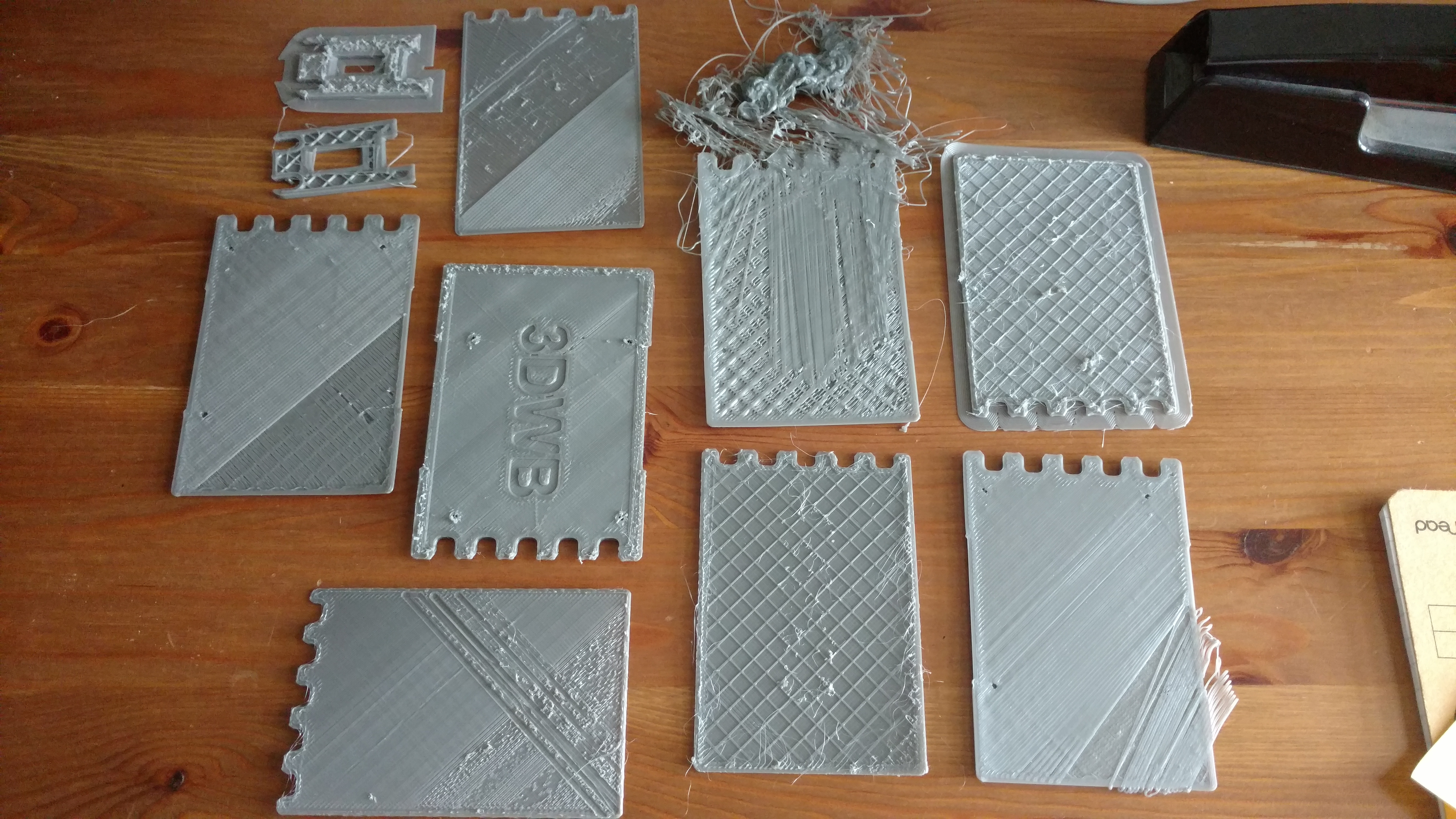

**Author:** ![njgsx96](https://avatars.discourse-cdn.com/v4/letter/n/3e96dc/32.png) [@njgsx96](https://forum.lulzbot.com/u/njgsx96)\
**Post date:** [August 20, 2016, 8:19pm UTC](https://forum.lulzbot.com/t/makergeeks-pla-filament/2455/31 "2016-08-20T20:19:58Z")
I was looking to try the Raptor PLA out and wish I saw this thread first. I have had nothing but bad luck printing with this stuff. It clogs an djams every time but 1 so far. the only success I had was a 15 minute print, which failed the first time I tried as well. I have tried various speeds, from 20mm/s up to 90mm/s. I have tried temps from 205 through 240 as we as bed temps of 60-80. Various retraction settings, various flow settings and speed settings and nothing makes a difference. I tried various idler tension, from 8mm down to 5mm spacing down to where it starts clicking it is so tight. Still nothing. The filament shreds, stops and clogs every time. And if that wasn’t enough, there is no bed adhesion without a brim and even then it pulls off very easily.
here is the filaments I have had to pull from the extruder.
 ![raptor filament.jpg](https://us1.discourse-cdn.com/flex020/uploads/lulzbot/original/2X/9/988cd7da2bb7d20b53d6752823de94ba119cdd70.jpeg)
Here are my prints.
 ![raptor prints.jpg](https://us1.discourse-cdn.com/flex020/uploads/lulzbot/original/2X/e/e2445e14083b1b9c99423593df686c4a77f04911.jpeg)
So far, I have had no issues printing with Taulmann PET, eSun PLA+, nGen, and Ninjaflex. I had real high hopes for the Raptor line but I just don’t think the TAZ 6 likes it. I wish it was me but I have tried everything and cannot seem to get it to print at all. Put back my PLA+ and printed off a couple flawless prints. I will stick with the PLA+ then and maybe try my hand at some ABS or ABS+. makergeeks is just not for me or my TAZ.

Unfortunately still no luck with your settings. I thought I had something when I changed a few other settings. Almost got a full print until it came off the bed. Added a larger brim and went again but it stopped extruding and got chewed up on the next 2 attempts. So back to the drawing board. I will still keep plugging away since I cannot return it (don’t need a store credit for a place whose filament does not print for me).
**Author:** ![DougZ](https://sea2.discourse-cdn.com/flex020/user_avatar/forum.lulzbot.com/dougz/32/99_2.png) [@DougZ](https://forum.lulzbot.com/u/DougZ)\
**Post date:** [August 28, 2016, 10:45am UTC](https://forum.lulzbot.com/t/makergeeks-pla-filament/2455/38 "2016-08-28T10:45:38Z")
That’s too bad. Sorry I couldn’t help. If they’d give you credit why not try a different spool? Maybe the natural like I had? Very pleased with the resulting product and finish (but I was specifically looking for the resulting natural color). Just thinking you may have gotten a bad spool. Good luck!
