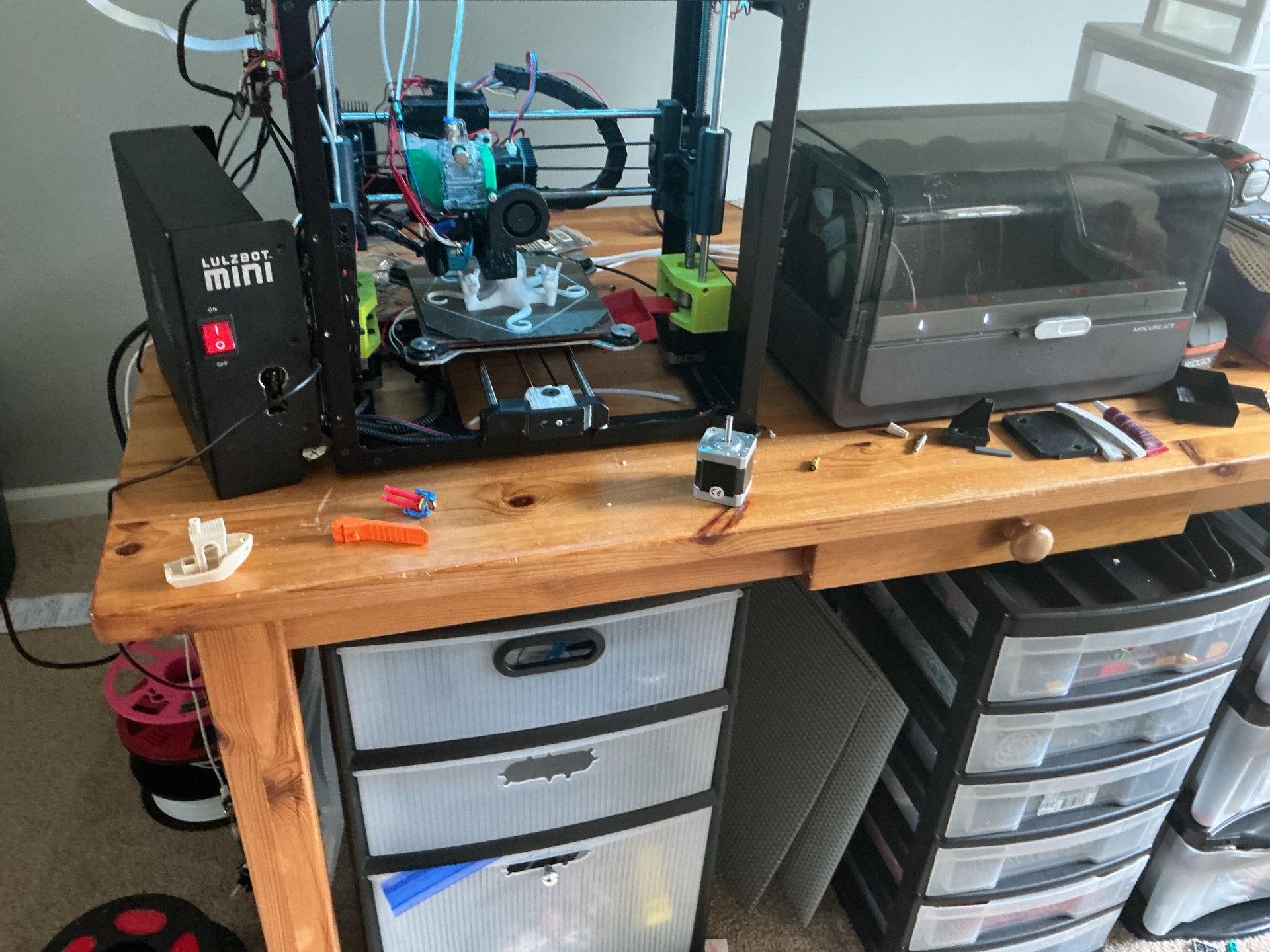

This is my mini 1 I got broken last year for 50 dollars with a dead mainboard. So I proceeded to swap it for skr mini e3 v3 and a Btt pi with Klipper. Then the tool head died so I made a clone of a M175 V2 with a mellow crazy uhf volcano and bmg clone. I also added an ace pro for PLA supports with PETG
