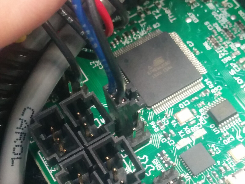

**Post date:** [July 1, 2024, 11:58pm UTC](https://forum.lulzbot.com/t/mini-1-wont-even-attempt-to-probe/26787/8 "2024-07-01T23:58:27Z")
I unscrewed the red wire at the bottom of the hotend and my printer still says zmin and max are triggered… I’m not sure how that’s even possible ☹
Is this blue and black cable the z min stop? I guess I’ve had to replace the ground wire that goes TO the bed, but not this blue and black one on the six pin jumper above the zmax connector:
 ![](https://us1.discourse-cdn.com/flex020/uploads/lulzbot/original/2X/9/9b2af463ff6c8d734526e9b617c6ece6ce69876d.jpeg)
So in this pic from the lulzbot guide - this six pack of jumpers is the z-min. The port right beneath it in the pic is the z-max, but then the one below that is also labeled z-min - that’s the one that grounds to the bed and I’ve replaced.
I’m guessing the bed must be shorted rather than the hotend - since disconnecting the hotend still shows triggered for z\_min and disconnecting all three of the z-min/max connectors still shows z\_min triggered but z\_max is open now. I’m guessing the bed is grounded by some rogue power issue from a different cracked cable ☹
Maybe? Thoughts?

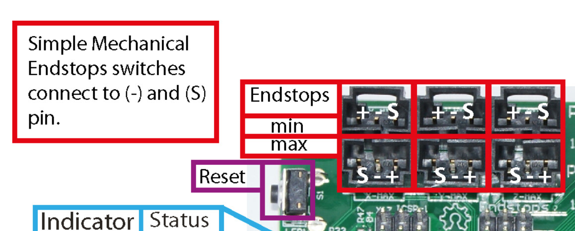

**Post date:** [July 2, 2024, 2:23pm UTC](https://forum.lulzbot.com/t/mini-1-wont-even-attempt-to-probe/26787/14 "2024-07-02T14:23:28Z")
The mini uses a mini-rambo.
@gleep52 That picture is wrong. The ZMIN isn’t on that header. The MAX/MIN are the ones with black connectors:
 ![image](https://us1.discourse-cdn.com/flex020/uploads/lulzbot/original/2X/a/abeec1350e5e23f38b505177ed7f36f79f7568bd.jpeg)
Zoom in from [MiniRambo - RepRap](https://reprap.org/wiki/MiniRambo)
 ![image](https://us1.discourse-cdn.com/flex020/uploads/lulzbot/original/2X/3/39d1f40991ceb4ababaced106d41aa193d255e78.jpeg)
Enhance:
 ![image](https://us1.discourse-cdn.com/flex020/uploads/lulzbot/original/2X/4/4ec0781af402ad3d1da4494f97416f95cd078560.jpeg)
That connector from the OHAI you posted is the ICSP, which is used to [program the bootloader](https://reprap.org/wiki/Rambo_development).
 ![image](https://us1.discourse-cdn.com/flex020/uploads/lulzbot/original/2X/5/571501f3aa54da27b1a86d443390a6ac49d31b18.jpeg)
Which pins out like this ([https://reprap.org/mediawiki/images/e/ef/MiniRambo1.3a-schematic-pg2.svg](https://reprap.org/mediawiki/images/e/ef/MiniRambo1.3a-schematic-pg2.svg))
 ![image](https://us1.discourse-cdn.com/flex020/uploads/lulzbot/original/2X/5/5f8ed62f4a11276c02a832db94e1393a2f45b2b1.png)
This photo also from the same OHAI shows the ZMAX and ZMIN correctly connected:
 ![image](https://us1.discourse-cdn.com/flex020/uploads/lulzbot/original/2X/6/6b1a777fafc0e312197287bb11cc73c7035d9245.jpeg)
The ZMIN is covered earlier:
 ![image](https://us1.discourse-cdn.com/flex020/uploads/lulzbot/original/2X/7/746e0794f3a611d20718d9867e4736b2cd21135e.jpeg)
I honestly have no clue what that image you posted is doing in the instructions. It makes no sense.
 ![image](https://us1.discourse-cdn.com/flex020/uploads/lulzbot/original/2X/e/e4178c386f03d2de8b709ea399106512b05c448c.jpeg)
Rewire correctly and hopefully it’ll be working.
**Author:** ![gleep52](https://sea2.discourse-cdn.com/flex020/user_avatar/forum.lulzbot.com/gleep52/32/10814_2.png) [@gleep52](https://forum.lulzbot.com/u/gleep52)\
**Post date:** [July 3, 2024, 4:46am UTC](https://forum.lulzbot.com/t/mini-1-wont-even-attempt-to-probe/26787/15 "2024-07-03T04:46:43Z")
I honestly do not know what the black and blue cable is going to the 6 pin connector - have not traced the wires, but they appear to go to the nozzle group of cords, not the bed at all.
I was using a wire brush and it didn’t work thereafter, so I’m presuming (since the fuses are fine) that I shorted out the board, which is why z\_min is always triggered, even with cables completely disconnected.
Appreciate the feedback, but my wires are identical to the zmin and max pics with the red on the right in the max and left on the min connectors (Signal and ground, not positive).
