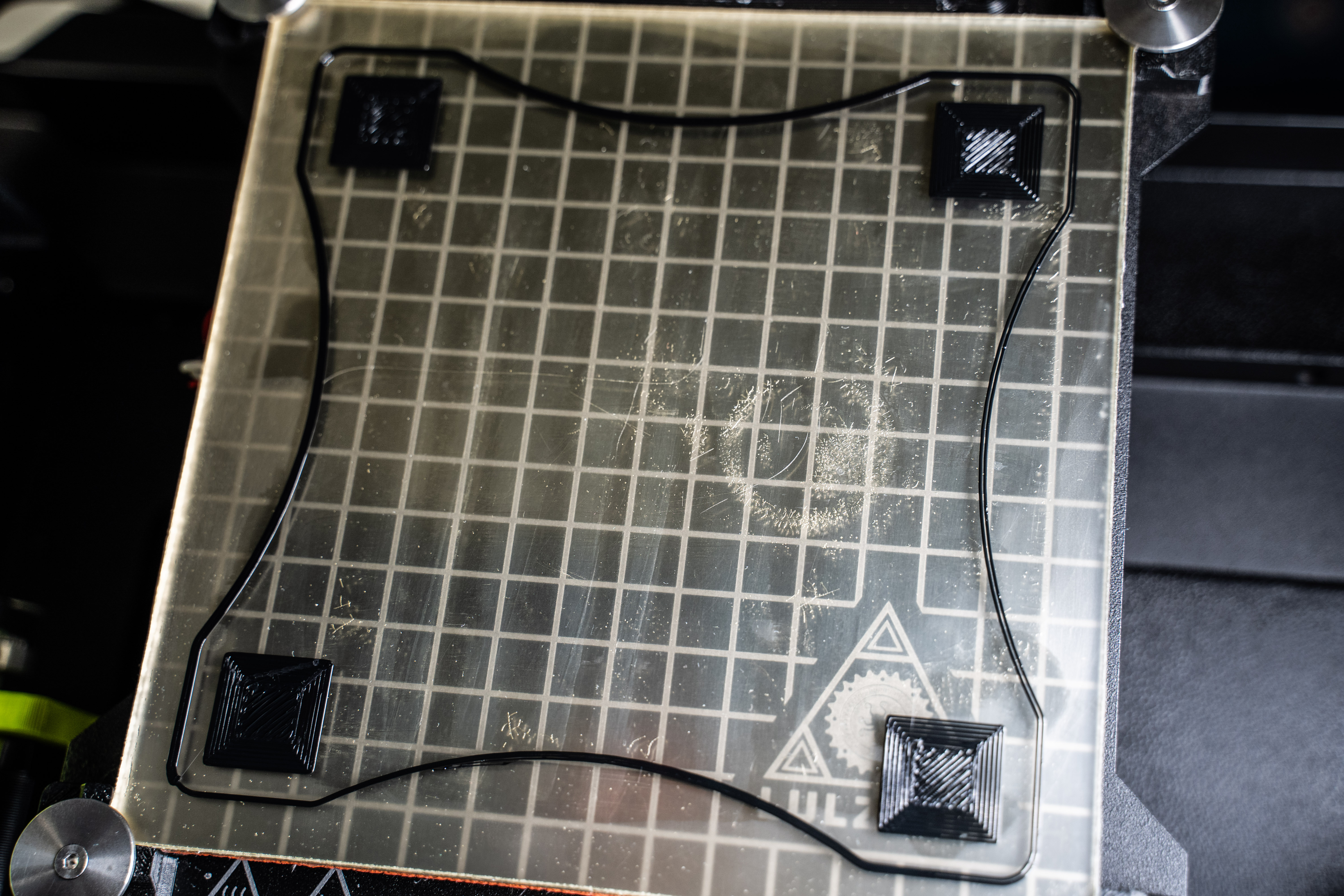

I know this is an old thread but I’ve been having the exact same issue.
I’m a newbie so I didn’t know what was happening with my prints - with Alloy 910 and PC-MAX I was getting lifted corners, but mostly on the right side of the bed.
I’ve re-seated and cleaned the bed and washers, been cleaning my nozzle and watching the levelling process, I’ve also tightened the belts up and checked the surface with a straight edge (it’s ok, no rocking of a ruler) but still getting the same results:
 ![Lm2BLP - 0001.jpg](https://us1.discourse-cdn.com/flex020/uploads/lulzbot/original/2X/e/e618fa0fededa8b10e7e7ec09f93ffdf0ba24338.jpeg)
Skirt on left side is nice and smooshed together but on the right side there is a gap in the skirt lines, not to mention the same on the actual first layer.
From the last post it seems like this is a design issue and nothing that can be done except to offset the z-axis even more, so one side is super smooshed to compensate for the other.
Has there been any update to this issue?
Other than that the printer seems to be working fine, and PLA sticks well. But I’m trying to print functional parts with PC and Nylon and this is kinda screwing up my prints and eating $$$ in filament.
Is there anything else I can do to “fix” this issue? Machine (1.1.9.34) and CURA (3.6.3) updated to latest
Perhaps in a future firmware there can be a tweak to adjust the left and right z offset so one side can be lower than the other to compensate for this?
Printer does this consistently so if there was a way to adjust how it prints the first layer left vs right that would probably fix it?
Thank you for any help.

I am getting this same issue with the smooshed left side and the right side being too high from the plate. Did anyone ever find a solution to this? Technical support has been little to no help with the issue and thus far I truly regret purchasing this machine.

A stupid hack I did that made it “better” but not eliminate the problem was to simply shim the other 3 corners and keep printing the corner tests until it improved.
Since the right side is “too high”, you can “lower” the bed by shimming the corners at the spot under the washer and the bed (you want to introduce some space between the washer and the bed only, NOT the washer and the black plastic mount it is screwed into (I mean I guess you can if you can find a way to do this evenly, but I didn’t).
What I did was simply put a small piece of paper between the shim and the bed/print surface for the 3 better corners (I used post it notes). No paper under the worst corner. Then I printed the test. Checked the results. If no improvement, shim some more (I just folded the piece of paper over). Repeat until it looks “better”. Obviously each corner can have different thicknesses of shims.
Once I got a good result I trimmed the paper as small as I could to not interfere with printing.
Stupid solution but helped for me, I’m not a pro so I don’t know if this screwed anything else up but it “makes sense” to me, you’re introducing more space in the other 3 corners to compensate for the “bad” corner not being “close enough” since you can’t make any software adjustments, and since you can’t raise the bad corner you have to lower the other 3 corners.
Basically you want each corner to look relatively even (obviously). Then readjust the Z offset value for a nice first layer.

My mini 2 is operating too close to the edge of its design envelope. Other’s machines have no issues. Probably most of them. But enough do that you can see the pattern in recurring first layer issues. I’m still surprised that there is no update to the mini2 addressing these issues, similar to the multiple 1.0…1.4 improvements to the original mini.
Rant aside, one thing to note is that the bed tilt compensation in marlin can only do so much. The disparities between corners should be in the same ballpark (~0.5mm ims). It can compensate for a slightly out of plane bed, but not if your x axis is also out of plane. So shimming corners can help a ton with level prints, provided that shimming is done relative to a well-trammed x axis. [This thread](https://forum.lulzbot.com/t/solved-taz-6-auto-leveling-is-0-5mm-off-now-perfect-to-0-01mm/6250/19) is hugely valuable for build plate shimming.
I now run klipper as opposed to stock firmware, and have tuned motion to try and compensate for the physical issues. Even little things, like having the head park on the right, have helped immensely with z consistency, along with fine-tuning x axis leveling routines. At some point I may either replace the z steppers with geared versions (which lulzbot did with the workhorse) or upgrade to closed-loop steppers, either of which should help address the problem. For now a _lot_ of tuning has largely ameliorated issues for me.
**Author:** ![joshea](https://sea2.discourse-cdn.com/flex020/user_avatar/forum.lulzbot.com/joshea/32/10277_2.png) [@joshea](https://forum.lulzbot.com/u/joshea)\
**Post date:** [April 19, 2021, 2:52am UTC](https://forum.lulzbot.com/t/mini-2-z-height-issue-with-varying-xy-for-new-machine/6046/20 "2021-04-19T02:52:06Z")
Has this ever been resolved? I upgrade my Mini to a Mini 2, was doing some tests today with the SL and found it right away. I am running CURA 3.6.20 for the record.
This is rather frustrating, to be honest, I wish they would go back to the old auto-leveling that didn’t do this double tap, since, the old one I had the most beautiful z-offset (on my Taz 6 I should point out), perfect smooshing. Then the update and it’s never been the same. It varies WAY too much.
To be honest I am half tempted to see if I can rewrite this part of the firmware I swear.
