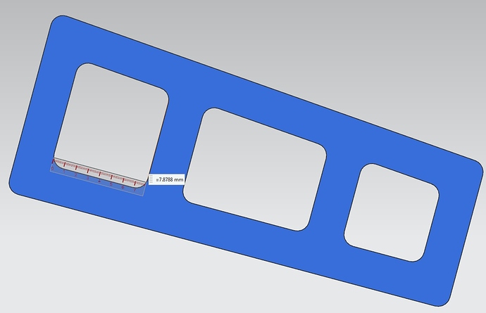

Hey guys,
Just got my MINI yesterday and I’m having a blast with it. I’d just like to confirm my results with what I should expect.
I’m going to be using the mini to create a lot of cases for arduino based stuff. Those boards use M3 screws to hold the board to the case. The engineers handbook recommends that for an M3 screw, the thru hole should be 2.5mm before tapping. To test accuracy, I had the mini make a boss with a 2.5mm ID. Once printed, I used gauge pins to measure the results. The ID/hole diameter of the part came in at 1.4mm.
Thinking it might just be small dimensions that are difficult, I printed another bearing I had which has an ID of 4.1mm. When I measured it with a gauge pin, the resulting part came in at 3.24mm. Working with SLA machines, I know that holes will come in a bit tight, but I wanted to see if I should expect more/less out of the machine for these types of details.
As for the run mode I’m using HIPS, Cura quickprint, FINE detail. See the results below:
 ![ScreenHunter_462 Mar. 19 10.16.jpg](https://us1.discourse-cdn.com/flex020/uploads/lulzbot/original/2X/4/43b6e0ef3033ac146b5b41b0573b954956565d84.jpeg)
Should my ID’s be closer to my solid dimensions or am I getting expected results for this machine? Should I be using the HIPS profiles you guys provide for expert mode? Should I be buying a smaller nozzle diameter?
Thanks guys!
-Jim

One other sample part:
 ![ScreenHunter_463 Mar. 19 10.42.jpg](https://us1.discourse-cdn.com/flex020/uploads/lulzbot/original/2X/6/65f9e169cfe87b286b46e8512740d2749c18a322.jpeg)
Solid on the computer says the distance should be 7.88mm. Printed part came in at 7.43mm.
Same settings as I listed above.
Is my machine operating as expected? 🙂
-Jim

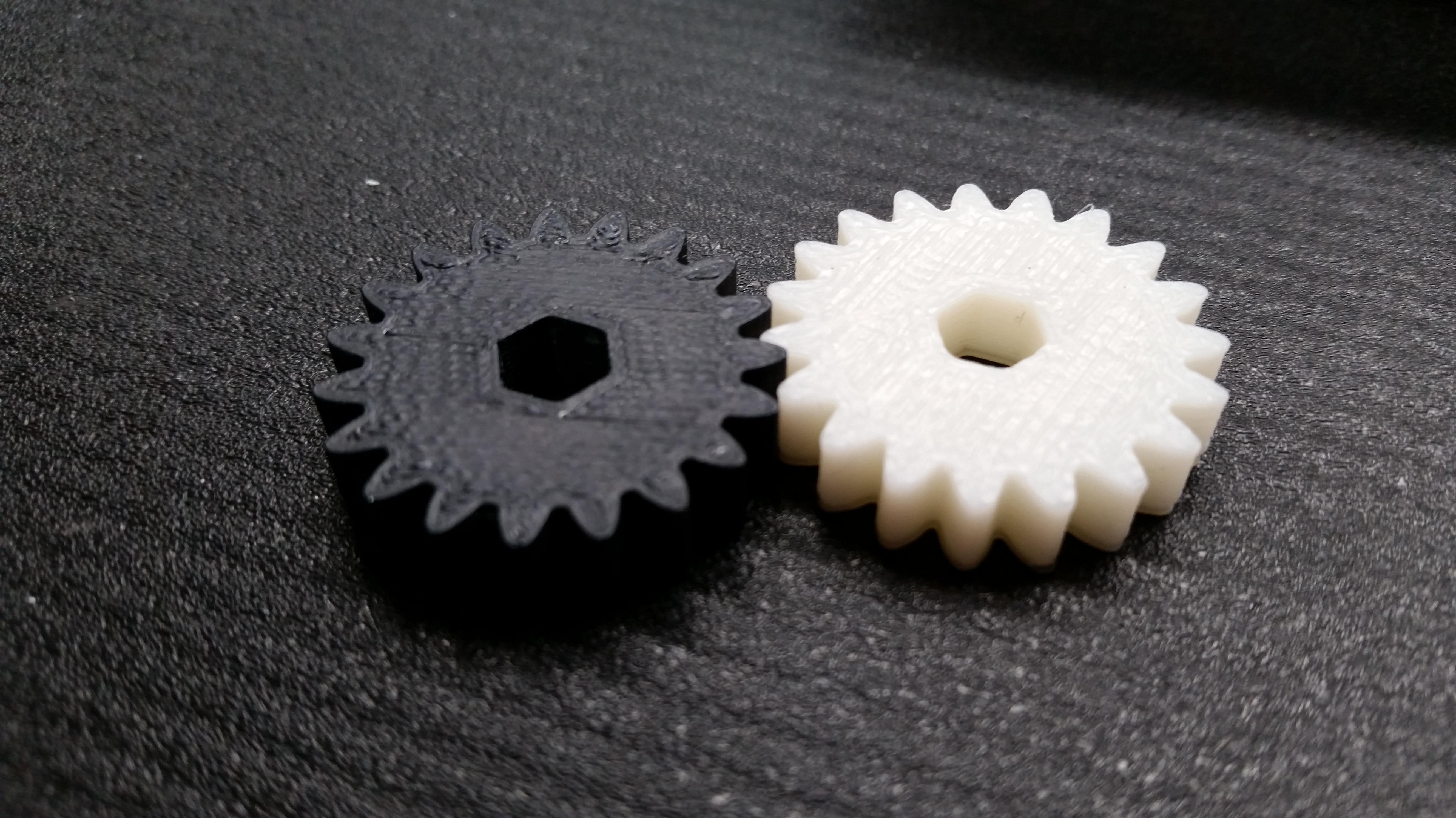

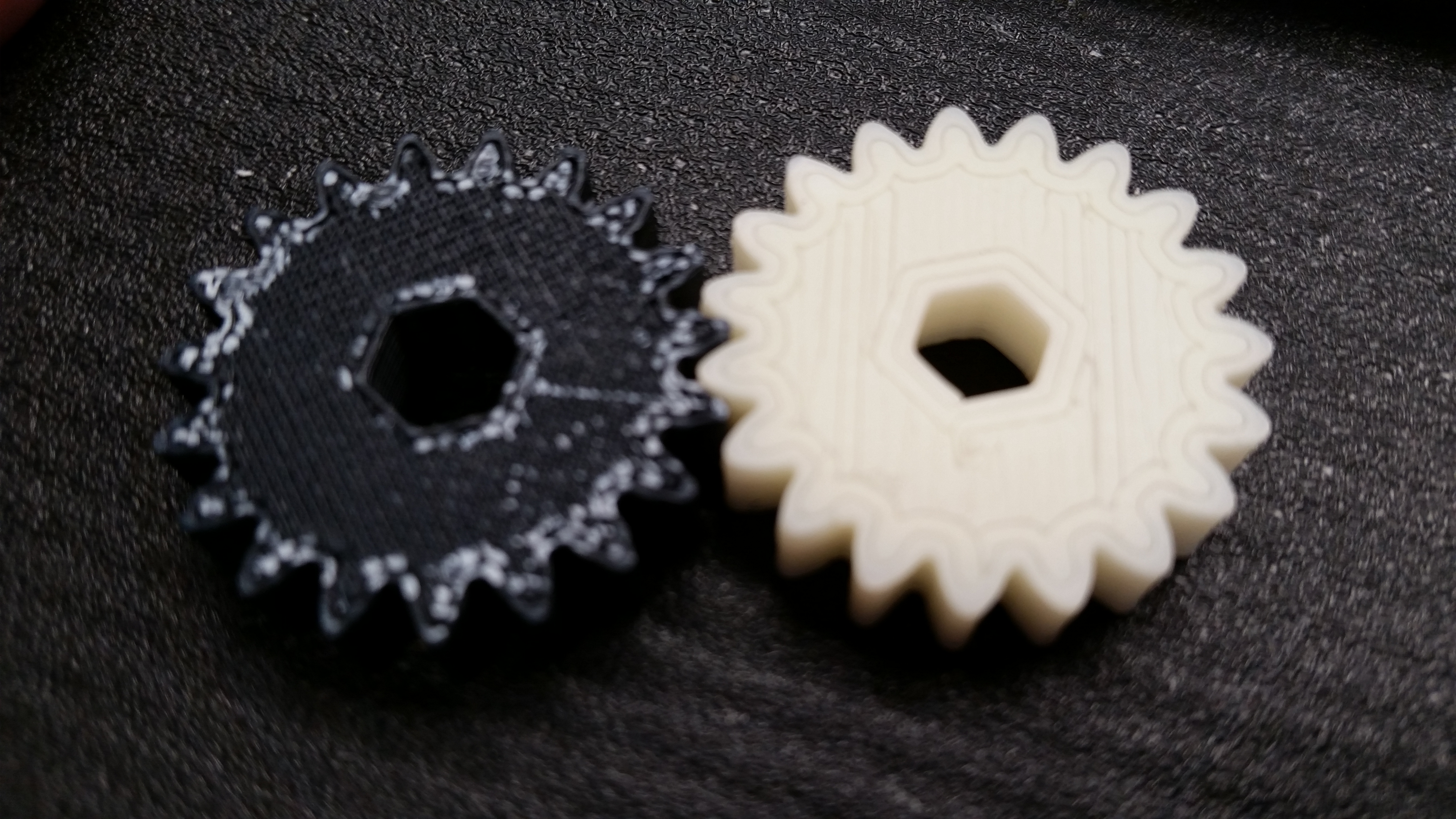

I’m not knowledgeable enough to give advice…
But a good test would be to render a small ring… and test it…
I’ve beat on this machine, and it’s “OK” from my experience… But it does drift a bit in my experiences… Like I said, making good circles seems to be hard to do…
I will find out how E-Sun filament works out, as it’s the only filament that they fully support, and I was lucky enough to find some in stock…
Otherwise, these are printed from the same STL on two different machines(Zortrax/LB Mini)… Default/similar profiles… Black is Zortrax and white is LB…
Funny, that the internal hex ID size was right on between both machines, but the OD and thickness was off…

You might look at this:
[http://hydraraptor.blogspot.com/2011/02/polyholes.html](http://hydraraptor.blogspot.com/2011/02/polyholes.html)

**Post date:** [March 20, 2015, 7:14pm UTC](https://forum.lulzbot.com/t/mini-bearing-pocket-ids/1501/8 "2015-03-20T19:14:09Z")
One of the first things you should check is your filament diameter. In the default Cura profile this is typically set at 2.85mm. On our mini we were having tolerance issues – but these were quickly resolved by adjusting the filament diameter (for us, we’re up around 3.07 mm with Lulzbot PLA eSun).
You’ll have trouble making this configuration via the quickprint settings. So, you’ll need to switch over to expert (please correct me someone if I am wrong) and load the desired PLA profile manually. Then - make the correction in the expert settings.
