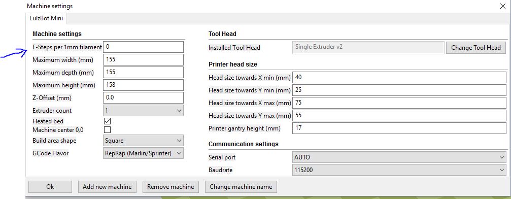

Is this where I would need to make the setting adjustment?
 ![Capture.JPG](https://us1.discourse-cdn.com/flex020/uploads/lulzbot/original/2X/1/17fd19fa29b0c4c4db4c7ebe83c13448b8647f74.jpeg)
It states that “0” means it refers to the profile, based on what you have shared I should adjust it to the sheet that I received with the unit (in my case it shows 833
**Post date:** [January 19, 2017, 5:12pm UTC](https://forum.lulzbot.com/t/mini-firmware-update-confusion/4470/4 "2017-01-19T17:12:42Z")
833 is the firmware default. Entering it (or not entering it) in Cura will have no effect.
Most people find 833 to be a little high. You may want to do your own calibration. If you do, I recommend just setting the new value using the M92 command rather than entering it via Cura.

You must load a model in Cura and hit the “Control” button to get the Printer interface – because that’s where you can enter commands at the bottom-right, below the terminal window. Start by entering M501, which will show you the current settings – review to find the M92 line, and it should currently include E833.00 (the default value).
If your calibration gives you another number, lets say 815 for example, then enter “M92 E815” and hit enter. You can send M501 again to make sure it was accepted, then M500 to store the value. (If you don’t do the M500, it will revert to default the next time the printer resets.)
