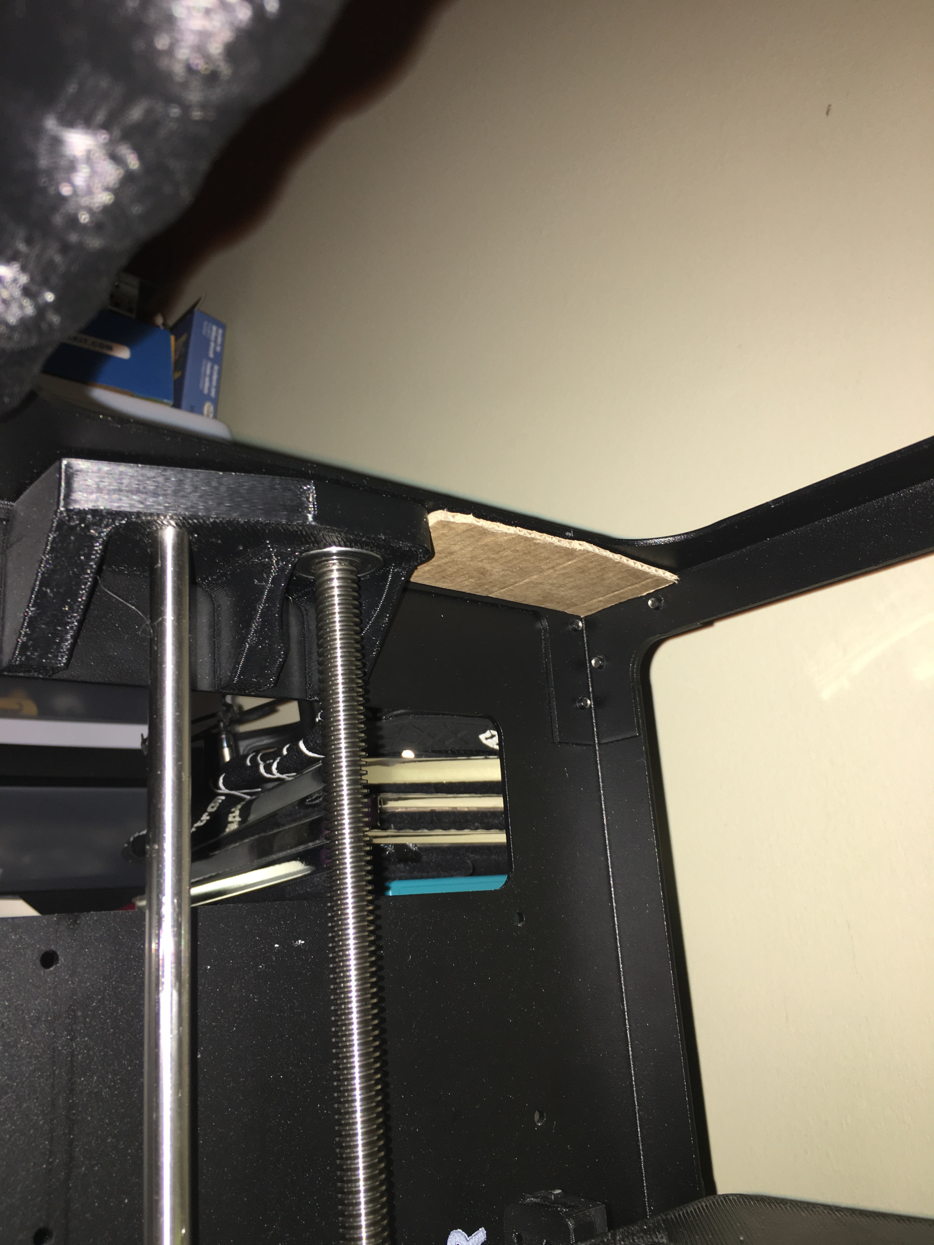

**Author:** ![bal323](https://avatars.discourse-cdn.com/v4/letter/b/77aa72/32.png) [@bal323](https://forum.lulzbot.com/u/bal323)\
**Post date:** [March 6, 2018, 6:47am UTC](https://forum.lulzbot.com/t/mini-not-wiping-properly-hovers-about-1-cm-above-pad-and-does-wiping/5685/7 "2018-03-06T06:47:18Z")
A small piece of cardboard working excellent (for now).
 ![IMG_3727.JPG](https://us1.discourse-cdn.com/flex020/uploads/lulzbot/original/2X/4/47952eeeca096da9ddde970a8283b92ffb80dc1b.jpeg)
(just realized this images is rotated).
**Author:** ![Shawn](https://avatars.discourse-cdn.com/v4/letter/s/f6c823/32.png) [@Shawn](https://forum.lulzbot.com/u/Shawn)\
**Post date:** [July 18, 2019, 3:20am UTC](https://forum.lulzbot.com/t/mini-not-wiping-properly-hovers-about-1-cm-above-pad-and-does-wiping/5685/8 "2019-07-18T03:20:50Z")
I made an account just to say thank you. The option 2 solution proposed by ScottW above fixed this issue for me.
I cut a slim piece of cardboard to fix just as bal323 showed in their picture, slid it in, and all is well again. The shim is about 3mm thick which is actually probably .5-1mm too thick because the head now pushes a little too far into the wiper pad but at least the auto leveling probe succeeds every time. I think I might have to calibrate my Z offset though because that got wiped during the firmware flash. Oops.
