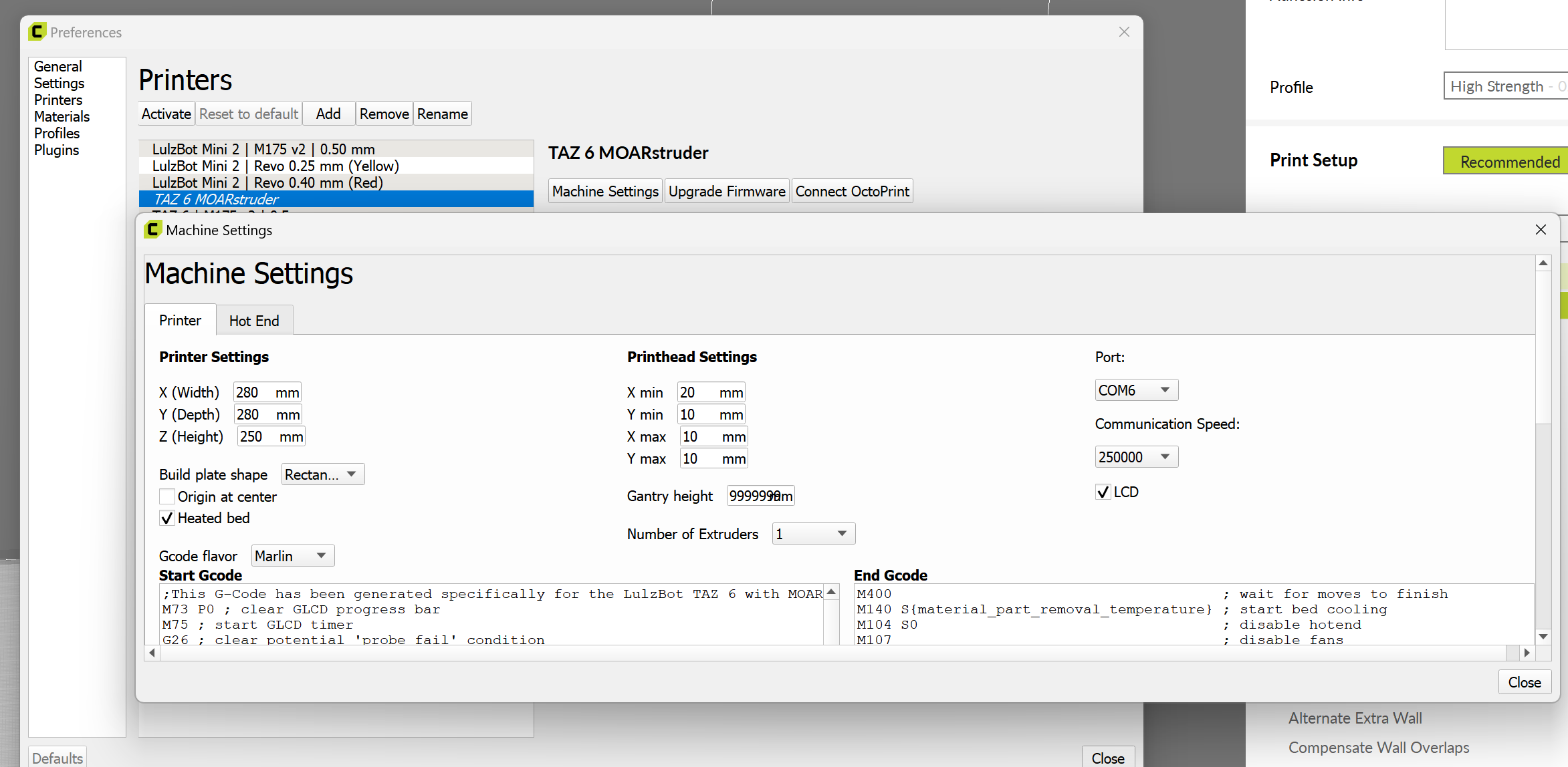

**Post date:** [May 18, 2023, 2:18pm UTC](https://forum.lulzbot.com/t/mini2-usb-not-detecting/25683/4 "2023-05-18T14:18:54Z")
I’m not on Linux, but in windows, it’s in the machine settings. In Windows, the machine settings dialog isn’t wide enough to show it when it opens, so you have to resize:
 ![image](https://us1.discourse-cdn.com/flex020/uploads/lulzbot/original/2X/4/4e51a9215d87774a26c629238e21ed131dba3090.png)

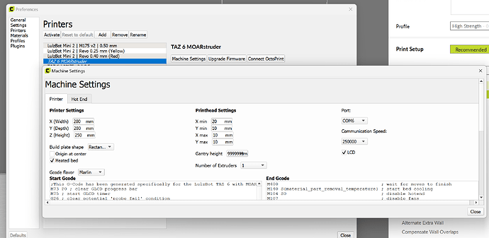

![cura_shot](https://us1.discourse-cdn.com/flex020/uploads/lulzbot/original/2X/0/03b02a607a791e85565cbeddb75dbc4432b1b15b.png)
It’s not an option under Linux… I do have the device port, but I’ve no way to confirm where Cura LE is looking - and I did resize the window just in case. Nothing to see, I’m afraid.
**Post date:** [May 18, 2023, 4:01pm UTC](https://forum.lulzbot.com/t/mini2-usb-not-detecting/25683/6 "2023-05-18T16:01:27Z")
Looks like you’re on the 4.13 beta. There’s no option for COM port assignment in that version in Windows either. It’s an issue that has been brought up and is reported to be included in the release version ([📢 Cura LulzBot Edition 4.13 Beta Testing! - #4 by LulzMeister](https://forum.lulzbot.com/t/cura-lulzbot-edition-4-13-beta-testing/25086/4)).
Go back to version 3, manually assign and give it a try.
**Post date:** [May 18, 2023, 5:32pm UTC](https://forum.lulzbot.com/t/mini2-usb-not-detecting/25683/7 "2023-05-18T17:32:49Z")
The BETA version does not allow connections to printers at this time.
You can still use it to slice and save to the SD card for the Mini 2, but printing through USB does not function.
**Author:** ![joel\_graff](https://sea2.discourse-cdn.com/flex020/user_avatar/forum.lulzbot.com/joel_graff/32/10792_2.png) [@joel\_graff](https://forum.lulzbot.com/u/joel_graff)\
**Post date:** [May 18, 2023, 6:47pm UTC](https://forum.lulzbot.com/t/mini2-usb-not-detecting/25683/8 "2023-05-18T18:47:01Z")
Version 3 works fine. Thanks.
