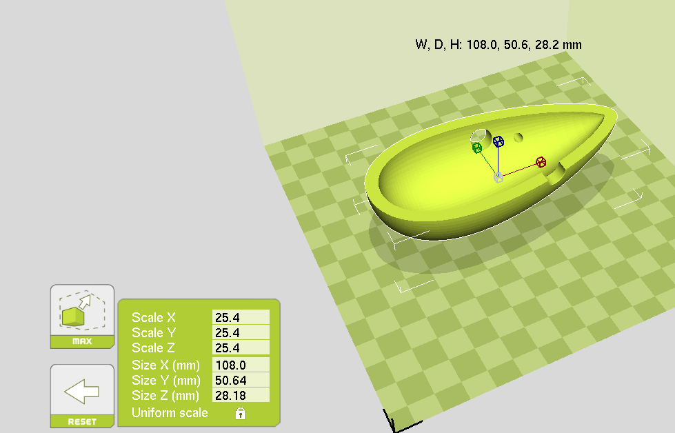

This is the first part of the Ocarina model. Be sure to use support with this. This part will take about one hour and forty-five minutes to complete on high speed. Please note that the original model is in inches. When you load the model into Cura it reads the model in millimeters. Instead of the model being 4.2 inches long it reads as 4.2 millimeters long. To fix this simply click on the model, select scale in the lower left, ensure that uniform scaling has been selected, it defaults to this. With uniform scaling on change the scale X from 1 to 25.4. This will scale everything up to the proper dimensions.
